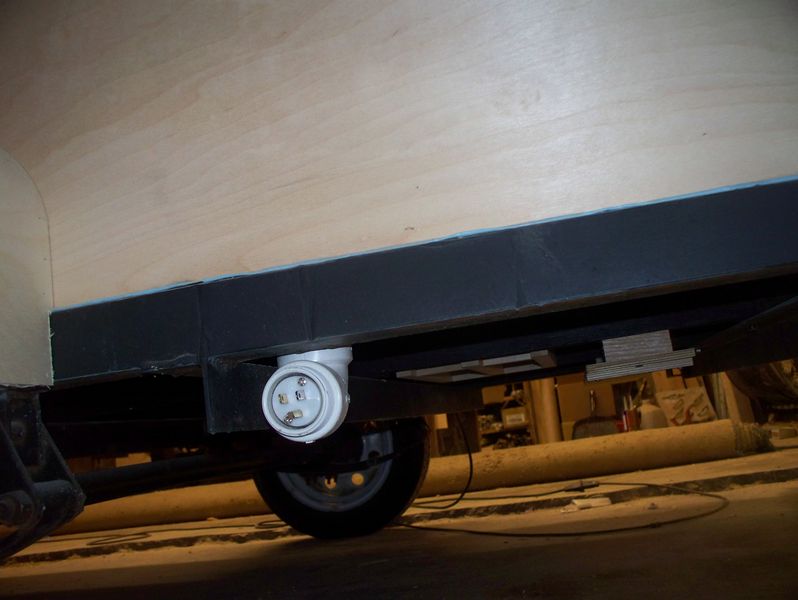

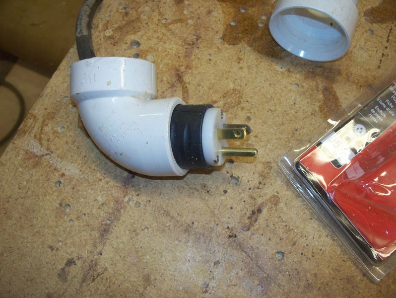

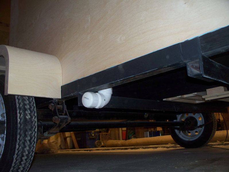

The 110 V. Electrical receptacle I came up with using some PVC...

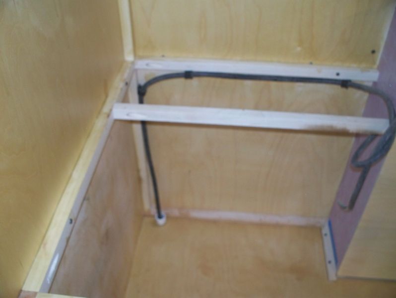

Postby oakinteriors1 » Sat Dec 14, 2013 6:19 pm

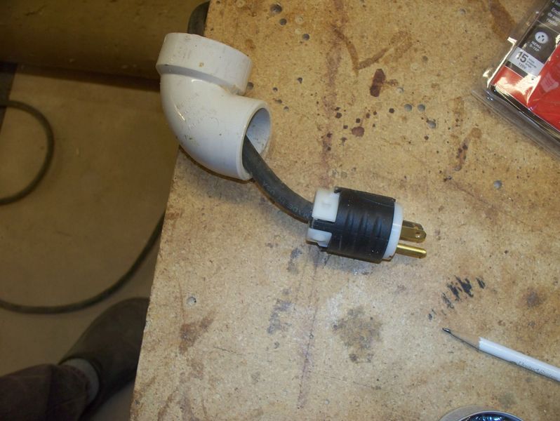

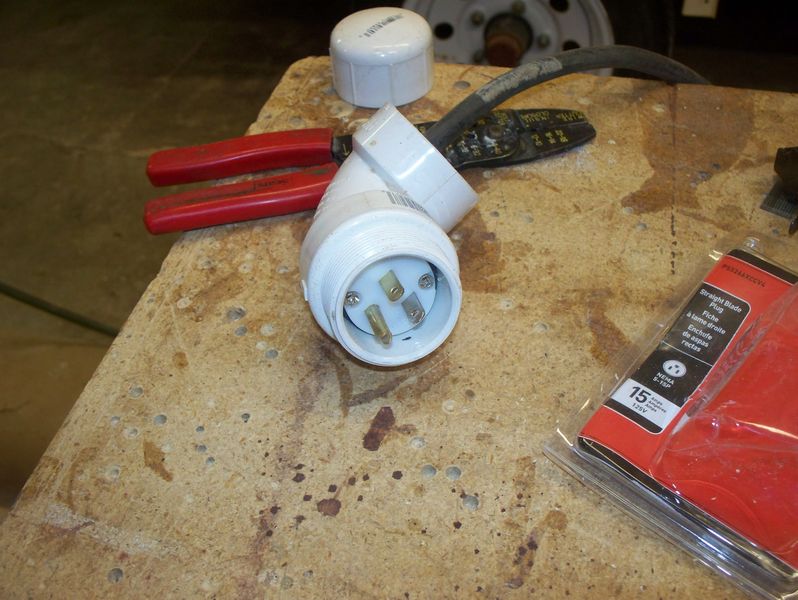

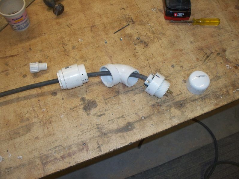

Your power port is fabulous!
How did you seal the cord cap plug end into the PVC fitting?
Re: Woody 5X10
Postby oakinteriors1 » Sun Dec 15, 2013 6:57 am
Stuff like this is fun to do just improvising as you go, ...
The plug needed very little sanding to press fit into the 90...and a couple of the fittings are held together with screws so I can take the assembly apart if necessary .....

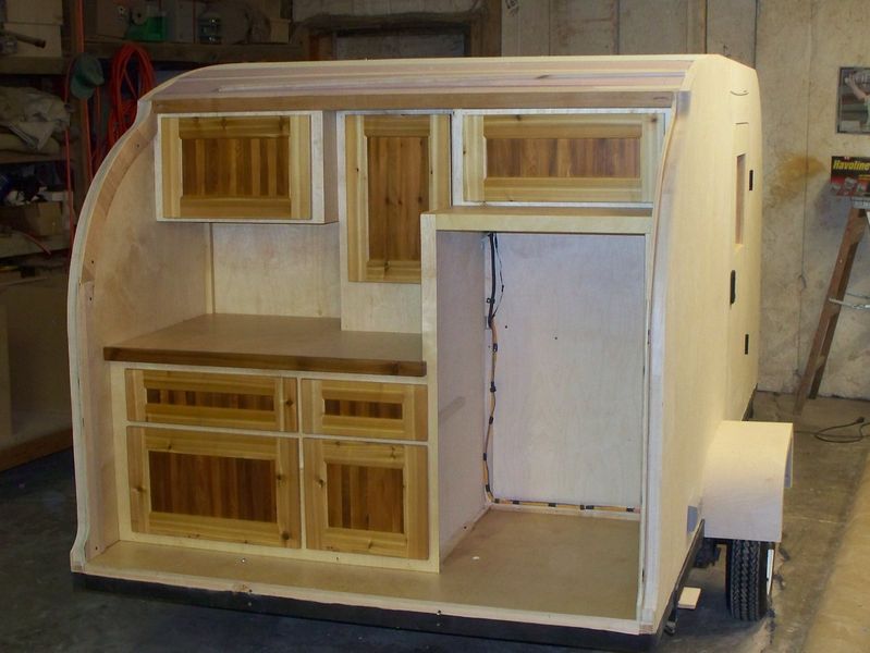

Postby oakinteriors1 » Mon Dec 16, 2013 8:18 am
Thanks guys...
Sprayed the doors this weekend and while they were drying....
I worked on the 2 cabin side doors mortised out the door jambs for the latches etc....
Hung the cabinet doors this morning...I like the 2 tone cedar rather than the all dark as on the interior doors...The dark cedar came from an old cracked and notty 8x8 beam a guy gave me...The lighter cedar on the galley door frames are from a 2X6 from Home Depot...

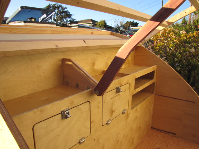

Thanks ...Now I need to fabricate the hatch support...The refrigerator side panel is 5'' off center but that should work for one like this....

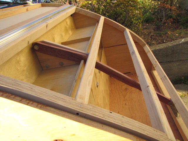

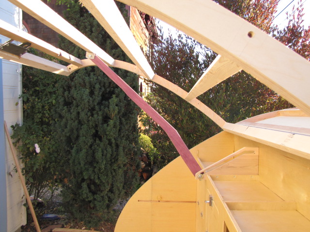

Camp-Inn style rear hatch support?
Take a look at this thread, I started it so I could design a Camp-Inn style. Or look at the end of my build journal. This is what I came up with. I found the angle on the support to be very helpful in fitting it to the space between the hatch and the cabinets. you can just follow the contour of your hatch. At any rate, there are more pictures in the thread above.
