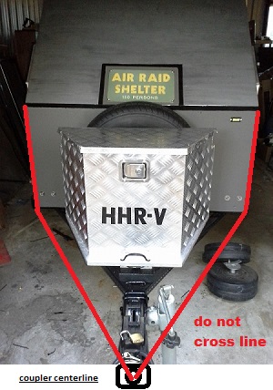

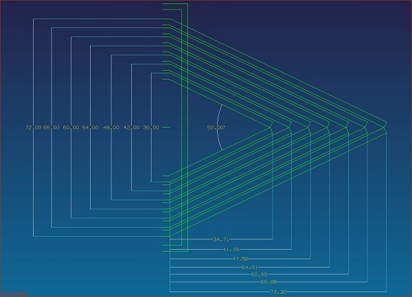

jonnyo wrote:...Now my question for anyone that as knowledge about tongue lenght....i want to shorten the tongue to the bare minimum. i consider it too long right now. by the time i put a coupler...and the ball behind the bar... it s gonna be too long. also, a shorter tongue reduce flex in a aluminum trailer. That is a good thing as reducing stress on a aluminum trailer is a wise thing. So, how do i determine how short the tongue can be? i m not concern about backing up...the trailer is so light, i will simply unhook it and move it by hand.
I just asked the same thing this weekend, in another thread,
working on it wrote: Concerning: relatively short tongue By the way, I've wanted to know how to decide on getting the proportionally correct tongue length for a trailer build. At roughly 3.5 feet, on a 11.75 foot long trailer, the tongue my TTT is 30% of the total. What is the standard to go by? I selected the optimal length I thought would fit these criteria: the fit inside my garage bay (with room to work on both ends), turning radius of my TVs (no contact of TV tail to TTT body within the "turn-interference line"
, >>see this thread for more info viewtopic.php?f=2&t=58573&hilit=interference ), and the overall side appearance (proportionally pleasing to my eye).96776 I have added more items on the front of the trailer since that photo, changing the overall proportional look, and would've added another 2 feet of tongue, if I was to have that choice again, but what is the agreed "standard" for choosing length? Since a high proportion of trailers built by readers of this forum are on Harbor Freight "utility" trailer frames, and some are extended in both fore and aft dimensions, surely some have had to extend their tongues for that reason, while others have not. Others build on scavenged frames with all sorts of tongue lengths. There is an "agreed" standard for ballpark tongue/total weight (10%), and for trailer balance (i.e.-the 60/40 fore/aft rule), so how about a ballpark figure to shoot for on tongue length? Added info, FYI: I overlooked this thread before, but in 2004 there was this thread viewtopic.php?t=298&p=1890 that gives a look at the "standards". For single-beam drawbars like mine, Mike suggests 3'-4' (mine is in the middle!).
In the last referenced thread, mikeschn included this visual aid
tongue std lengths.jpg (66.74 KiB) Viewed 4277 times
to get a ballpark figure for a A-frame tongue. A word of caution, from a person who always assumed his trailer would be easy to maneuver by hand: maybe, maybe not. Now at 1515 lbs, my "will be under 1000 lbs" trailer is a bear to move, under less than perfect conditions. It could occur in your build too, so maybe using your vehicle to maneuver it will be a better option.
