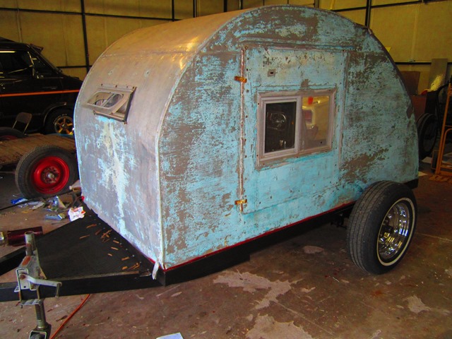

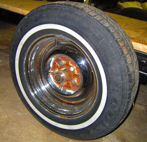

Well, I went to bolt on the 15x6 Mopar steel wheels to the trailer, and they end up being tight against the framerail! So, I went to Plan B, and took two of the 50-year-old chrome reverse wheels and whitewall radials off my lowered '68 Dodge D100, and bolted them up to the axle...they look great! And, they have nearly an inch of room between the tire and the framerail, so they are going to stay on the trailer. This gives me a good spare for both my Dodge pickups, from the other two chrome wheels and whitewalls, as the lowered truck is getting new 17" wheels and tires, anyway!
I also have the wood floor mocked up on the frame. This is going to work out very nice. As I have a good bit of ground clearance under the trailer, I'm thinking about having David, my welder, build an 18" x 44" x 6" storage "locker" under the rear part of the trailer frame, which would be storage for tools, a small jack, spare parts and miscellaneous bits. It would be accessed through a full-width drop-down door that opens to the rear of the trailer, under the hatch. This storage area would open up the area under the rear hatch for more things that require ready access. Since the axle sits back somewhat on my trailer, any weight issues that might have been caused by this box, should be pretty much moot here.

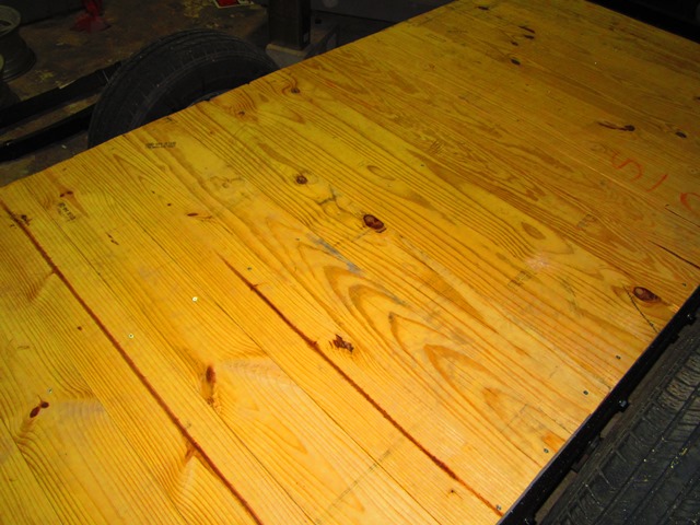

Well, I was going to paint and coat the floor bottom this evening, but I got the wrong paint for what I want to do. So, off to the box store to get the right stuff.
Meanwhile, you can see the bottom of the 4x8 floor, and the chrome reverse wheels with 205-75R15 whitewall radials in the pics. I had to trim up the one side, but other than needing to coat the floor bottom, the floor is ready to bolt to the trailer frame.

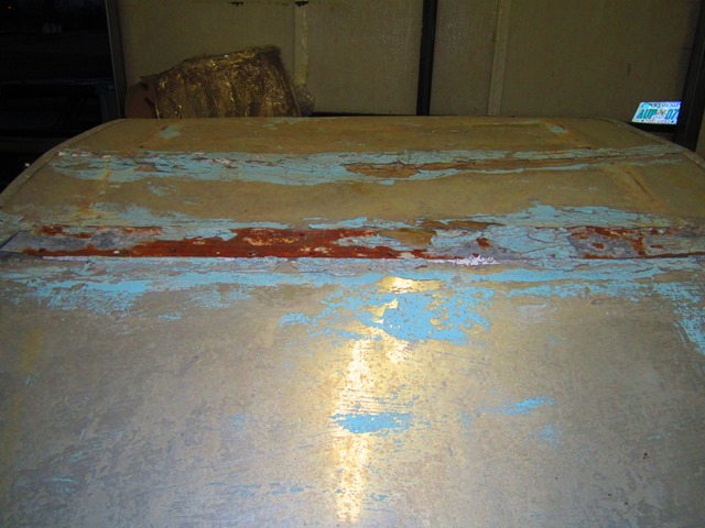

I used a floor jack, a 4x4 and a 2x4 to try to push the bend-in trailer shell roof back to something resembling a smooth surface. You can see that this is going to take a while! I'm so tempted to simply get a new sheet of aluminum and build a new roof, but that would take away that much more from the original look. Lots of work, no doubt.

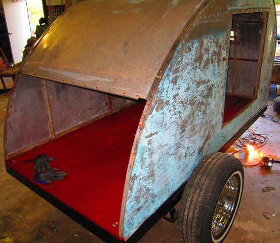

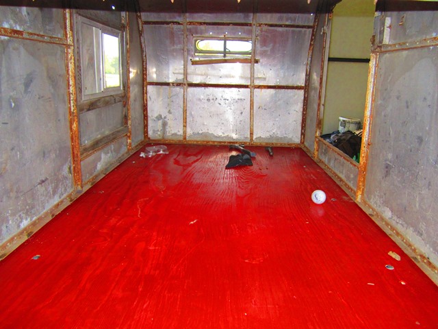

I painted the floor bottom (streetside) today with Rustoleum Red, and am painting the other side tomorrow. Since it's oil-based, I know it'll last a long time. I also picked up a new air chisel, so I can remove quickly the attachment screws holding the shell to the old floor. I should be able to test-fit everything tomorrow afternoon.
I've been tossing around ideas for the wiring, both the interior and the running lights, as well as the routing for all of that. I want to make as much of it invisible as possible.
Added: Got the whole floor painted red, top and bottom, this afternoon. I'll wait a day for the Rustoleum to completely dry, then test-fit both the floor and shell.

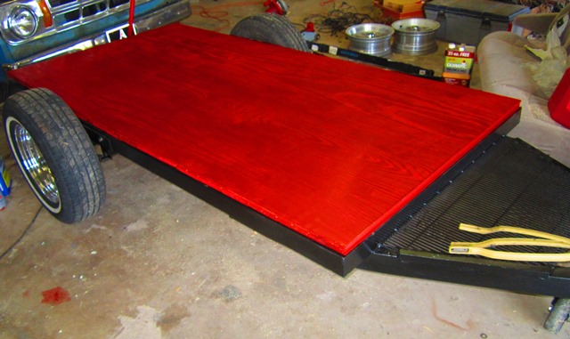

The floor, sitting on the frame. I made a slightly crooked cut along one side, but that'll be covered up. Not much accomplished today, other than getting the floor set on the frame.
I've decided to install a five-gallon water tank and a lawnmower battery under the rear deck. I found a long, narrow water tank at an RV store that will work great. The small battery will be more than sufficient for the power needs of the trailer, since it will be powering LED lighting and a car stereo. Recharging will be accomplished with a solar charger that will have a removable solar panel for when the trailer is under way, it can be stowed easily, and set up quickly when parked.

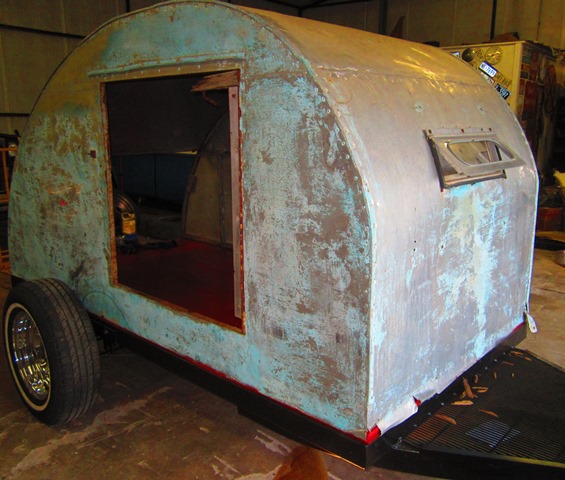

Yay! I finally got the teardrop shell off the old trailer and it's now on the new trailer frame, albeit just sitting on the floor for right now! I had to get a new cutting tool, as my old one fried itself. It was much easier to simply cut the bolt heads off than it was to get a flat screwdriver on one end and an adjustable wrench on the old-style square nuts. There were maybe two dozen fasteners that held the shell to the rotted wooden floor. My son and I lifted the shell off the old trailer frame and onto the new frame. It looks great!

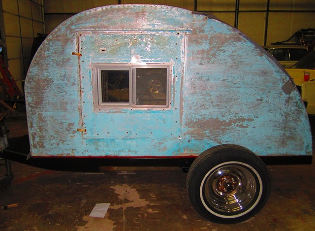

Postby Patrickteardrop » Thu May 08, 2014 8:05 pm

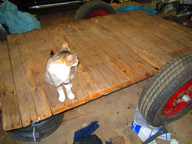

More pics of the old shell on the new frame:
The old frame and floor.
old tear frame with cat01.jpg (116.94 KiB) Viewed 1354 times
