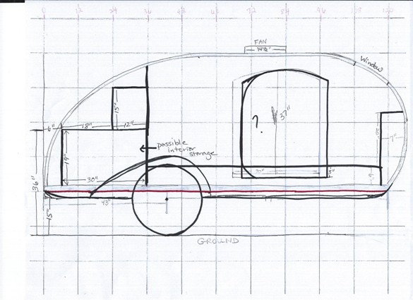

Esteban wrote:Lauren, nice galley design. Many people put the paper towel holder and a light (or two) on the underside of the galley hatch. That might free up a little more shelf space.
KCStudly wrote:I have been considering SS for the counter in TPCE, but it is relatively heavy. I work with it a lot in my day job, and it is a good material for its ability to be kept sanitary, its durability, and the fact that it is relatively nonreactive. Aluminum is not a good choice for all of the opposite reasons.
.060 thk (16 ga #4 brushed) is probably best as it will resist denting better, but I would consider going as light as 14 ga since it will be backed and would be lighter. A one piece 'Z' bend with back splash, counter top, and front lip is what I had in mind.
I'm enjoying your posts and look forward to your future progress, but I must reiterate: do yourself a favor and spend more time looking at other peoples build threads, and the construction techniques threads. There is so much to be learned and so many pitfalls that can be avoided by doing a lot of research.
