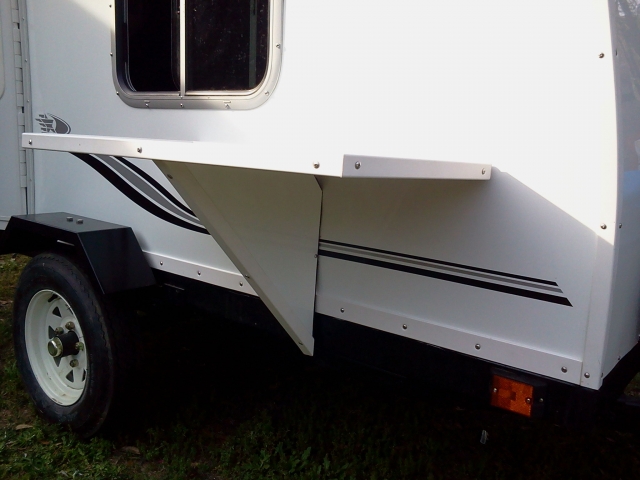

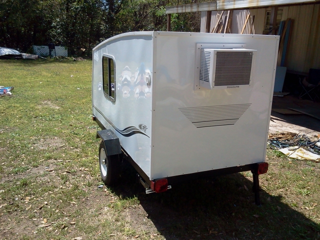

Well I have almost everything done only one more thing to finish and
it's an outside removable table which I should get done tomorrow.

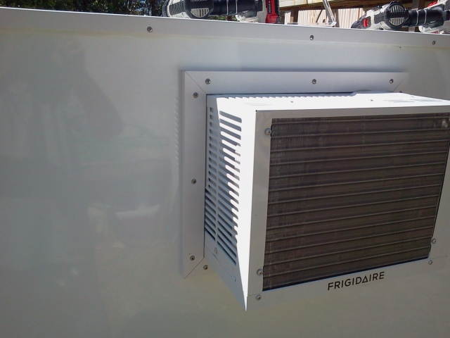

Got the trim around the a/c done
and I cut (by hand) some graphics for the front and rear and
I added some star graphics to the top of the swish's

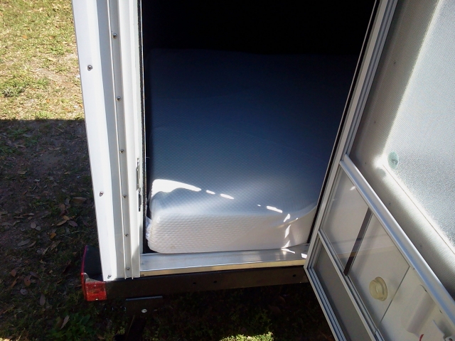

I got the mattress cut and installed 6" memory foam

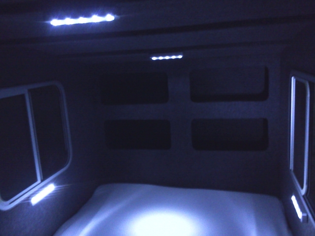

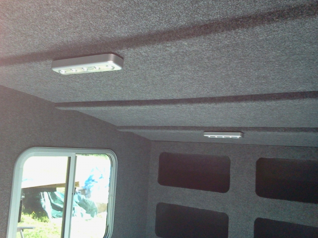

The nice thing about the carpet liner I used is if you get the "toothy" part of velcro it will stick to it.
Which I did to install my lights they are battery operated led lights.
I installed a total of 5 lights probably overkill but I had them so why not lol
I also went under the trailer and resprayed the entire bottom with rubberized undercoating.
I just have the table to wrap up tomorrow and it will be finished......for now :twisted:

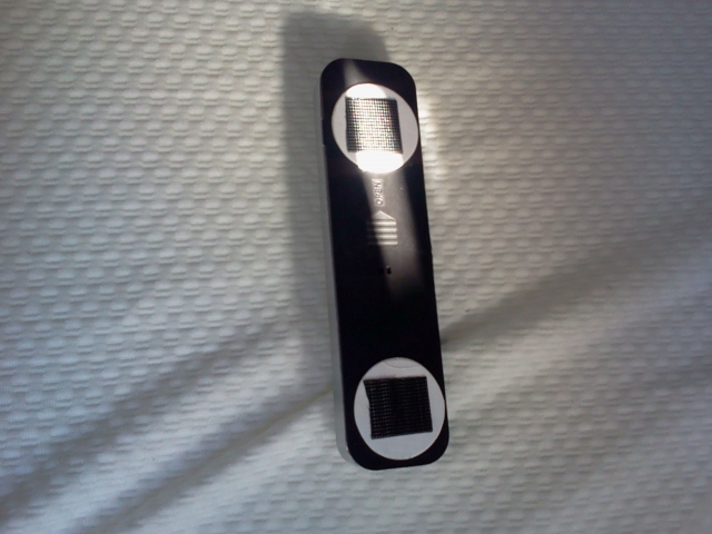

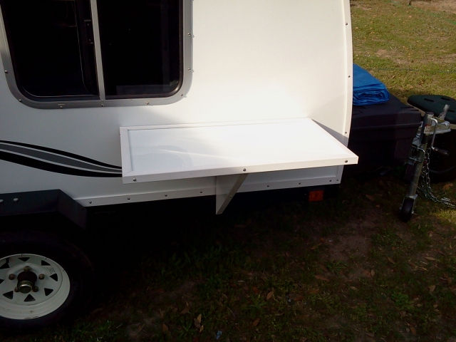

Postby jbyrd » Thu Apr 03, 2014 7:07 pm
Ok so last pics until camping pictures as The GOCAMP is finished!!!!! :D

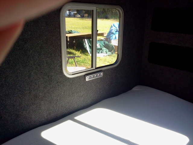

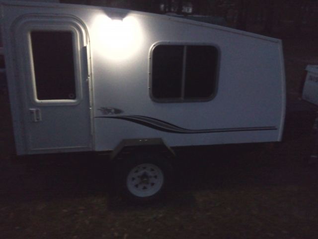

Last night I got some shots of the lights
Inside lights
Outside motion light

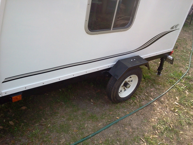

Then today I got a chance to finish the table and added some trim
to the bottom which looks alot cleaner than my screws I had used.
I used the same trim and aluminum as on the trailer since Im O.C.D. like that :lol:

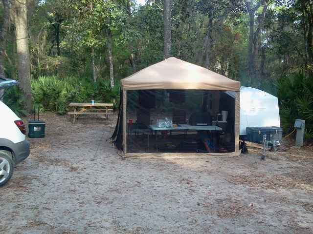

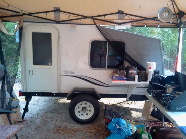

Well the trip was a success! The trailer towed fantastic, slept great and exceeded our expectations.
Us on the way over
Our campsite
