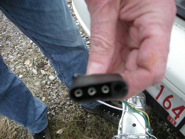

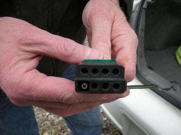

No Gorilla glue yet, but I did get a few things done today. The floor is now back on the trailer, and bolted in place. We backed the car up close to it, and tried to test the lights, only to find that the wires are not compatible! I hope there is an adapter for this, and I wonder where to find it. I have shown pics of this dilemma.

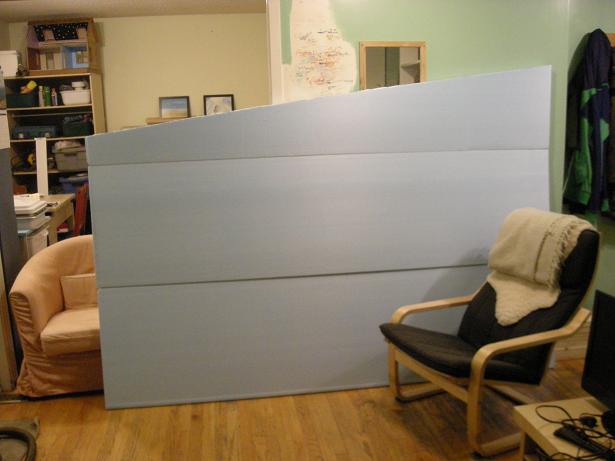

I then spent a few minutes lying on the trailer floor and admiring the cold, cloudy sky, while imagining the finished trailer. Then I came inside and cut my first piece of foam (used a steak knife). Here is a mock-up of one of the side walls (held together with toothpicks) with an Ikea chair for scale. The next step is to glue the three pieces of foam together, and I am still thinking that part through. I want to make sure that the foaming action of the Gorilla glue doesn't push the panels away from each other. Any ideas?

The electrical dilemma.

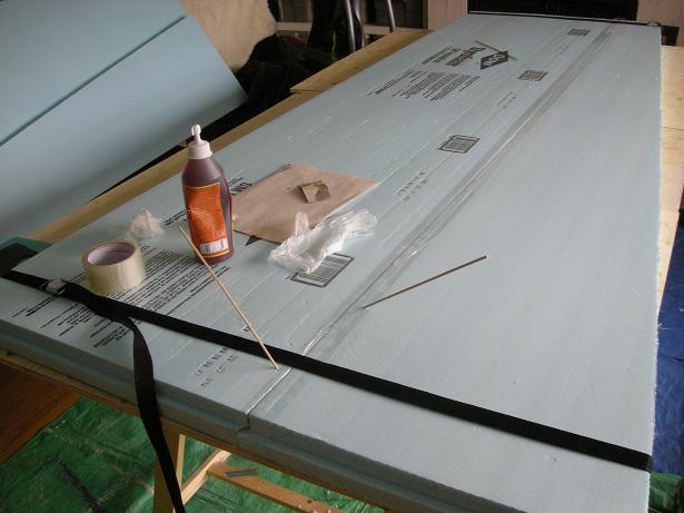

Those are not good pictures. The basic problem seems to be that both connectors are "female" so they can't connect. I went to an auto parts store and they said one of them would have to be cut off, and a male-type one sautered in its place. I want to find out a bit more about this...in the meantime I am working on gluing the 2x8 sections of foam together to make the side walls. The instructions say to clamp the work for 2 hours, but that a full cure is 24 hours. I wonder how soon I can move the piece, in order to glue the other one? (Only one work surface, y'see) :thinking:

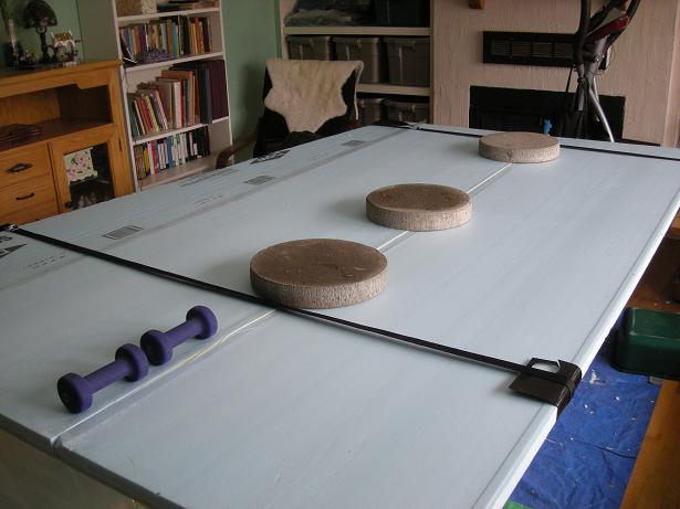

Further experiments with GG. A little more glue, a little more water- eek! run for more weights...!

Postby KCStudly » Tue May 06, 2014 3:30 pm
In my climate I find a thin smear of GG using a fake credit card (the ones that always seem to come in the junk mail) on one side, and wipe with a barely damp cloth/paper rag on the other side and I'm good. Trim any squeeze out as flush as you can with a steak knife or extended snap type razor knife and be very careful if sanding is necessary (tends to cut adjacent foam and not the GG joint).
Light weight vinyl ceiling spackle is your friend.
Re: Hybrid Foamie in Southern Alberta
Postby KCStudly » Tue May 06, 2014 3:34 pm
I'll just add, you are looking for tight joints with tight bubbles in the glue (i.e. not a lot of expansion). The more water you use the bigger the bubbles will be and the weaker the glue joint.
Remember, GG is not a crack filling compound. It is a glue. Keep your joints tight, only use a film of glue and barely any moisture.
Postby Shar » Tue May 06, 2014 3:45 pm
Thanks KC! I have two more to do today, so I'm honing my technique as I go. :D It was amazing, with that second one, how the glue pushed up against the sheet of foam.

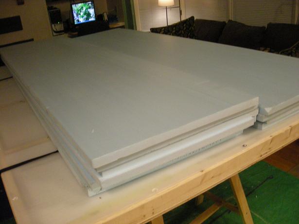

By the end of the day, I had the foam panels for the side walls glued together. Once I have prepped them with some abrasive process, they will be ready for skinning. My plan is to use 1/8 ply on the inside, and canvas on the outside. I don't have the ply at my house yet, because the trailer isn't roadworthy yet (because of that electrical issue) and I don't want to bring 1/8 ply home on the roof of my car; I am afraid of damaging it with my powerful ratchet straps. :frightened:

Postby jstrubberg » Wed May 07, 2014 11:20 am
Sheryl,
Replacing one of those trailer plugs is a lot easier than you would think. The color coding on the wire is standardized, so you can cut one plug off and simply mate the same color wire on the new plug to your harness.
Also, soldering isn't necessary. Any place that carries the replacement plug should also have weatherproof butt connectors. You cut your wire and strip the end, then crimp on a butt connector, match it up to the appropriate wire and crimp that wire into the other end of the connector. When you are done, you use a lighter or other heat source to warm the end of the connector and it shrinks tight around the wire to keep water out. More than good enough for a lighting system.
Good luck!

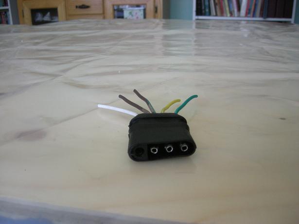

Thanks, jstrubberg! I did cut off the old one (see pic below) and bought a new one that was compatible with the connector on Mark's car. When we tried to wire them together, we found that the new connector had 4 wires, but the wires from the trailer numbered 5. We put the white with white, the yellow with yellow, the green with green, and the two brown wires from the trailer with the one brown wire from the connector. The left brake light works now, but not the right. We spent a couple of hours checking every part of the system (is it the bulb? is it the light? etc.) without success. Did we mess up by putting those 2 brown wires together?
