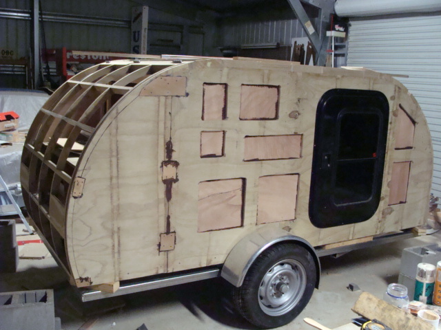

Day 41: 28 August 2012.

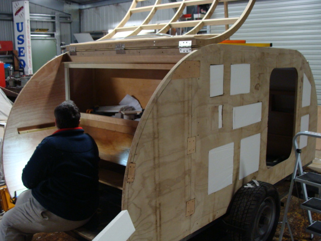

We have finished fitting the inner liner and the rest of the roof beams. Had a bit of a job getting the rear panel in to the H section joiner strip, but got it in there in the with a nice snug fit. :D
Have framed and cut the hole for the roof vent and started sorting 12v wiring for fan and lights.
Also been sorting locks for the hatch and fitted an extra couple of panels in it to attach tail lights and number plate. For catches we went into the building supplies shop and got household door catches. They had a locking garage door latch handle on the clearance table that was ideal. I made up some connecting wires for the catches out of some stainless steel fishing trace.

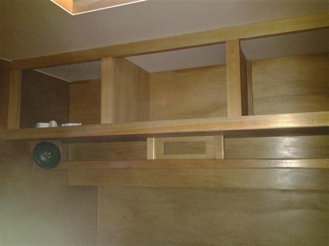

I am still in the planning stages with the under bench layout in the galley, and this is eating up a lot of time. :thinking:

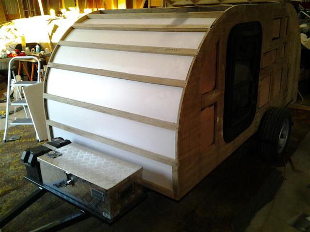

Day 45: 1st Sept 2012.

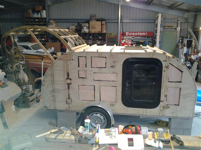

The packers have now all been glued in around the edge of the walls, between the roof beams.

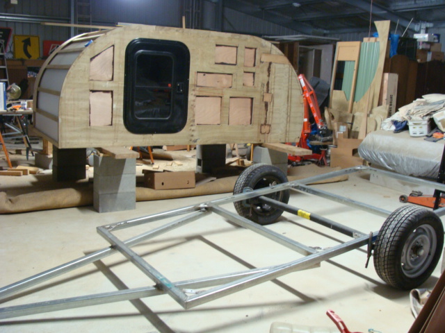

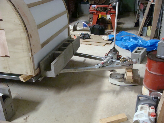

I have lifted the body up from the frame and set it on blocks, so that I could clamp the axle to the frame so that I could sit it down and take the weight on the wheels.
Here I have loaded concrete blocks on to the "A" frame to replicate the weight of the battery and tongue box. We also loaded the galley area with cooler, cooker, etc. etc. etc. then put the bathroom scales under the front of the frame to check the weight on the tow ball. Then we were able to move the axle back and forward to get the weight on the ball to what we wanted it to be.
Then we were able to lift the body off the frame to weld on the axle mountings, make the frame for the battery box and tongue box and mounts for the mud guards, and then paint it all.

Looking good Frank. Curious about the setback for the axle & your weight mock-up. As a function of the overall length, what % are you with the axle for the tongue weight you wanted? Is it about 39% as is a "normal" build, or is it different? Oh, also, what tongue weight did you decide to use for the loading? I like the way the build is progressing & the box is sitting up on blocks as things are worked out. The basic shape does lend itself to structural strength, doesn't it?

noseoil wrote:Looking good Frank. Curious about the setback for the axle & your weight mock-up. As a function of the overall length, what % are you with the axle for the tongue weight you wanted? Is it about 39% as is a "normal" build, or is it different? Oh, also, what tongue weight did you decide to use for the loading? .
Axle position was not set in relation to overall length, rather it was done based on the relative weights and their distances ahead and behind the axle.
As far as "normal" build is concerned, what is "normal" when it comes to teardrops? :crazy:
As I mentioned in earlier posts we had not had anything to do with teardrops before starting this build, and had only looked at photos for a basic idea on layout styles. Otherwise it was just basic geometry and common sense.
We had positioned the doors for ease of access for rolling in and out of bed, and wanted the wheels and guards where they would not interfere with the doors. We could see that the weight distribution was going to be toward the back and had roughly set the axle to where we guessed the balance point might be. I chocked the body about 50 mm above the frame so that I could get clamps in to hold the axle in place then sat it down to take the weight on the wheels and thereby establish the balance point. The general rule of thumb is to have the hitch weight at 10% of the total weight of the trailer. I had been weighing things as the build progressed and had an estimate of 500 to 600kg finished weight, including camping gear etc. This put the goal weight on the coupling at between 50 & 60kg. The concrete blocks on the front were to simulate the battery and tongue box. The alloy tongue box contents would be kept to a minimum, ie. small gas bottle, ground sheet for the gazebo, ropes, pegs, type pump, shore power lead, and a few other odds and sods. We loaded the galley with about the weight we would be likely to have in there. With the scales under the front of the coupling, I was able to carefully move the axle back or forward until it gave us the weight we wanted on the scales. Very small adjustments to the axle make a big difference at the hitch, as it is the very furthest point forward. Then we could mark the position and lift the body off the frame to weld the axle in to place.
For your situation, towing with a ute, you can handle a bit more weight on the hitch,but as I was going to be towing with my old Capri, I had to get it right. And as it turned out, it is spot on and tows like a dream. :beer:

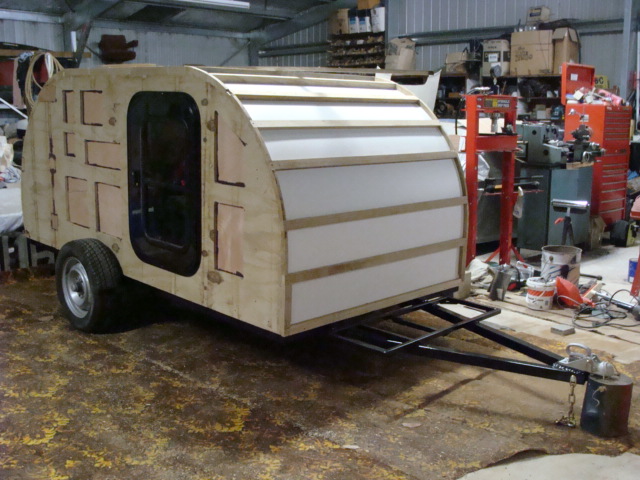

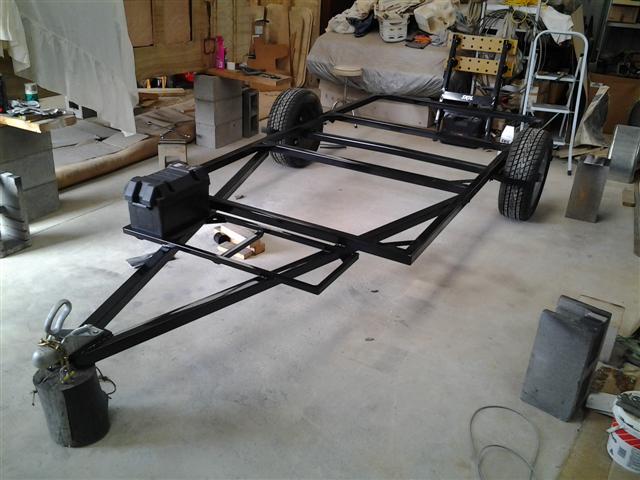

Postby Sheddie » Tue Sep 09, 2014 6:17 am
Day 53: 9 Sept 2012,
One month to go. We are due to leave on the 10th October.
The frame is completed. The coupling is mounted, I have made the frame for the battery and tongue boxes. The axle is attached, as are the mountings for the guards (fenders). It has all been painted, and is now ready for the body to be finally attached.
Body back on frame and bolted down.

Tongue box and battery box fitted and bolted down with a pad lock over the battery box. They will have to come off again though, so we can skin the roof. We didn't go too big with the tongue box, so that we weren't tempted to load too much weight up front.

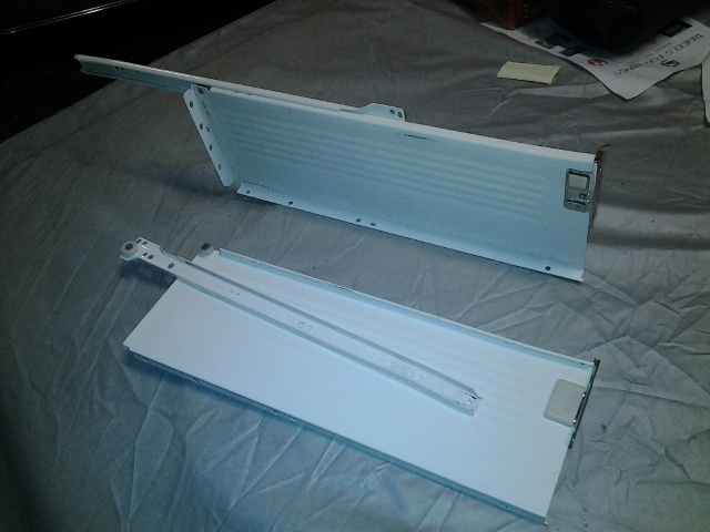

We found these at Arthurs Emporium. Really easy way to make drawers. These are the sides and roller runners, you just attach what ever size board you want for the bottom and back, make up a nice front, mount the runners and it's done. And best part, only $5 a set. :banana:

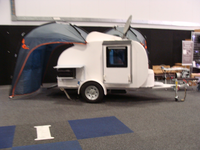

Took the day off work and working on the TD, and headed down to Auckland, a couple of hours south of us. The annual Motorhome and Caravan Show was on, and we wanted to have a look around at what may be available for us to use for an awning over the galley and side doors. Also to look at any other ideas that may be useful for us. Wasn't a lot of use to us as the camping industry in NZ seem to cater more to the tenters, or to the high end motorhome and caravan brigade which is generally $> $> $> .
The nearest we saw to our line of camping were trailer tents (also big $> ), and the TD in the photo below. Called a "K-Pod" this is one of the few commercial attempts at a TD in NZ. We had looked at them on line before we started building, and were very tempted to drive to Tauranga to have a look. But then when we studied the spec sheet we decided it was a bit on the small side. Now seeing it in the flesh it is even smaller than we thought. With the bed less than 1800 (6ft) long and under 1200 (4ft) wide there was no way we could sleep in that. That is not the door on the side (we drive on the left so the door is on the other side), it is a slide out. Pulls out about a foot, might stop you banging an elbow.

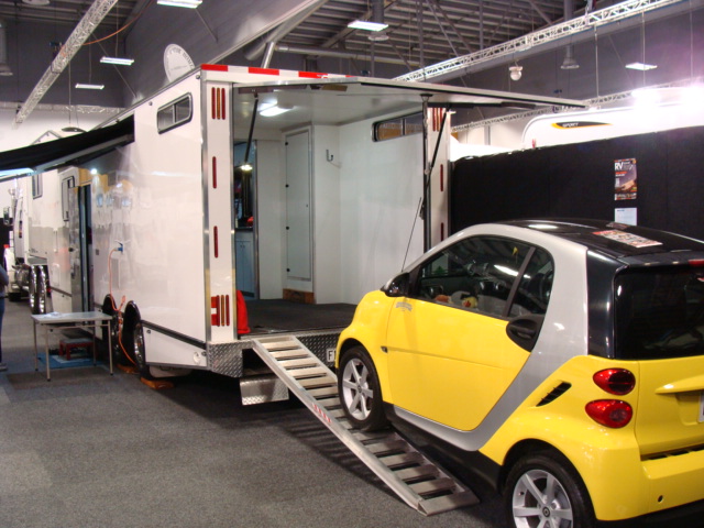

From that things went to the extreme, with this humungeous Western Star with sleeper cab and fifth wheel camper, complete with garaging in the back for their Smart Car. More $> $> $>

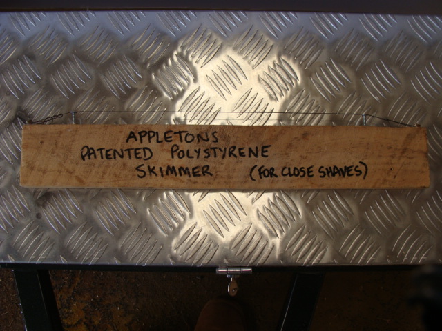

Side panels have been sanded and the insulation has been glued in. Only problem there is that the ply is 19mm and the insulation is 20mm. :thinking: How can we trim back the poly so that it wont hold the exterior cladding away from the ply. After trying a couple of other methods we decided a hot wire was the best method. I got a piece of wood and put 4 screws in the ends. 2 to secure a piece of s/s fishing trace and the other two to hold the wire away from the wood. I used a couple of slotted screws so the wire could sit through the sots, the screws having a slightly raised head. I connected a set of light weight car jumper leads to each end of the wire and the other end of the leads to a battery charger. By sliding the screw heads along the ply of the side walls, the hot wire sliced through the poly like a hot knife through butter, trimming wafer thin pieces of poly and leaving a nice smooth surface. 8)
:eyebrows:
:scratchthinking: As you can see below the galley is still a long way from done. Dale is busy here varnishing the walls.
