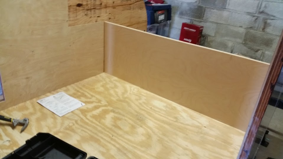

Backing up a bit.

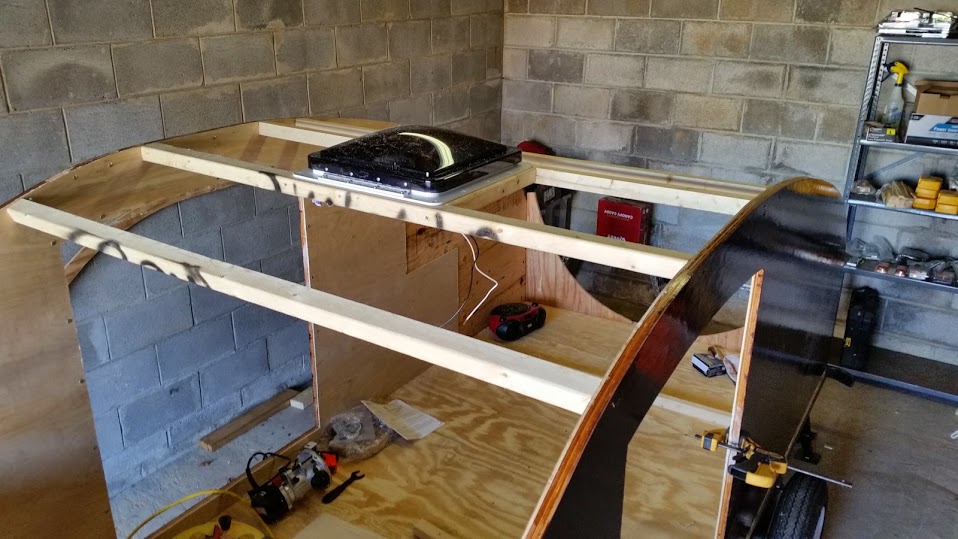

after gluing the 1/4 inch birch veneer to the sides, I used some large headed washer screws to secure it to the base plywood.
I may leave them in. If not, I'll just remove and fill with wood putty before sealing.
Also installed the spars and framed out the Fantastic Fan.
It's a good life!
Ken

Postby kenafp » Sat Nov 29, 2014 9:44 am

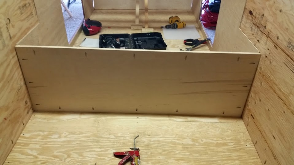

Installed the foot panel.
The bedding area nows has some type of definition...if that's what you want to call it.
It's a good life!
Ken
Build Journal: viewtopic.php?f=50&t=60665

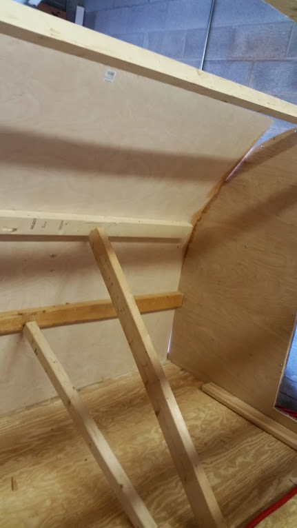

Postby kenafp » Sat Nov 29, 2014 9:50 am

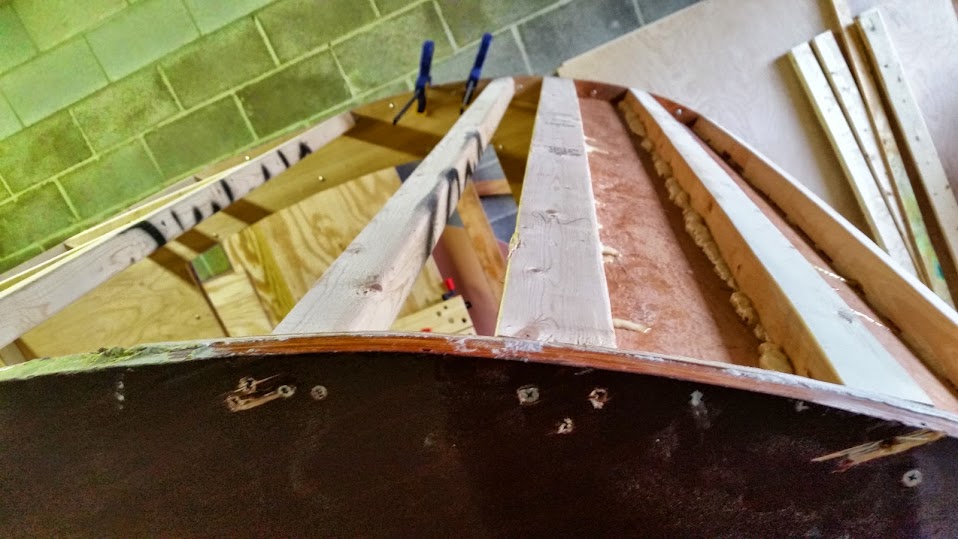

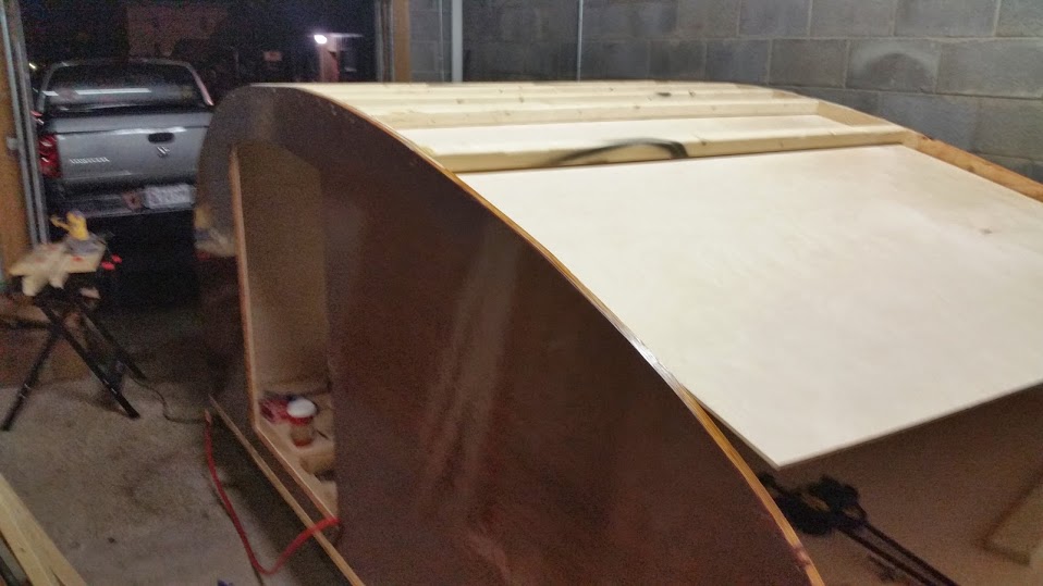

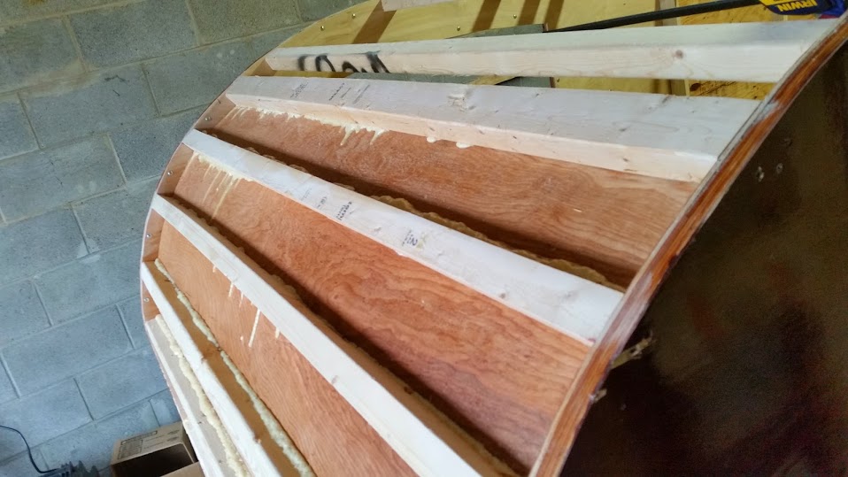

This bending process sure takes some patience...
I kept wetting it down with water, giving it about 15 minutes between sprays, then ever so slightly adjusting the tension to bend it.
It's a good life!
Ken

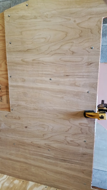

Built the frame for the foot cabinets and TV cubby.
cabinet frame.jpg (68.19 KiB) Viewed 1837 times
This is just sitting here. It is not installed yet.
I will be staining and sealing it before installation.

Re: Lil' Nugget build
Postby kenafp » Sat Nov 29, 2014 9:31 pm
Thanks, Sharon.
Now for today's progress.

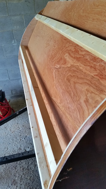

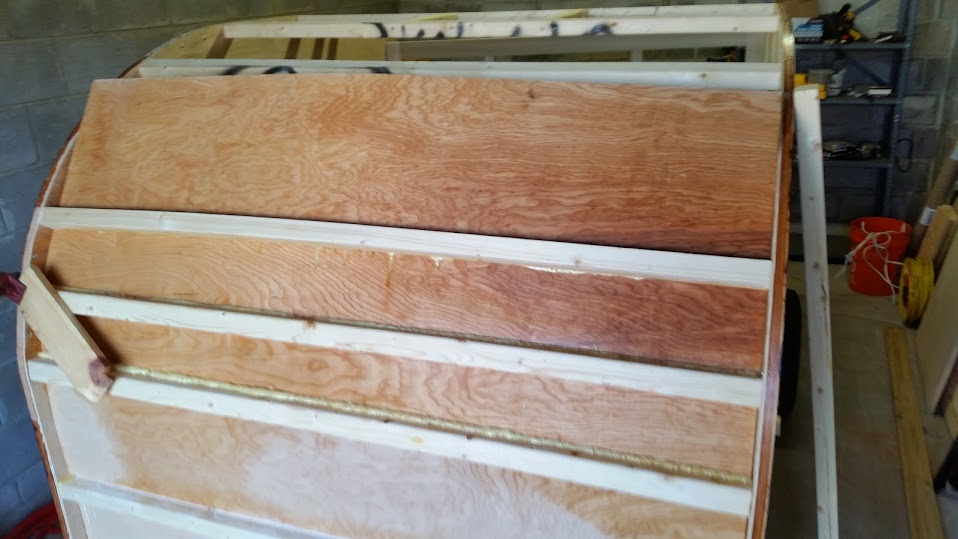

I tried to bend the 1/4 inch interior birch panel, assuming the bend would stay. When I released the pressure, it just went back to a straight board after being bent and moistened for three days.
So, I decided to do a progressive bend, removing the higher spars, placing a pressure point on the opposite side of each spar as I moved up.
Frankly, this got tougher as I moved towards the end of the panel. It took 2.5 of us to get this thing to bend right!
I first used Titebond III as the glue, but found it wasn't what I needed. I ended up using Gorilla glue after moistening the panel to ease the bending process. This one panel took about 5 hours to get right. A lot of patience!!!
It's a good life!
Ken

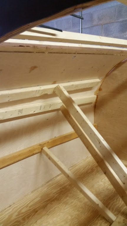

Postby kenafp » Sat Nov 29, 2014 9:38 pm
Setting the interior pressure points made it easier to bend for the next spar to be installed.
I ended up using screws to hold the panel in place at the spar.
Where two inside skins will meet, I used a 2x3 as a spar to give me better adhesion
This was a tough one!
It's a good life!
Ken

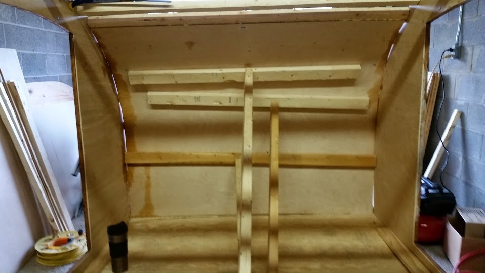

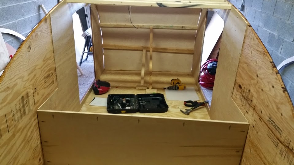

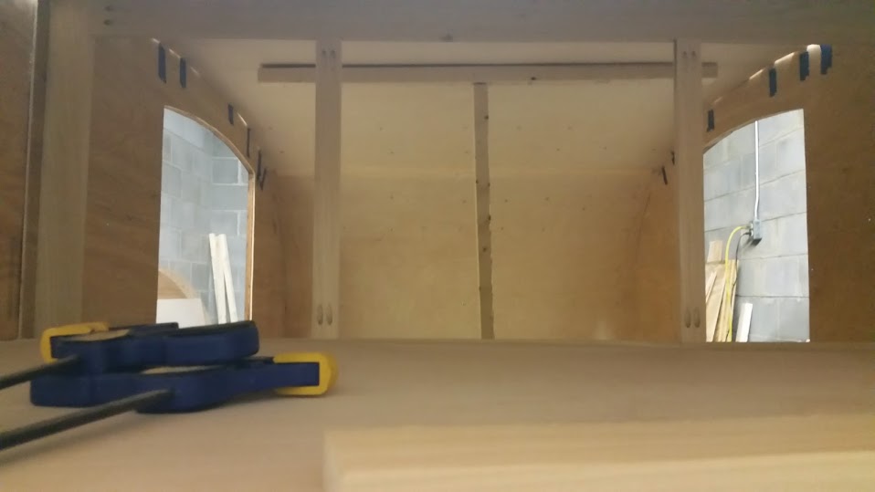

Update on the build.
I stop by the storage unit after work for a few hours and work on the TD.
So far, I've been able to get the interior cabin enclosed.
Soon, I'll be able to work on the galley.
