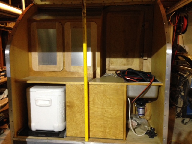

Well this is basically what it's going to look like with the hatch up. Definitely more functional than elegant. I still have to stain those last two doors. It's a little hard to make out but the curved piece that is the roof of the cabinets is aluminum and the faces of the doors are aluminum. I showed my lady wood panels and aluminum and she voted aluminum.

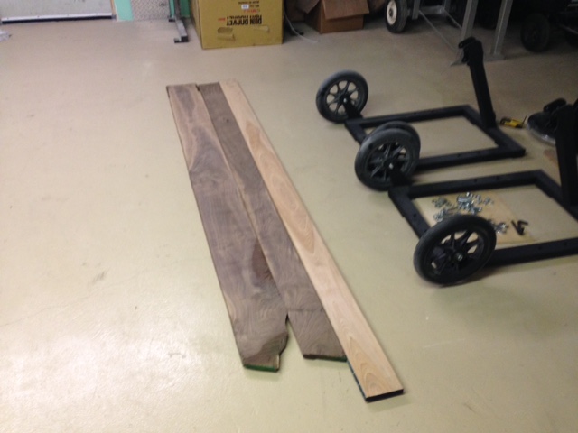

I got some walnut for $3 a board foot. and some Birch. That will soon be the counter top around the sink butcher block style.

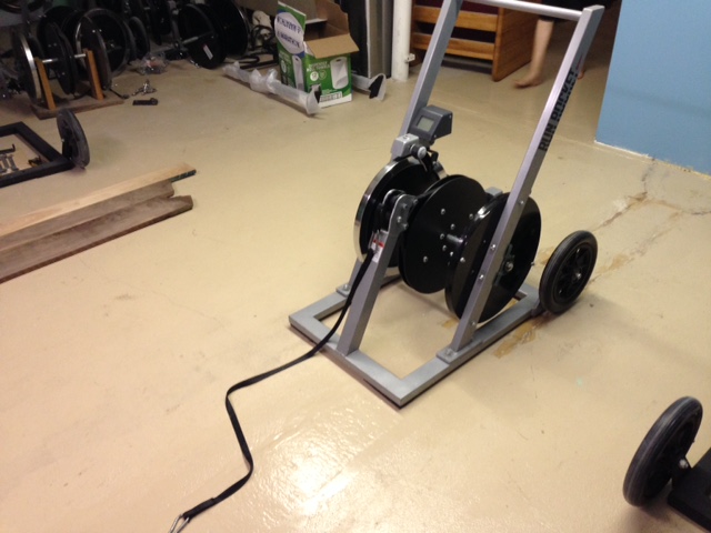

Those are the base of the frames to Runrockets. It's a resistance running machine that football combine training centers and sports teams use. I invented that a few years back. The olympian Michael Johnson saw it and sponsored me for free! HE is an awesome guy. They are the best (but most expensive) resistance trainer in the world. Which wasn't too hard because the next best thing is dragging a sled on the ground. I have them built in Taiwan. Those were some used demo units that I had repowder coated for my Crossfit gym here in San Antonio.
I have those all over the eastern half of the US. Last year I sent 100 to the UK for rugby teams. I don't have too many in California, maybe 3 or 4. Which is where my teardrop comes in. My wife and I and going to vacation out west and attend coaches shows and visit sports teams and travel.

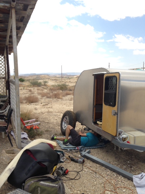

Postby Adventure Time » Wed May 11, 2016 12:26 am
I had to leave the trailer there in the towtruck driver's mom's front yard for a month. Very nice of them to offer. I ordered a custom axle from dexter. I went out on mother's day and bolted it on behind the broke one.
This axle is a dexter 5000 lb. axle with the torsion rubber cut back to 2,500 lbs. The wheels are 6 on 5-1/2". I can use the spare off of my FJ cruiser and not have to carry one for the trailer, which does absolutely no good if the wheel flys off!
To explain what happened so someone else may avoid this calamity...I had a 2,500 lb axle that was really old. The shafts were 1". I bought 5 lug on 4.5" hubs. And I bought 5 lug 4.5" adapters to 6 lug on 5.5". They were 2" thick. This allowed me to put FJ cruiser sized wheels on such a small spindle axle. When I first put them on I saw that the axle was bent because the tires leaned in at the top, just a bit. I thought this was no big deal. Apparently the axle was already overloaded and damaged a long long time ago in a galaxy far far away. The point is, I had no idea what that axle had been through before I welded it on and took off across the state.
The spacers also torqued those 1" shafts.
DEXTER AXLE is a well ran company. I ordered a custom axle on Monday. It was shipped on Tuesday and I got it on Friday! My only complaint was I had to paint it myself. I wanted to powder coat it but it has rubber in it and can't be heated.
I now have the axle set toward the rear (where everyone else's axle is). It has tires that are 31" tall. It rides great. It is set up to be off-road capable. It follows mt FJ over some rough terrain. I hope the axle is OK with this.
