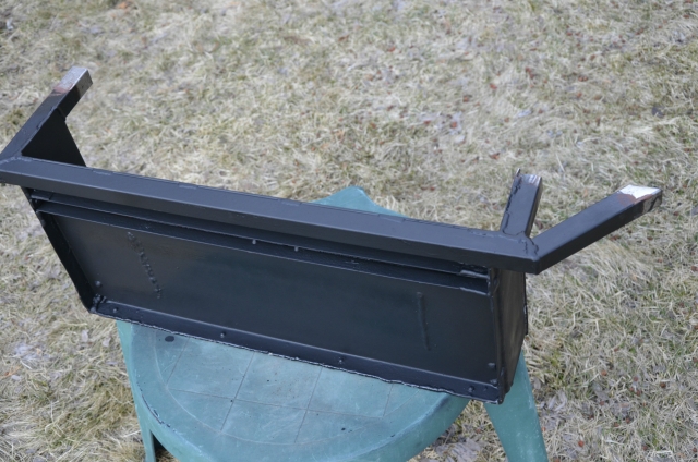

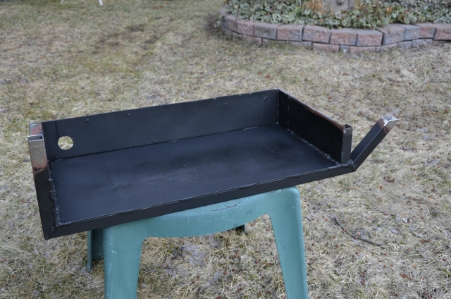

Postby OP827 » Sun Apr 05, 2015 6:42 pm
The step is finished and coated, paint is drying in cool albertan afternoon sun, waiting to be welded to the frame.

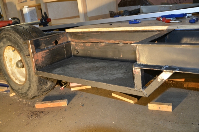

Postby OP827 » Mon Apr 06, 2015 10:00 pm
Tonight i welded the step in place. "Milestep" achieved :lol: !

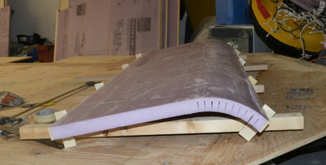

Postby OP827 » Fri Apr 10, 2015 12:03 am

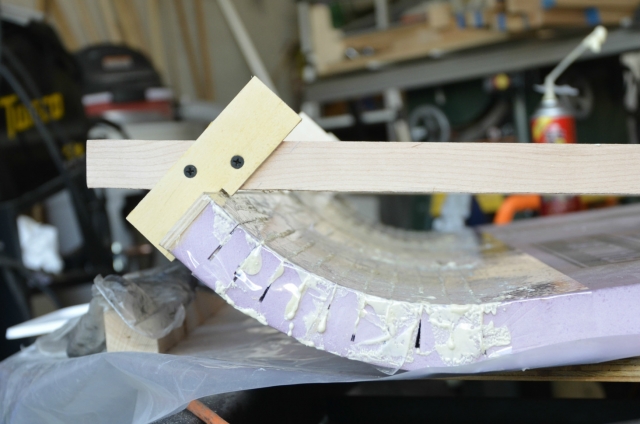

I need to have two identical wall panels in front of the trailer with curved foam so I made these custom brackets/clamps out of scraps for their glueups. The photos show dry fit, quite happy with them. They will just "click in place after I put glue in the kerfs. Looks like a wing section 8). I am thinking to use Great Stuff for the kerfs as a glue, it should make for a strong curved panel and fill the kerfs good.

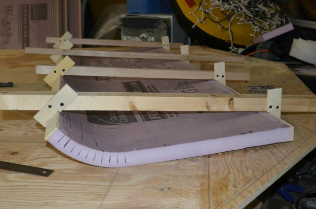

Postby OP827 » Fri Apr 10, 2015 3:42 pm
Thanks KC.

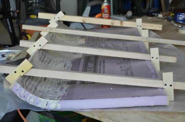

I went ahead and glued up first panel this afternoon using this new method. Will keep it clamped at least until tomorrow, hope it will be enough time for foam glue to set w/o issues :o
Scotch tape to reduce sanding the foam after glueup
Clamped or rather "clicked" in place, the fastest clamps on earth :lol:
Nice and straight :thumbsup:
Now the part will have to wait for the glue to cure. :coffee: ... OK, but only one cup and back to other things to do.

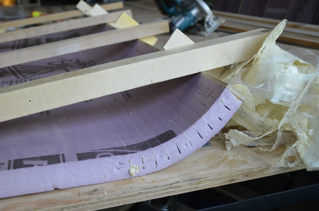

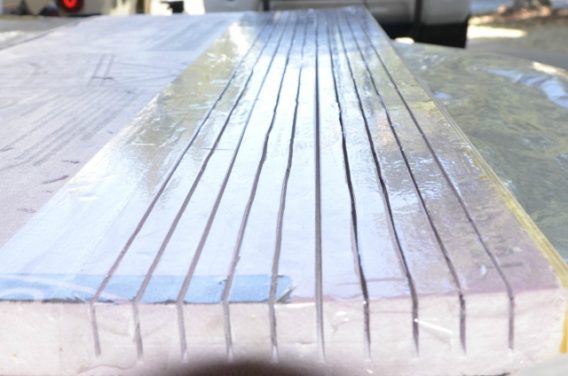

Postby OP827 » Fri Apr 10, 2015 8:27 pm
It is impressive how easy the scotch and foam squeeze out pealed off and left NOTHING for sanding, WOW :thumbsup: 8)
Is that a good candidate for FOAMIES FORUM separate article or even maybe a sticky :shock: ?
I did not see such packing tape trick used here before, but i did not read that BIG foamies thread yet.

Postby OP827 » Fri Apr 10, 2015 10:58 pm
I wish I put the tape on foam before the kerf were cut (next time I'll do that), but this idea with packing tape came later.
So to make it work I first put the panel in the clapms so that the kerfs will close and then put the tape. Then cut the tape along the kerfs with sharp blade. Then removed the clamps, put glue in the kerfs, clamped back, waited for glue to cure, pealed off the tape, did a photo :thumbsup: .
As for hjow much tape used, I would say not much and it is well worth it. I spent so much time sanding and busted sand paper last time I di this glueup with other panel, so the tape is a way to go and it is more economical overall for me.

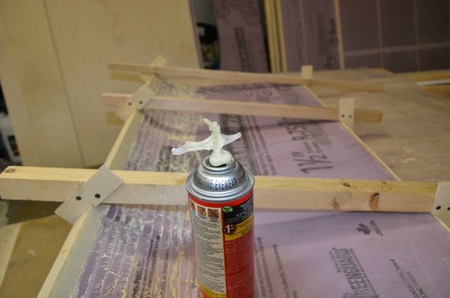

Postby OP827 » Sat Apr 11, 2015 10:02 am
Second curved panel glued up and clamped this morning, easy and fast, thanks to below described trick.
Previously it was difficult for me to put Great Stuff inside each kerf in a clean way and right amount.. suspect I am not alone as all I heard here is that GS is very messy.
Then I found that if i take of the plastic tube and run this can tip inside the groove, this difficult process becomes a very easy and FAST which is more important on a bigger amount of kerfs to fill, the kerfs are now fully filled with GS, making for a stronger panel and with a right amount of squeeze out, no mess. :) groove on! :thumbsup: I like foam, it's fun :dancing

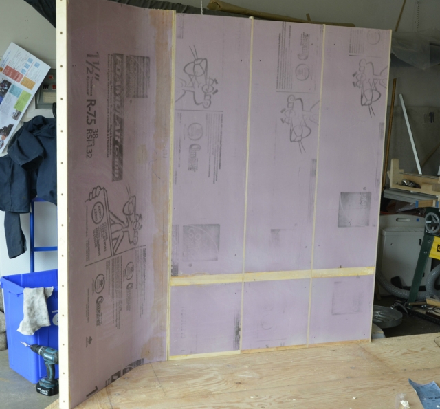

For the first time put first two wall panels together today, just a dry fit for now. The photo does not do it justice. The curve panel fits to next wall panel flawlessly. It feels so great to finaly see the ideas starting to come together. This wall panel with plywood edge and dowel works great, we are "masterbuilders, everything is awesome!" :dancing :awesome: :banana:
OP827
Posts: 1595
Images: 414
Re: Foldable foamie transformer with amenities
Postby OP827 » Sat Apr 11, 2015 1:52 pm
Here is a better view of wall panels detail. No sanding was needed for the curved wall section.

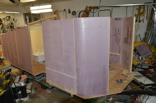

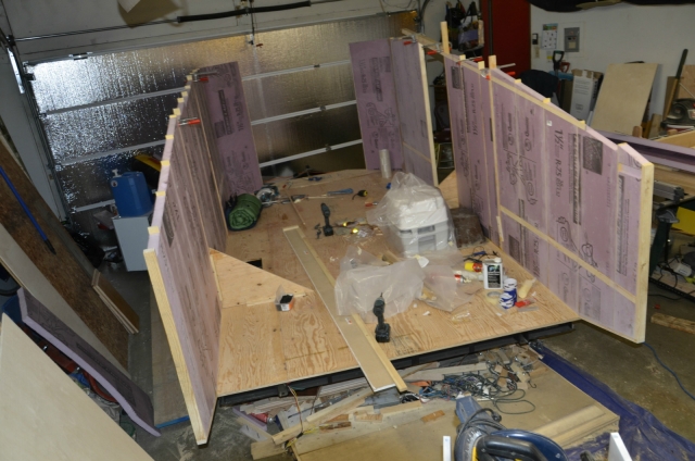

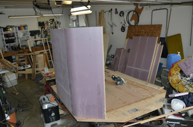

Postby OP827 » Mon Apr 13, 2015 10:29 pm
Did a raw fit of walls today to see the actual trailer size and try for size to sleep across and enter and exit for door height. 8) :P
A little unusual to have lower door, but seems to work ok. The door will be about 62 inches from step to top in folded roof position. I think I can leave it like that w/o further thinking of additional door top extention beiing part of folding side wall
Is 62 inches entrance height good enough?? :thinking:
Sleeping across works good for my height, no worries there :thumbsup:
