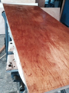

I built a small shed 5 years ago using 1/2" CDX- again I shopped for the best face veneer I could find. I painted it with a combo stain/paint
( & sealed all edges) and have let the Florida weather do it's thing- It's a little faded, but no delam anywhere-
I think having a clear face veneer is the key- and exterior glue, which Florida CDX uses. Also seal the edges and back side knots. Ask me in 5 years how Weekender2 is doing.

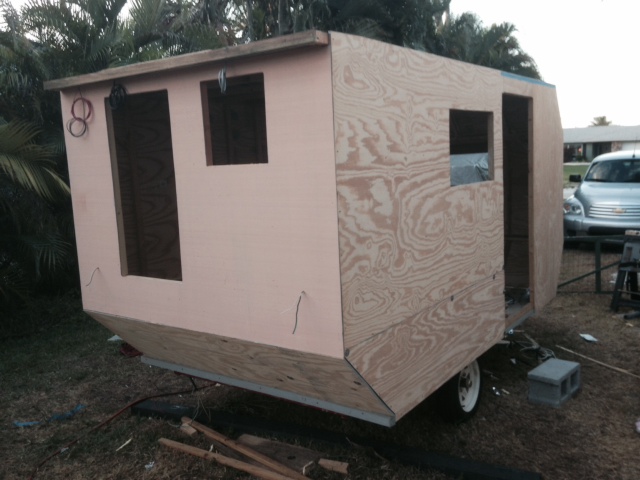

Day 52,
We had some clouds come though with a few sprinkles- my work commenced about 10am.
Finished the rear plywood- sides are now 100%. I still have a door to build. The rear wall is covered in Sureply 5mm primed underlayment from Lowes. I realized it's not a load bearing wall, so no need for strong plywood. As an experiment, I wanted to compare how the Sureply holds up. If it fails, I can replace it and it saved me about eight lbs. I masked and repainted the top plywood edges with water proofing sealer. Then I installed 2 coax cables and ground wires for Ham radio antennas.

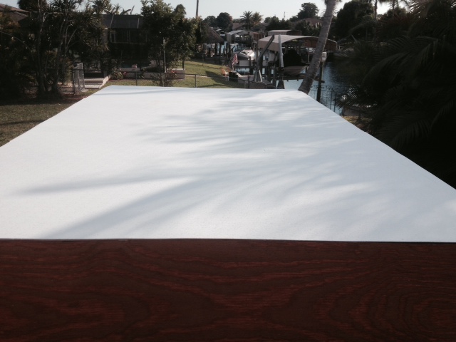

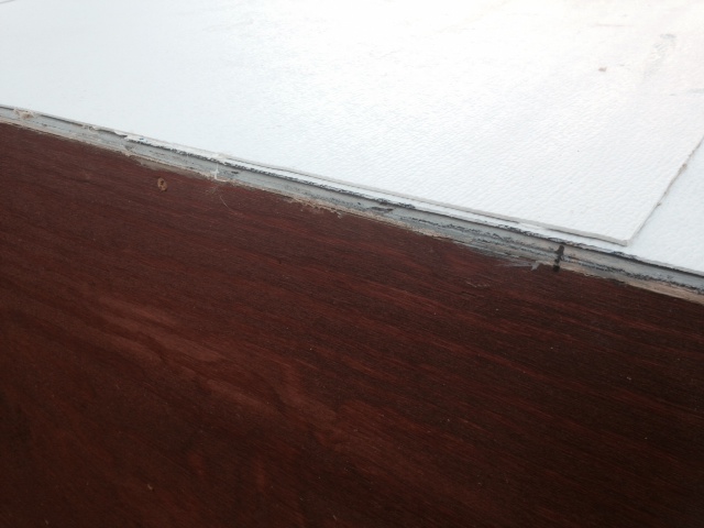

Finally, I finished the roof covering. This was one of the harder jobs for one person. The PVC panels are pretty flexible and I had to wait for a calm day to do it. I ran the panels crossways and trimmed one end- they overlap about 12" ( 2 overlap seams) starting at the rear and going to the front. I used the same ProVantage adhesive on the plywood to bond the panels. The PVC seams had a bead of Sikaflex 212 at the inner & outer edge of the overlap seams ( about 1" in from the edge) and a generous 1" wide bead of PVC glue in the center of the overlap ( last step- it sets up quickly) Then I pushed the overlap together and smoothed it out. I tested the glue on a couple small pieces of the panel and I couldn't pull the seam apart without tearing the panel.
Tomorrow morning I will install all the 90 degree aluminum edging with more Sikaflex and lastly the top edge is covered with Dicor self leveling adhesive, with will completely seal the edge of the roof panels. I hope the 1/8" of panel gap that I allowed around the perimeter is enough for for summer expansion. Later, I will need to put some kind of coating (coolseal?) on the roof for some UV protection.
I put a lot of thought into this roof- the die is cast. I will find out this spring how well I did. I won't finish the inside walls and ceiling until I am confident that I don't have any leaks.
I used one layer of 5mm luan running long ways and then a second layer of 1/16" luan running crossways after I decided that one layer was too flexible. Secondly, the two glued layers will be more likely keep the roof crown from sagging over time. I can get up on the roof, if I ever need to.

Postby Gold5one » Sat Jan 10, 2015 5:09 pm
Side view of roof PVC panel 12" overlap seam-

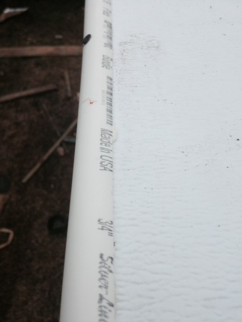

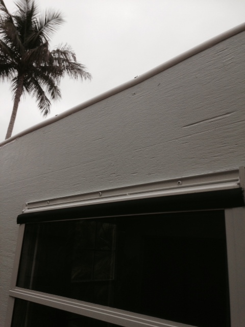

Postby Gold5one » Thu Jan 15, 2015 6:57 pm
I had an epiphany this morning as I was mowing my grass-
One of my unsolved problems was, "how to cap the edge of my roof and do it inexpensively", the Bob Henry way. ;)
A $4 stick of PVC pipe solved my problem.
I took a piece of 3/4" PVC pipe and ran through my table saw - I found that a 50/50 split was just right. I drilled 1/4" holes every foot, ran a bead of Great stuff spray foam down the center, flipped it over and centered it on the edge and screwed it down. I used the drywall screws I had on hand and I'll replace them with galvanized ones later. I also sealed all the roof panel edges with Sika Flex 212 RV sealant before I put the cap on. An hour later I trimmed off some of the foam bleed out. More Sika Flex 212 along the top edges and the final step next week is Dicor self leveling sealant over that. My roof edge is exactly 10ft, which works perfectly for 10' pvc water pipe. Has anyone done a roof this way before?
I installed the tail lights and backed up my car- plugged the connectors in and tested the lights-- stop, tail light, turn signal-- it all works! I still need to install the side marker lights.
I'm taking the family to Disney this weekend, so the project will sit until Tuesday.
curb side view
roof view-
Mark

Postby bobhenry » Thu Jan 15, 2015 7:19 pm
Now just use a little of the pvc cleaner and get the writting off of the pipe and it will look great.
