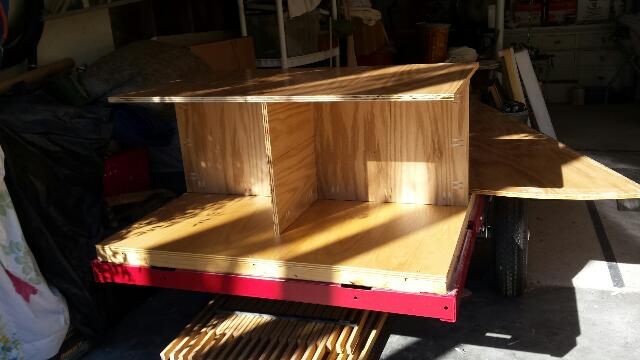

Postby Graniterich » Sat Nov 22, 2014 1:33 pm

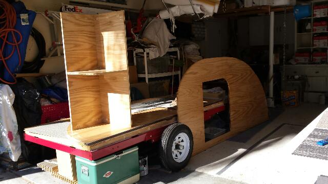

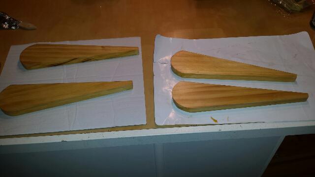

I dry positioned the galley both ways on Wall and floor, needed to sand the door bottom totally flat, divider was a tad bit high. Gonna make some spars out of this freebie, seems pretty hard

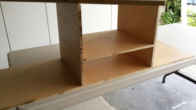

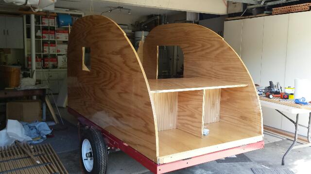

Postby Graniterich » Sat Nov 22, 2014 4:23 pm
I did not plan on this today, it just happened pocket screws only from in going into the walls, some pl urethane on edges. Deck screws through walls at bottom. It is rock solid. I am very pleased

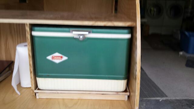

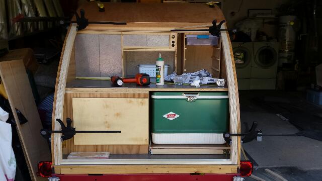

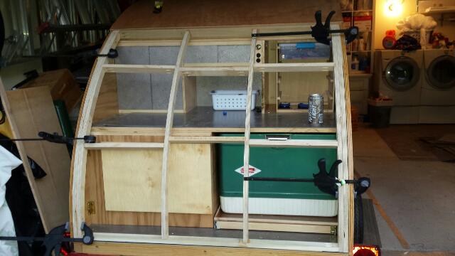

Today I got the front wall in, and started on upper cabinets. And the all mighty coleman fits on slide out

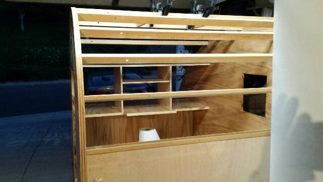

Re: Please to meet you, my name will be sugaree

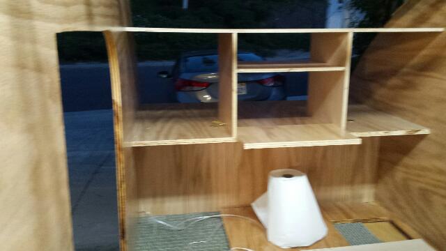

Postby Graniterich » Mon Nov 24, 2014 8:58 pm

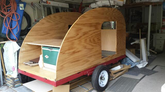

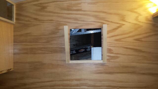

Got spars in, Pocket screws and glue. framed for roof vent not in current plan. Polyurethaned the upper cabinets, dry fitted for now. Center will be pull down shelf that is a pass through 9.5 x 16.5

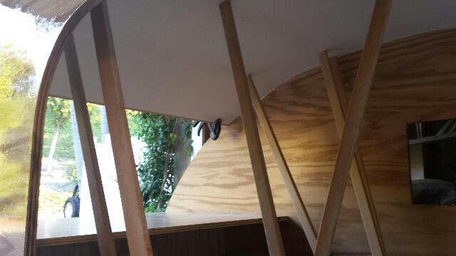

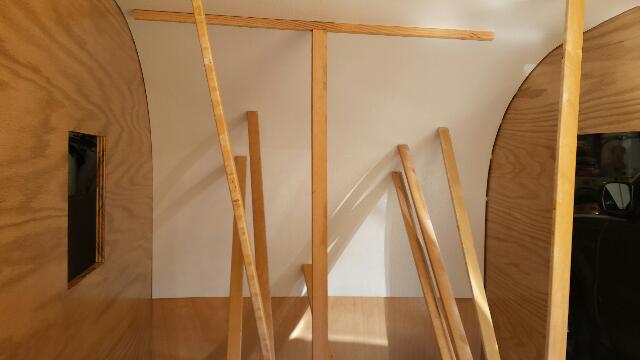

I waited two days for pl adhesive to dry on the last two spars the very back double oak spar is clamped, so call three attached. I was going to attach two more today, and wait two more days, and repeat. When I pushed up to pencil in the spar location everything was close to being in the right place, so I pushed it into place and penciled them all. Couple of tubes of pl, and some good luck. Happy Thanksgiving to all of you!

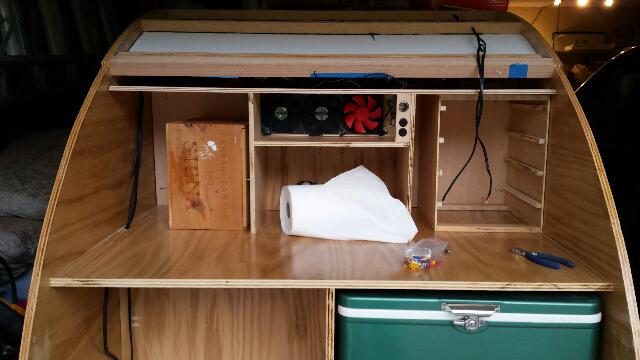

Postby Graniterich » Sun Nov 30, 2014 6:04 pm

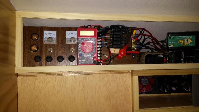

Got the electric panel in, and mostly wired for fans, Battery, house power, float charger, solar charger, invertor, cig power, but no lights yet,
I did get 120 to power strip from under trailer in weather proof box.

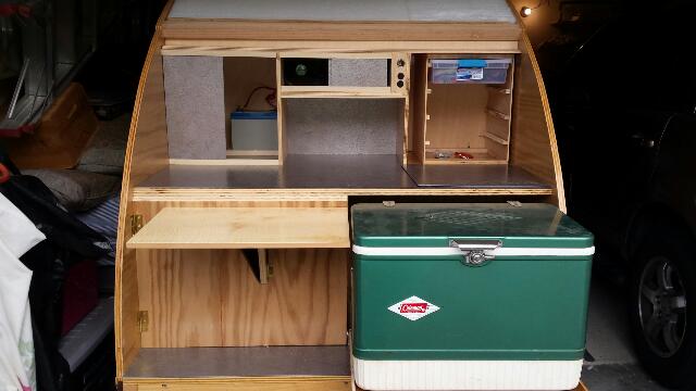

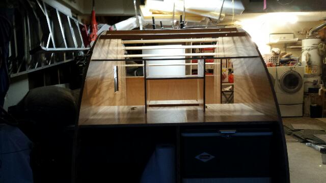

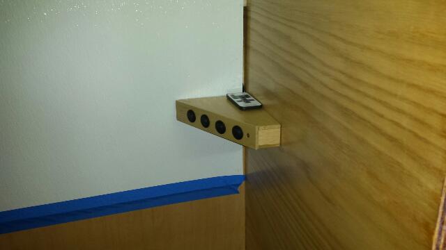

Postby Graniterich » Sun Dec 07, 2014 2:28 pm
Put down my counter top, and galley floor. Picture of bedside shelf with switches for internal and external led lights

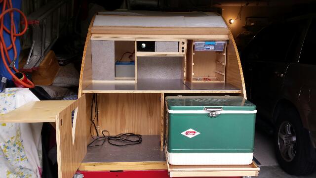

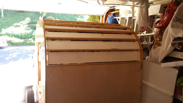

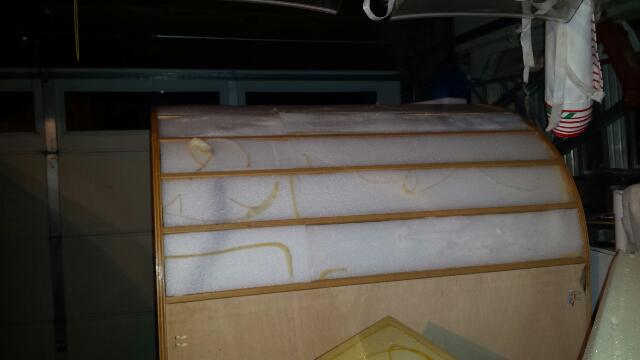

Postby Graniterich » Sun Dec 07, 2014 10:23 pm
Recycled polyethylene insulation from packing materials, lower r value, but free and in Southern California camping is mild.

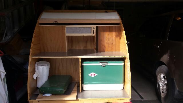

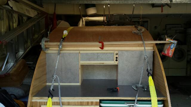

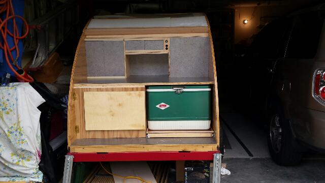

Postby Graniterich » Fri Dec 12, 2014 7:52 pm
Phase one of galley finished, very happy

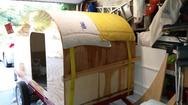

Postby Graniterich » Sat Dec 13, 2014 6:33 pm

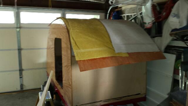

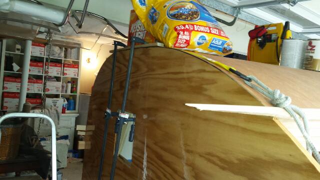

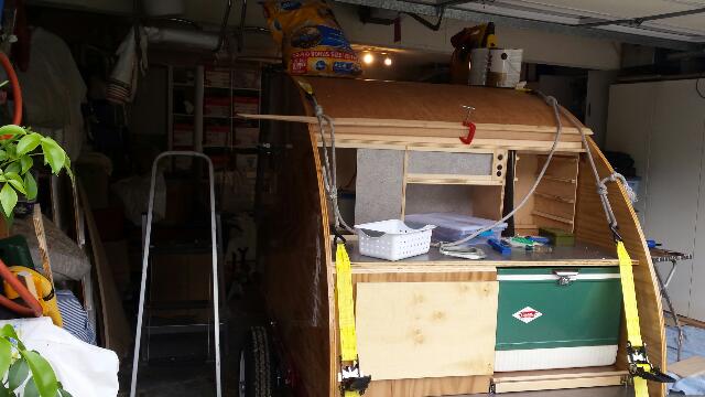

Today I got the eighth inch luan, put on roof, and put hot towels on it. The straps tightened up nicely. Not sure how long to leave it wet. Hopefully it will dry with the correct shape, I have heard of this as training the plywood

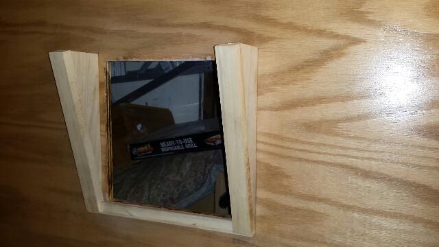

Haven't had a lot of time to work on trailer. Working on under door light (my alternative to porch light), finished interior led uplight fixture attachment, installed Reese swing down jack, and lastly attached wiley windows and made wedges.

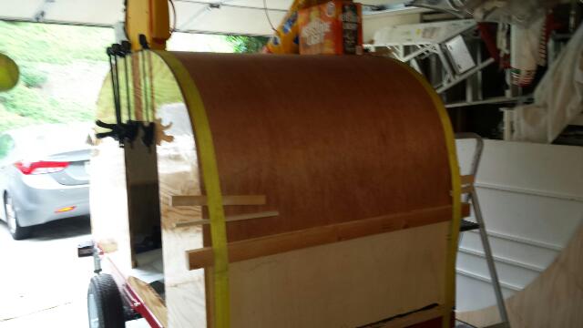

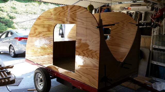

Postby Graniterich » Sat Dec 20, 2014 5:22 pm
Today was a big day! Put luan on the roof, only used pl adhesive. Straps and clamps holding down while it dries.
