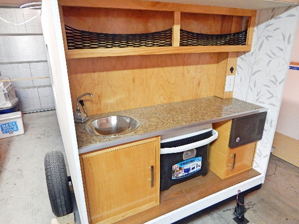

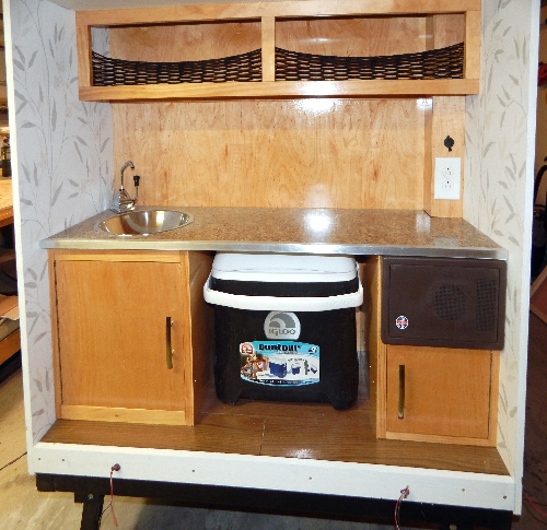

Postby TxDave » Sun Dec 28, 2014 8:28 pm
Well, Christmas is over, and its back to work on the camper. We pretty much finished the galley area this weekend. The lower right cabinets contain all of the electrical stuff including the battery. I was going for nice simple lines.

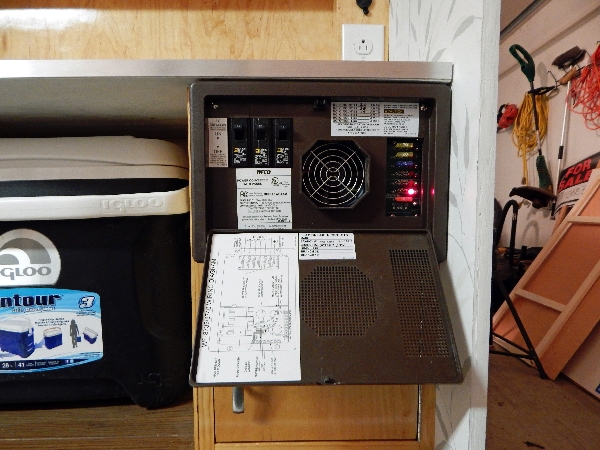

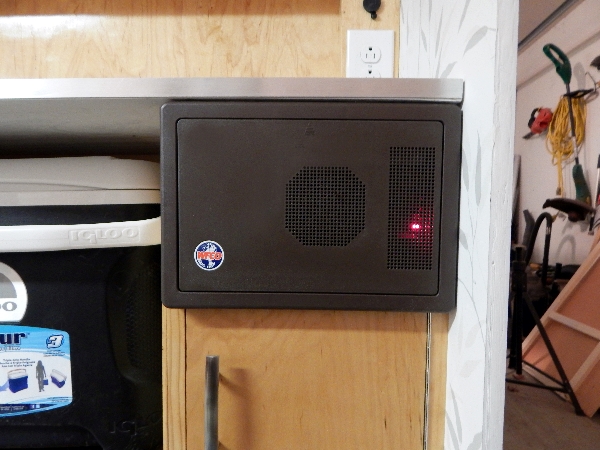

Postby TxDave » Wed Dec 31, 2014 6:29 pm
I finished my wiring today. Yahoooo! It always surprises me when I complete a relatively complicated task and everything actually works.
I used a WFCO power panel. It has all of the fuses and circuit breakers, and a 3-stage battery charger. Makes for a nice clean installation. The manual was pretty much useless for help with installing the thing. I relied mostly on the wiring diagram on the unit itself. The last photo is of my little helper, Lucy. She is a rescue who was dumped in a field. Weighs a whopping 4 pounds.
Hope everyone has a Happy New Year.

Postby KCStudly » Thu Jan 01, 2015 11:28 pm
Cute pup. I bet she is fiercely loyal.
Nice clean install on the power center, too. :thumbsup:

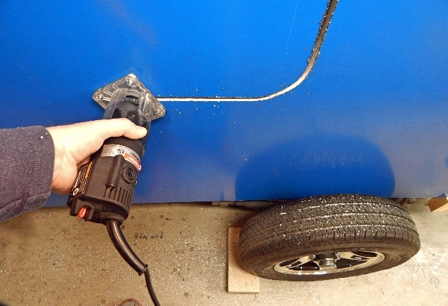

Postby TxDave » Tue Jan 06, 2015 1:29 am

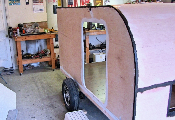

This little Harbor Freight 1/4" router is one of my favorite tools. I have used it on aluminum, plywood, hardwood, Formica, and Filon. I have a big Craftsman router, but 90% of the time I use this little one. In this photo I am routing out the opening for the driver's side window. Note: the blue prepainted aluminum is covered with a protective plastic coating. It is really bright and shiny underneath. Yes, I know I have been saying red aluminum skin. The wife won out on this, so I went with blue instead. Next one will definitely be red.
routing window2.jpg (247.58 KiB) Viewed 2761 times

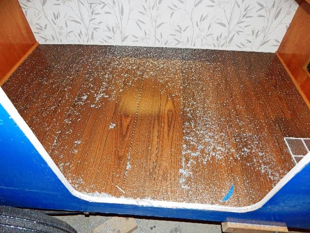

Unfortunately, using a router on aluminum creates an unbelievable mess. There were aluminum shavings everywhere.
aluminum dust.jpg (89.99 KiB) Viewed 2761 times

Re: New build in Temple, TX
Postby Graniterich » Tue Jan 06, 2015 9:53 am
Are you free handing that cut, never used a router before

Postby aggie79 » Tue Jan 06, 2015 1:37 pm
Graniterich wrote:Are you free handing that cut, never used a router before
I'm hesitant to comment since this isn't my thread but as a general rule you almost never free hand cut using a router only. You need to have some way of controlling the router while cutting. One way is to use a pattern/template and a bushing in the router base or router bit with a bearing. The bushing/bearing is held against the pattern/template to make the cut. My guess is that for the picture you were referring to the opening served as the pattern/template for the cut in the aluminum. Another way, to route in a straight line, you can use a guide as a fence. The outside edge of the router base is held against the fence to cut in a straight line. The last way is to use one of several types of guides that mount to the router or router base to control the travel of the cut. An example of the is a trammel or "compass" to cut curves or circles.

Postby TxDave » Tue Jan 06, 2015 4:38 pm
I used a laminate trimming router bit with a bearing using the window opening in the wall as a guide. Pretty much no way to mess that up. I definitely could not do it free hand.

Postby Graniterich » Tue Jan 06, 2015 4:43 pm
That is what I thought, free handing wasn't the norm. I see now that the door was probably cut, and was the guide. Thank you
