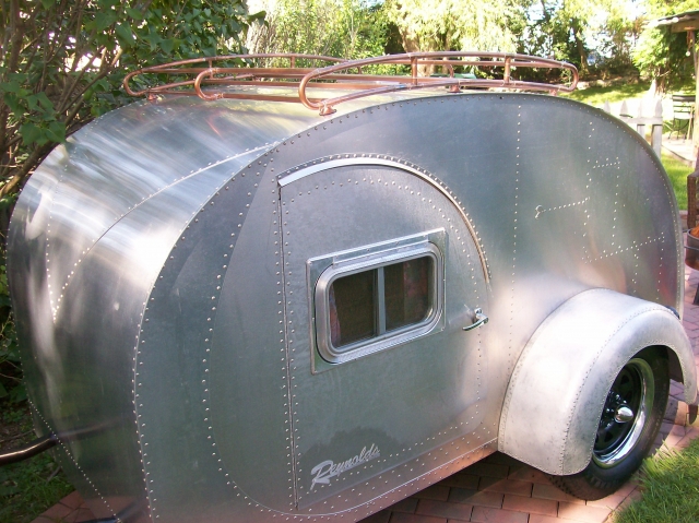

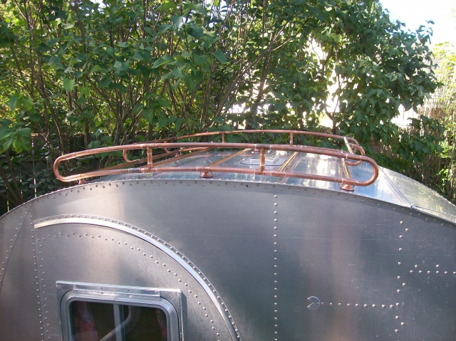

Postby bohemian » Tue Dec 04, 2018 10:35 pm
I thought I would share, I just came across an old pic of the trailer with the added copper roof rack on it.
