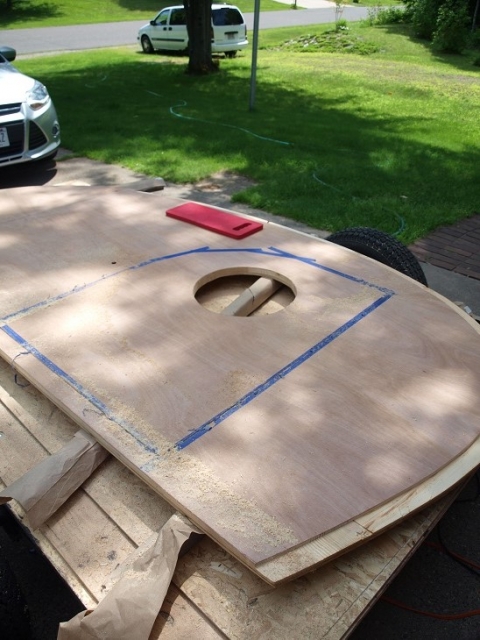

Postby TimC » Thu Jul 16, 2015 1:19 pm
Template on door area
Partial cut. I don't know why the straight hinge side doesn't look straight. It is.
All cut out
[imghttp://www.tnttt.com/gallery/image.php?album_id=3986&image_id=134192][/img]
Seeking advice on how to smooth the rough cut on the door @ viewtopic.php?f=21&t=63822

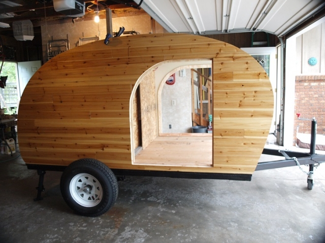

Postby daveesl77 » Thu Jul 16, 2015 6:22 pm
ABSOLUTELY BEAUTIFUL!!! We Need Woodies!
Mine is a slightly similar build. While I did not weigh my walls, here are the dimensions
long curve-curve = 120"
height from bottom of panel to top of curve = 60"
Wall composition is 1/4" ply inside. Framing I made from cut down 1x3 pine and half lapped all crossing members. Filled with 1" XPS foam board. Outer skin is 1/8" luan then covered with 3/16" resawn cedar strips. Door sections were laminated using solid plywood. Gluing method was TB2 on everything, including internals. I did not epoxy the outer ply (under the cedar), as it was coated first with 3 coats of progressively thicker TB2 between the ply and cedar and then the cedar strips have 7 coats of spar poly, starting from a 25:75 mineral spirits/poly to 50:50 to 75:25 and then 4 coats of full strength.
As to the weight, mine walls might weigh 100 lbs, but I doubt it as I had no real problem lifting them up onto their holding stations for mounting, so I would guess more like 60-75# each.
My total trailer weight, fully loaded and weighed the day before we began our 2,800 mile trip was 1,340 lbs. that included everything.
By the way, as others have said, expect to get a lot of waving, picture taking, pointing, smiles and gas station discussions while driving.

Postby Ron Dickey » Thu Jul 16, 2015 10:31 pm
:applause: whow your just trucking along.
I lived in Milwaukee for 13 years loved the green and the trees. I remember it rained a lot too. what you going to cover the body with to keep it dry. Just remember do not make it air tight or you may not wake up.
In the winter you could put ski's on it. :lol: looks like you have it well insulated.
Looks like you are running smooth. :thumbsup:

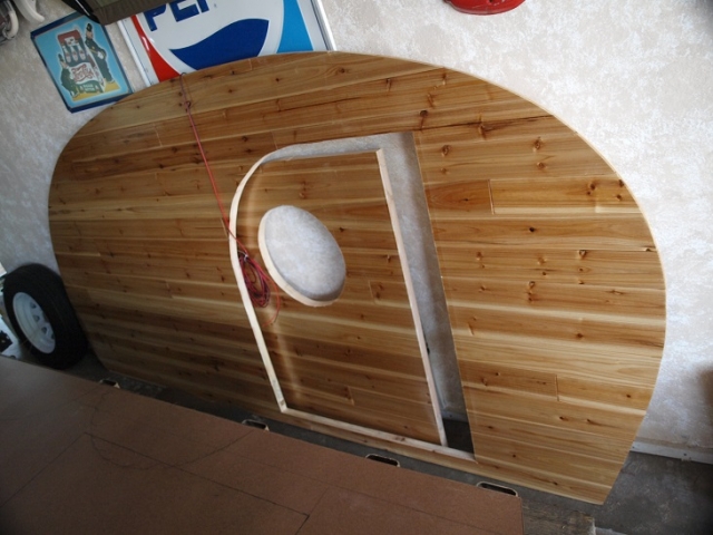

Postby TimC » Mon Jul 27, 2015 9:16 pm
Making slow progress. My wife had knee replacement two+ weeks ago and I am her primary care giver at the moment. She's recovering well and I get TD time increasing a little bit each day.
I will post more photos in a few days. The door, door windows and base coats of spar varnish exterior and paint interior walls are just about done. Doors gave me fits trying to frame in the jambs for the weatherstrip. I attempted to create templates to route smooth, fair curves on the door and frame, but, I ran out of material and patience to build the templates. Doors came out OK, but, I feel I will need to hide the wavy cut I made with some aluminum t-molding. Found some on-line for about $16 shipped for two 8' pieces of trim. Took a chance as ordering the deadsoft type with shipping was going to come to five times that cost. Hopefully this stuff will bend easily around a 18" radius. I've never annealed before. I don't know if I have the heat required to do that.
Once I get the walls attached I will probably have a million questions about skinning and weatherproofing with my PMF roof and woody wall transition. I'd like to find a PMF method to seal this joint as my budget is really busted. $30 a stick just to ship aluminum edging will make my head explode! Yeah, I live in the middle of nowhere as far as the TD world is concerned.

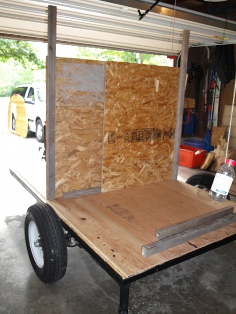

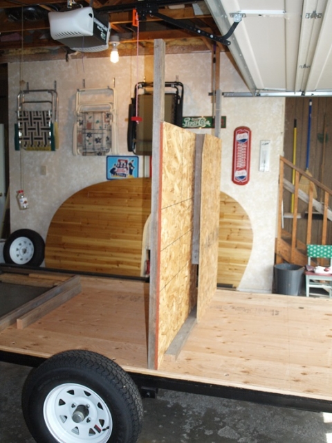

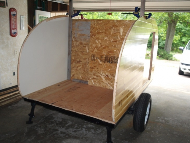

Postby TimC » Tue Jul 28, 2015 4:23 pm
First try at sizing up walls. Some adjustments to make due to changes in mounting position. Trim front and back of floor to match walls. Thinking of gluing with a DAP product I have on hand. It is DAP 3.0 Advanced Blacktop and Roof Sealant. It's from my last roofing job for sealing roof edges, flashing, etc.
Deadman in place
Wall fit test
Side view - I'm liking the Woody look a lot!
Next tasks...
Glue/screw walls to floor/trailer
Cut and seam and seal interior roof skin
Install interior skin and rafters. I think I will go with Kreg screws and Polyurethane glue for the rafters as they will experience alot of vibration on the road and I think Poly glue will absorb the road vibrations better than TBII. OR, maybe I'll go with PL300 as it stays flexible? E gads, this is like building a house... a bazillion decisions!

Postby TimC » Wed Jul 29, 2015 8:45 pm
sincere01 wrote:
TimC wrote:Decided to go with the cedar planks. 5/16" cedar T&G. I see most people putting on 1" (3/4") cedar T&G. Walls already weigh almost more than I care to lift by myself. Wondering what the average TD walls weight with all the different build techniques. Maybe I'll weigh them and post the final weight if anybody is interested.
I'd be very curious to know the weight of those walls if you can weigh them. I really love the look of that cedar and considering it for my build but am concerned about overall weight.
Scott, before I glued and screwed the walls into place today I weighed them without doors and door hardware (hinges, latches). The starboard side wall came in at 60 lbs. Heavier than most have suggested theirs weighed. I have a thread asking what other's walls weighed. ( viewtopic.php?f=21&t=63818 ) I'm thinking my whole build may end up heavier than I had hoped, but, that's OK. It's my first and I am learning quite a bit as I go. I'm not worried if it weighs as much as 1500 lbs. I probably won't be pulling this with my Ford Focus anyway. That was an original goal...
