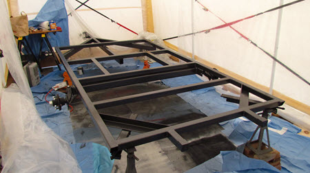

And yet another mistake, I was in the process of painting my frame with Hammerite. First I wanted to roll and brush the bottom and then spray the sides and top.
I rolled and brushed on a nice coat and let it dry. In the meantime my brother reminded me that Hammerite should be reapplied within one hour or wait seven days, darn! Then I read the can and the brush on type requires reapplication within four hours or fourteen days, crap! :x
So I went to work on my walls and let it sit for fourteen days. I finally got the second coat on the bottom and three coats on the sides and top. It's done and I'm a happy guy.

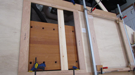

In the meantime I'd started on the "inner spacer wall". It will be a "Swiss Cheese" type construction out of 1" X stock.
There again I screwed up and bought the wood at Home Depot. I carefully sorted through the pile and brought home what I though was some "pretty good" wood. Turns out that it wasn't "good enough" so off to a real lumber store. I got all the clear hemlock I needed and finally got started, $250's later.
So far I have the door frame rough-cut and will trim it to within 1/16" - 1/8" of the pattern before I flush-cut it.
Here are the two door frames, one in place and the other drying.
I'm making progress and feeling good about it.
