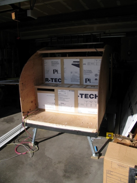

Postby flyguide » Sat Oct 31, 2015 5:04 pm
I really ripped it up today. Insulation DONE. I even had enough time to mount the hatch.
Next the bulk head and convertor

Postby bdosborn » Sat Oct 31, 2015 7:12 pm
tony.latham wrote:Image
Tony,
That bulkhead sure looked familiar and then I remembered where I'd seen that before. My teardrop!
