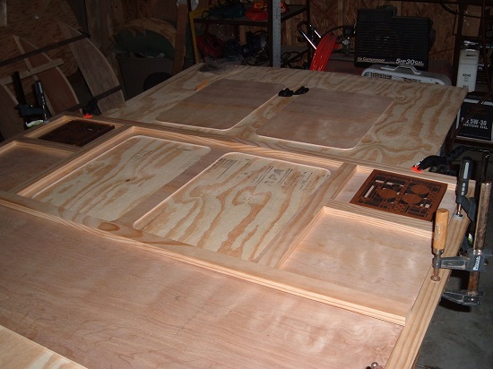

Spent today on my headboard bulkhead and front cabinet sides. The headboard will have a group 24 AGM battery.
I have planned the battery and spare tire to be inside the trailer. Just want the clean exterior design lines. No boxes, tires, bottles, or what not on the front of this tear.
Tomorrow I am going to work on the oak hatch spar beam and hatch hinge. I have a 6ft aluminum piano hinge, a 10ft strip of 4" wide neoprene rubber that I am using. While working on the tear I saw a good way to get a good sized oak beam as the leading hatch edge. I'm anxious to try. So that will be for Day 3.
Side note: Been working with a hanger on of a week old chest cold. Lottsa coughing and some missing energy.
headboard
All parts cut-half glued up-more gluing tomorrow
headboard-teardrop-headboard closet and battery box

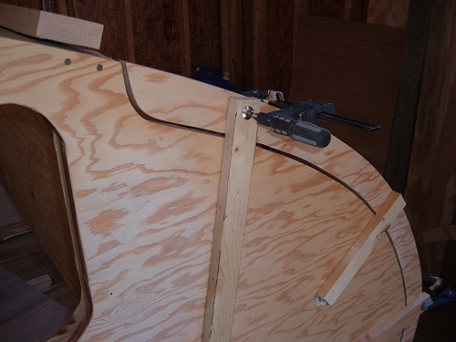

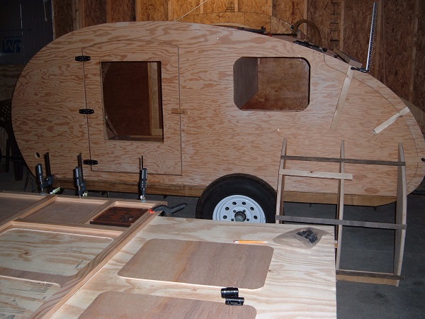

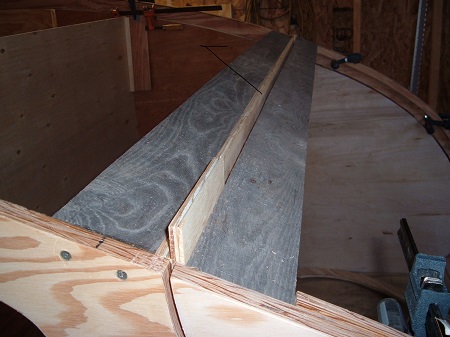

Spent the morning of Day 3 fitting my hatch sides to body. Did both sides. Still lot's more fitting work to go. I'm getting tired of it. I'm also getting better at it. So a fair trade off I guess
Fitting exterior hatch side
Angle cut oak beam for leading edge of hatch to body, notched hatch seal lip to accept beam, fit up with spacers to allow for weather strip
oak hatch beams fit and spaced for weatherstrip

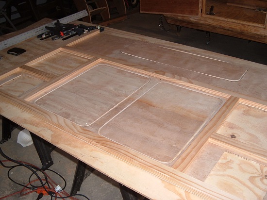

Finished gluing headboard bulkhead together and trial fit it in place
front bulkhead trial fit

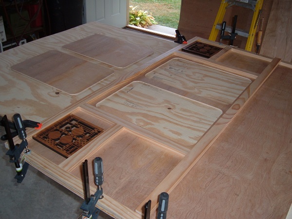

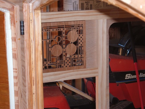

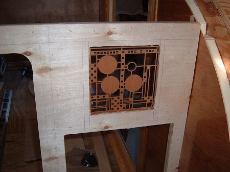

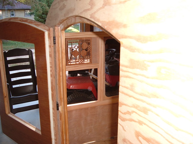

The things in the corners of the headboard are laser cut hardwood panels. The are copies of a section of Frank Lloyd Wright stained glass window. They are sold as hot pot trivets for your table.
I'm going to stretch fabric across the back of them and back light them. They are my new lampshades for the interior.
I've also removed the panel below my new lights. That is going to be a cubby for cell phones, water bottle, books etc. One on each side of the bed. The cubby will be down lit from the lamp above.
Cutting out those openings was the end of Day 3. Day 4 will see more front bulkhead work. A large lower hatch for electrical access is up next. Then fit the back half of the battery/closet cabinet to this bulkhead.

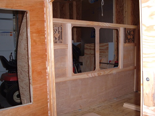

A long day of the "F" word. Fitting, fitting, and more fitting. All on the bulkhead headboard. Got the upper doors fit. Cut a lower electrical service hatch and fit it too. As I did all that I realized, there is lot's more work to this panel.
I have 110v outlet boxes to install. Also 12v light dimmer, cell charger stations, and more to be fit ( there's that word again) to the bulkhead. Along with attaching it to cabinet, then stain and poly coat....I'm a long way from done on this panel.
Building from the inside out is so much better. Way easier to do this work flat on the bench than installed in the camper.

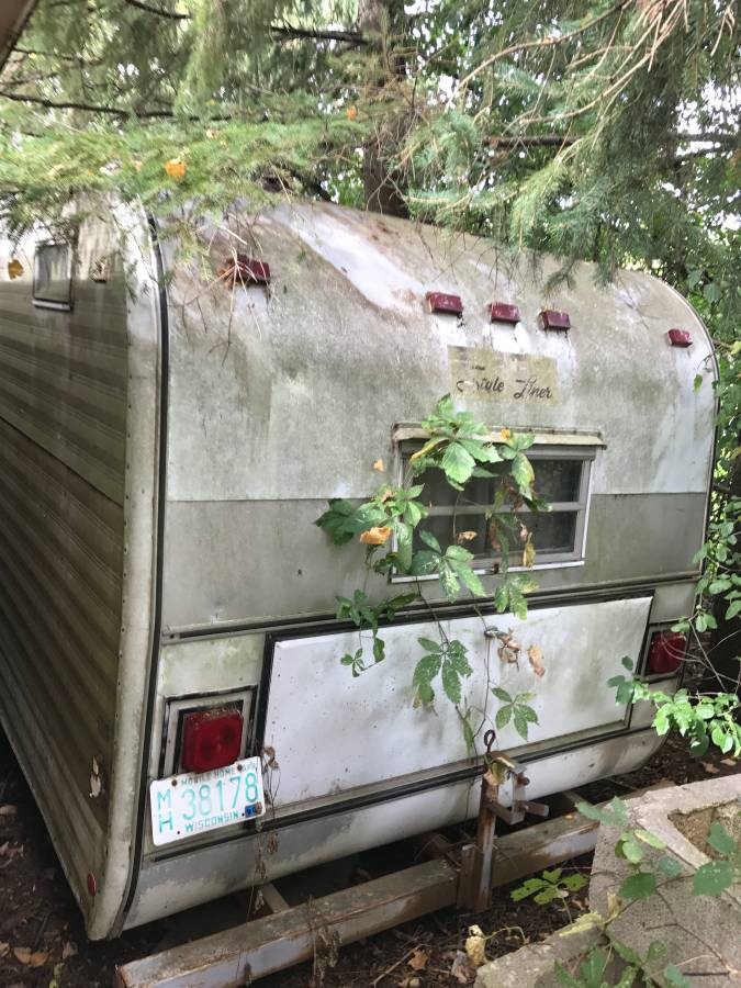

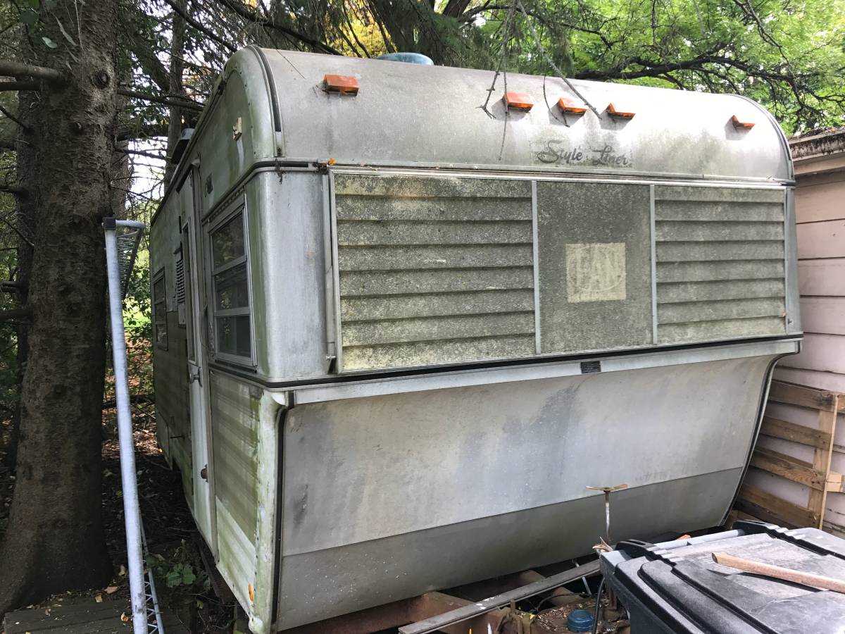

Also have a side trip planned for today. Going to look at another moldy oldy camper. I had an awesome canned ham camper years back that I had to sell at one point in time. I have been looking for some time. They have gotten nuts with prices. So we shall see if this is the one or not. I am still gung ho on the tear. I won't start work on the other till the tear is completed. However if it's the right one, at the right price, I have the room to park it at my house. We shall see.
Couple shots of the prospective camper

As I had feared...I am now the proud new owner of a 1968 FAN Style Liner camper as seen above.
It is an awesome collection of vintage parts in great shape. So going to park it in the yard. Then back full steam ahead on the teardrop. When the time is right I will have an awesome starting point for a very cool standie trailer.

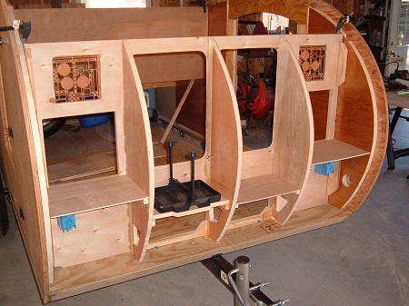

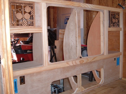

Still chipping away at the front bulkhead cabinet. Got the components for the 110v and 12v wiring in place. Attached the front closet/battery cabinet to the bulkhead for good. Have 2-3 more shelves and 2 lower wiring panels to install in that cabinet yet.
What a time sink this has been. Lots of fussy details to it.

As I work on it you can feel the whole structure get more solid with each new structure added to it.
It got a lot stiffer with the new front cabinet mocked in.
