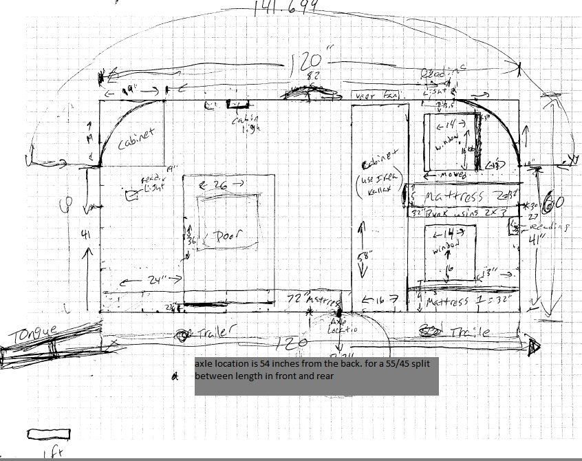

Postby mariannf » Tue Dec 29, 2015 12:43 pm
5x10x5 driver side profile axle location corrected.png (191.19 KiB) Viewed 12668 times
here is the sketched plan for this build; driver's side profile with the axle location corrected.
Notes: No galley instead have bunk beds. Will have tongue box with deep cycle battery and fuse box and ground block for 12v system. Wiring will run behind vertical cabinets. Considering the "super simple" 110v AC electrical, with external port accessed through bottom of vertical cabinets http://tnttt.com/viewtopic.php?f=30&t=37732&start=15

Postby S. Heisley » Wed Dec 30, 2015 8:00 pm
:o I didn't realize that you were going to build bunks!
Just a thought....You might consider adding a tad extra framing on one side wall at the foot end of the bunks. That way, if you want the length of your bunks to "grow" longer, later, you'll be able to add a pull-out foot well because the needed bracing will already be there. Or, you can purchase small, pre-made, locking cargo doors and install them now. Then, you'll just need to add the fold-out foot platform when you need it.
Posts: 8866

Postby mariannf » Wed Dec 30, 2015 11:55 pm
S. Heisley wrote::o I didn't realize that you were going to build bunks!
Hi Sharon, great idea! I was thinking about what would happen when my girls outgrow the 60" wide bunk. I will probably go with the extra framing at the foot end.
I plan to do a window at the head and foot end of the bunks so the girls have a cross breeze, and the fairly small bunk space will feel a bit more open.
both the driver and passenger will have the same profile for the most part. Windows and two doors coming from Vintage Technologies.

Postby noseoil » Thu Dec 31, 2015 8:31 am
I'm curious about the 16" cabinet at the foot of your mattress area. How does it open & close, & or, how does it divide the space between the bunks & main sleeping quarters? Interesting design & layout!
137905
noseoil
Posts: 1822
Images: 670
Re: First build Sacramento 5x10 Rimple design
Postby KCStudly » Thu Dec 31, 2015 9:20 am
I assumed that this was akin to a closet or garment hanging locker, and would not extend the full width of the camper; maybe just standing against one wall and coming out about 18 inches where their feet would be. Still plenty of room for a child to tuck into. A lot of commercial campers have kids bunks that aren't fully open like this.

Postby S. Heisley » Thu Dec 31, 2015 1:00 pm
KCStudly wrote:I assumed that this was akin to a closet or garment hanging locker, and would not extend the full width of the camper; maybe just standing against one wall and coming out about 18 inches where their feet would be. Still plenty of room for a child to tuck into. A lot of commercial campers have kids bunks that aren't fully open like this.
Okay, now, KC and noseoil have got me thinking.... I didn't notice any lights by the bunks...? Rather than putting the cabinet at the foot, if you put it at the head, the girls will be shaded from the overhead light and from your reading light, should you want to have it on while they are trying to sleep. Then, if you mount a small bunk light on the bunk side of the cabinet for each bunk, the girls can turn on their lights without bothering anybody else, too! (The cord to these lights can be encased in a protective shield that just snaps on.) Each child could even have a small shelf under her light, to hold a paperback, phone,glasses, etc. I find that a little 3" deep shelf is sufficient for that task. Of course, for all I know, you may have a cabinet on each side. Are you are going cook at a picnic table or build a grub box?
Postby S. Heisley » Thu Dec 31, 2015 1:03 pm
:thinking: I see them now, after I've posted. :roll: You do have reading lights for the girls' bunks; but, you have them in two different places. However, if you put both on the side of the cabinet, it would simplify your wiring somewhat.
Postby S. Heisley » Thu Dec 31, 2015 4:41 pm
:thinking: Something about the door placement bothered me; and, at first, I couldn't figure it out.
Then the light bulb went on. For the kids to get to their bunks, they will have to crawl over two thirds of your bed area.
Are you okay with that?
The other thing making me scratch my head is whether your axle placement is going to be correct. The reason that people move their axle further back from its original position is to achieve a proper 60/40 balance, with around 60% of the weight in front. If you haven't already done it, you can calculate your trailer's balance using Andrew's software program, here: http://www.angib.pwp.blueyonder.co.uk/t ... tear81.htm Because you won't have a galley in the back, you may not need to move your axle back. If you need or want to change your axle placement, it should probably be done now, before you attach the cabin sides.
Further food for thought is that you might be able to turn your floor plan around, putting the bunks in the front and the door in front of the axle. (I haven't tried it as I don't know where your axle is or should be....It's just a thought.) This might mean that the kids would climb in at the foot of your bed instead of the middle, which could be an advantage for everybody.
All of the above may be unimportant to you as you may already be totally secure in your design; but, one never knows when a thought or idea may hit that has merit.

Postby mariannf » Thu Dec 31, 2015 5:36 pm
noseoil wrote:I'm curious about the 16" cabinet at the foot of your mattress area. How does it open & close, & or, how does it divide the space between the bunks & main sleeping quarters? Interesting design & layout!
Hi KC and Noseoil,
I am thinking of using this cabinet on both sides: http://www.ikea.com/us/en/catalog/produ ... VgFNR6NDtR
You will see that it is open face and insert drawers are available. I don't have any real woodwork experience so the short cut of buying the cabinets is appealing. you will see it is approx 16x57x16. the overall interior length of the TTT will be 117 inches.
I am looking at this fold up bed/sofa http://www.thefutonshop.com/Folding-Foa ... ull-Double
You will see it is 54x75.
I'd like to make the bunks 32 inches. so my simple math (75+16+32= 123) means it won't all fit down the length. I am thinking of "cutting out" some of the foam at each of the bottom corners of the bed. that would mean a cut of about 6x14 to each of the bottom corners. i saw in some of the build threads that folks did cuts to their mattress to go around or over wheel wells.
What do you think, any alternative ideas?
When the bed is folded up we will have a good amount of room to sit/play if need be, and when the bed is folded down there will about 10 inches of floor space between the bed and the bunks.
I would like to keep the bunks as big as possible so that my girls will use them for as long as possible, they are 1 and 4 now so I should get several years until they really don't fit.

Postby mariannf » Thu Dec 31, 2015 5:41 pm
S. Heisley wrote::thinking: I see them now, after I've posted. :roll: You do have reading lights for the girls' bunks; but, you have them in two different places. However, if you put both on the side of the cabinet, it would simplify your wiring somewhat.
Thanks Sharon, another great idea about mounting the bunk bed reading lights to the closet at the head (I am planning one for the head and the foot). it will make running the electrical easier!
