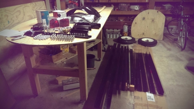

The Ironton 5 x 8 arrived today!
It's a little scuffed and dinged, so I think I'll paint it after assembly. BobHenry, in an older thread (http://www.tnttt.com/viewtopic.php?f=35&t=62659&hilit=should+you+paint+your+trailer), recommended Van Sickle tractor paint as an economical and effective option, so I think I'll give that a go. I was going to be stingy and just spray on a single coat, but there's probably not much point painting at all if you don't give it 2 good coats, so I'll be thorough.
Am I right in thinking that painting is a nice extra, rather than a necessity? I'm planning to do it, but more from a due diligence perspective than because the already-painted trailer seems like it really needs it. Per the thread above, I'll sand with ~320-grit sandpaper and wipe down with alcohol for prep. (Does it have to be denatured? Regular old isopropyl won't do the trick?)
It's a bit late to get much accomplished tonight, but hopefully I can make some progress Friday evening.

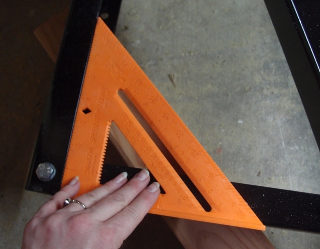

(1) Don't tighten the nuts all the way until the whole thing is assembled, that way you can adjust it if it's not perfectly square
(2) Confirm squareness in one or more ways:
(a) Use a T- square or L-square on every corner
(b) Measure diagonally from each corner to the opposite corner--the measurements should be equal
(c) Measure from the tongue to the center of each wheel--the measurements should be equal

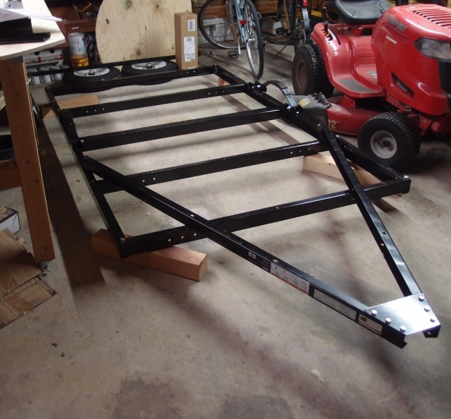

Re: Little Ferdie - 11-ft Grumman: TRAILER FRAME ASSEMBLED
Postby plectrudis » Fri Mar 04, 2016 11:57 pm
(Mostly, anyway.)
And, best of all, it is square!
Image.
It took roughly 2-3/4 hours, with Mr P lending a hand part of the time. It did help that he has an inexplicably extensive--not to say redundant--collection of socket sets.
Tomorrow I'll give it a light sanding and a couple coats of tractor paint and, hopefully, add the remaining parts--the axle, wheels, hitch receiver, and jack.

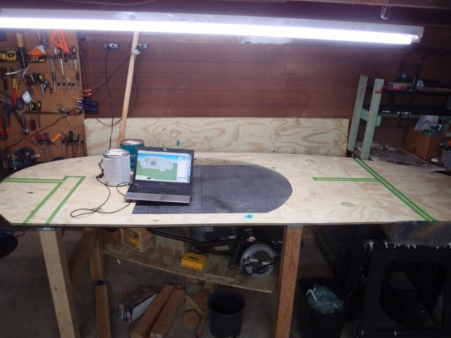

Today's progress:
I ran into some problems tracking down the materials I wanted, which took a stupidly long time, but I eventually got the bottom of the trailer painted and one coat on the top, so that's close to being done.
And while I waited for the paint to dry, I taped the outline of my cabin interior, which was gratifying. I couldn't help but think of the Silver Beatle thread and Tom's love of blue tape...
One more coat of paint, and then I'll put the trailer together the rest of the way and start on the floor.

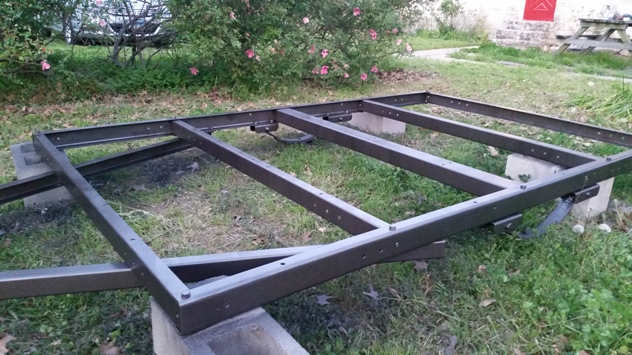

Postby plectrudis » Sun Mar 06, 2016 9:55 pm
Thanks for the suggestion, Pete-- I'll take a look once it's dry. At the same time--dangit! A whole other dimension to think about just when I thought I'd nailed it (goof-up with the washers notwithstanding). Constant vigilance! as Mad-Eye Moody says.
Raced the sun back from Houston this evening and got home just in time to put on the last coat of paint. Remaining trailer assembly tasks will have to wait till later this week or next weekend.

One freshly painted trailer frame:
