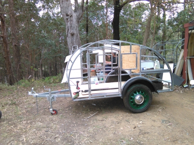

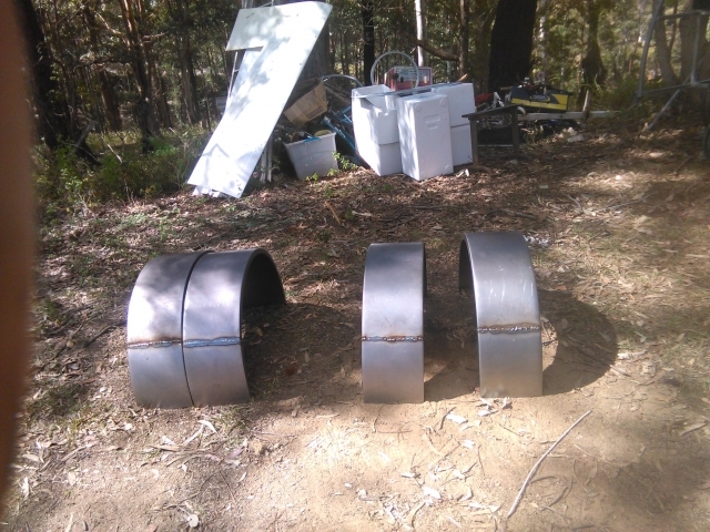

For tear 002 and 003 I have taken commercially available trailer guards and by using one extra one as a source of correctly curved sheet metal extended each of them by 10 inches this makes them the needed half circle of coverage
Image Description
The next step here is to make a piece that properly covers the "inside" and to do this I have an old steel door that will be cut up and the plug welded to the guard's inside flange :D
Today's assignment is to make a square steel frames for the windows that go in the doors and the walls and to relocate a couple of noggins in the roof frame to suit the vent that I have decided to use, relocate the tube that the rear hatch closes against ect ect I want to get the frame welding finished so I can move onto fitting the floor and starting on the lining and the fun part which will be the fit out

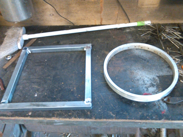

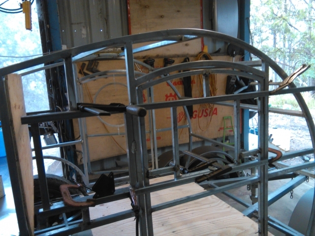

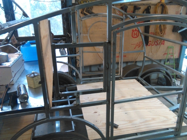

Managed to make four and fit three of the window frames to my Tear
Image It may seem strange to have square frames for round windows but as the glazing will be embedded in the walls it will work out fine
The first frame in place
Then I clamped a couple of pieces of tube to the frame to ensure that my windows would line up
the door frame
and the side view which looks good to me even with square window frames! :)

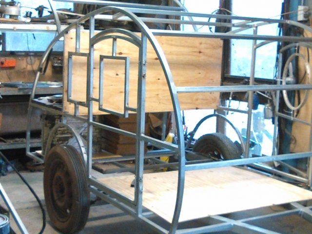

I have finally started playing with wood, something that usually gets folk around here quite excited :D
first though I fitted tyres to my freshly painted rims and fitted those to the tear along with the Guards that have had undercoat and one coat of black
I have also attached the floor now after giving the bottom of the 12mm ply two coats of Gloss acrylic paint I attached it to the frame with several hundred screws (one every 4 inches!) I have used a piece of ply as backing for some PVC sheet that I scored on the Galley bulkhead

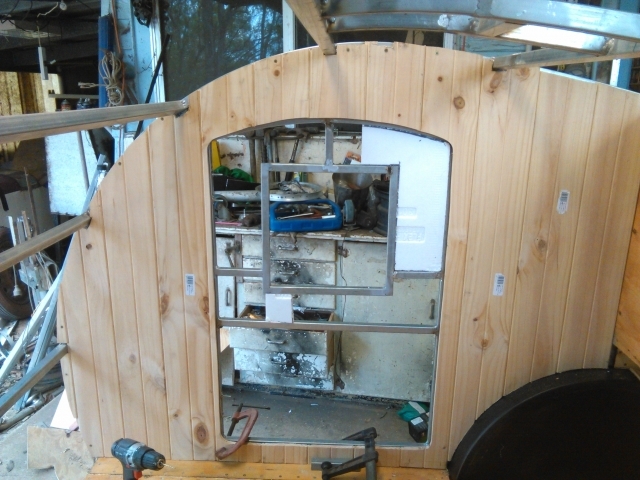

Imagefor the sides of the cabin I am using pine lining boards which do not work out to be that much more expensive than good quality ply but they look really swish in my opinion and even more so once I have stained them.
Image The door will have an inner skin of thin ply so I can get away with using the lining boards to form the lip around the door opening At this point of time the boards are not yet glued to the steel frame because I am not going to do that until
i have routed out the round openings for the side windows

Just a simple update as I work through doing the interior like this picture which shows how I used the router to make the round openings for my windows
and the finished result looks great!

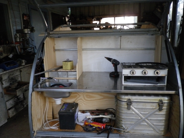

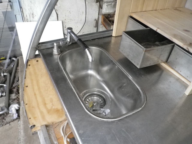

Every kitchen needs its sink and I got this one by buying a double sink off eBay for $25 and then carefully cutting out the smaller bowl Then I drew around it with a sharpie then drawing a second line inside the first to account for the flange
To cut a hole in the stainless topped bench I had to first cut through the metal with a cutting wheel on my grinder and then use a chisel to remove the metal and then I used my jigsaw to cut through the ply underneath, a bit of finessing with a grinder ensures a perfect fit The bowl will be attached with silicone and the bowl will be weighted while the silicone cures. In the picture is also the spigot I intend to use which will be placed so that it can either be over the bowel or over the edge of the bench to fill a pot or kettle that won't fit in the bowl.
The Car battery that I have here will power the LED lights my radio and my TV. I am well aware that a car battery is not ideal but it is what I have, its in good order and it will do for now. My plan is to make two cupboards under the bench the one where the battery sits will also have a pump for water and other electrical stuff like a battery charger and a 240 volt input for shore power

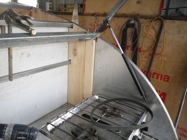

This should give a good idea of how my Galley layout is evolving The area behind the sink is going to hold my plates and bowls on the shelf above the flatware drawers there will be another shelf at the level of the 20x20 cross bar and this area will be for cups and drinking glasses. The plan is to have two more shelves in the area between the stove and this "hutch" which can be used for storing dry goods, rice, tea, sugar and spices, there will be a space behind the stove which will be good for pots and pans and a further shelf above that for more dry goods.
There will also be a bit more pantry space below the counter between the utilities cupboard and the cooler
I am very pleased with the way that the sink has turned out it really looks the part and I am sure that it will do the job perfectly well likewise I am well pleased with the stainless trays that I scored form my brother's scrap pile they should be perfect for cutlery and kitchen tools I am as yet undecided if i will add wooden fronts to them whcih would make them look more rustic
The boards really finish off the stove end of the gallery very nicely and they will look even better once they have been stained and varnished like the rest of the lining

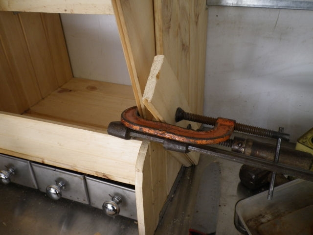

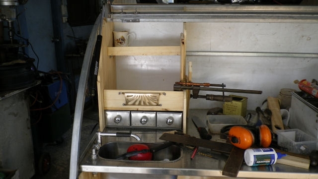

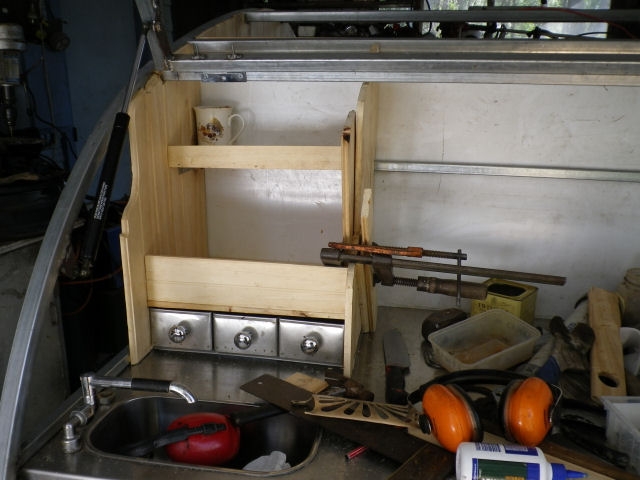

Postby Iain Hall » Sun Oct 02, 2016 2:04 am

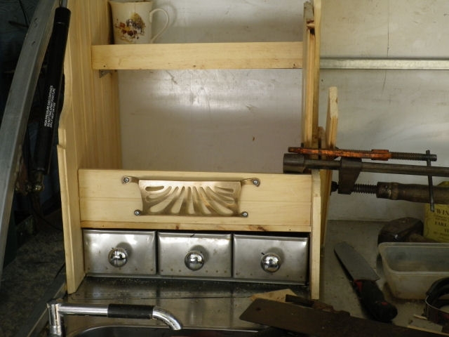

The plan is to have all of my plates and bowls fit in the lower section and cups and Glasses on the upper shelf
Don't my little drawers look good now they have knobs on them?
I picked this little Brass panel up at a swap meet for a couple of bucks t serves absolutely no practical purpose but I like it anyway
The clamps here are holding a wooden scabbard for my kitchen knife that I have glued onto the side of the hutch
