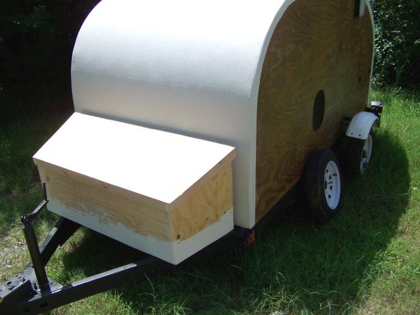

Postby stephent » Sat Jul 15, 2017 7:45 am
After some thought and hail pecks bad enough to cause the elastomeric roof coating to seep some water under the coating :( ..I decided to PMF the top. I like the looks of the canvas weave slightly showing in the paint. And this front mount chuck-box which is in process of getting it's PMF put on. I have begun to wonder if the construction of a teardrop ever ceases? lol

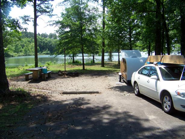

I went camping west of Clarksville, Ar at a lake for a day..caught 8-9 pounds of catfish (2 fish)...got poured on by rain....slept like a baby in the teardrop.....then up to NW Arkansas to see some family and from there up to Joplin (7th St.) and picked up old Route 66 west.. through Kansas...then down in Oklahoma and along that last 15 mile remnant of the old 9 foot wide "Ribbon Road". That was a dusty gravelly thing to drive. It has what I think is some rather dusty SB2 fines or something gray-ish/white and extremely dusty all over most of the remaining 9' wide highway. Still...I did drive along some historic highway. I went way more down on old 66 and then doubled back a ways and took the route down Hwy 69 and hwy 59 down along the Neosho River..purty there.. lots of canoes and kayaks.. And some nice purty scenery. :)

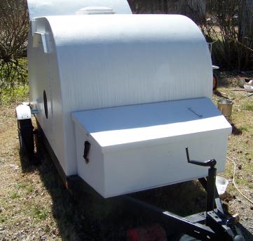

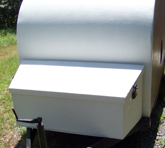

Postby stephent » Wed Aug 02, 2017 2:00 pm
Got the chuckbox installed today, It is PMF'ed like the teardrop top. That brought the teardrop tongue hitch weight up to 120 pds....up from 104pds before. I gotta watch what I put in the box now. Can't exceed 300 pds. Guess I need to go find the local truck scales and weigh the axle weight to get the balance again. I probably will need the extra storage here in a few weeks.....plans pending and not wanting plans of mice and men to go aglee

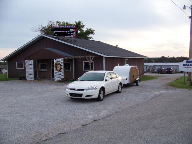

I slept like a baby in that cooled down 62 degree air Thursday nite.. :) I hit about every fleamarket and yardsale I could get the car and teardrop turned around in their drives on the way back.. I found the big pressure canner I had been looking for and at a decent price too! And it had the canning basket inside it too! I made a normal leisurely 4 1/4 hour one way trip into an over 6 1/2 hour trip...lol And found some more "treasures" as well..
Cooked Italian sausage pasta and garlic bagels (don't ask even..lol) for dinner ...supper to us hillbillys.. for me and my daughter...and my ex..and later my son and his new squeeze. when they showed up. Then a sausage gravy and biscuit breakfast Friday morning when my daughter showed back up to open the flower shop up...but after a leisurely few cups of coffee and some serious appreciation of a fine morning to be alive in......all In my teardrop galley.
I had a blast over all of this trip....needless to say. :applause:
I blacked out the florist shop name so I wouldn't post a shameless plug for my daughter...lol
