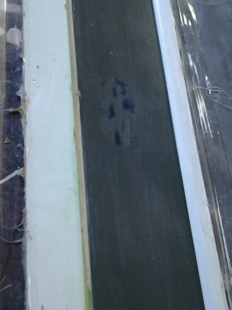

Now that you have made the outer shell time to add the foam. When you add can foam it is used to bond and inflate. The foam needs a gap to flow right and have no voids. A 1/8-inch will be great.. I have found by resting a little of the foam block on the tab works. Then add one layer of fiberglass mat over the foam with all paper removed. This is for better bonding. Do just one layer at this time. If you have a blowout from the can foam better to have on the inside. For me I made the blocks 203mm long. Eight inches long.
After inside mat has cured. Drill small holes between each block on the inside. YOU MUST add can foam where the void is vertical. Bottom to top. Just flip the shell. Remove extra foam. Add one more layer of mat to seal foam.
