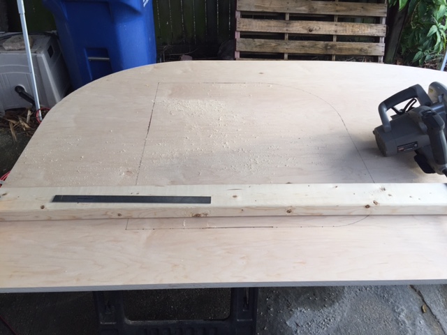

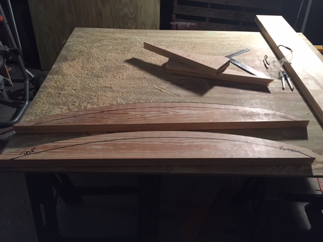

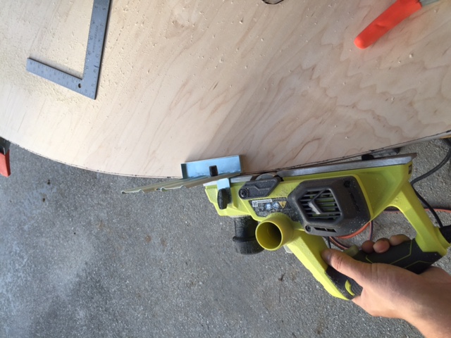

After a lot of contemplation I decided to use an electric planer to square the panels for my sides. I didn't feel like the pattern router bit would accomplish the job as it was off square on the upper and lower boards in different areas. Also I have not had the best success with a router in previous small projects, didn't want to chance it and eat a huge chunk out of the side

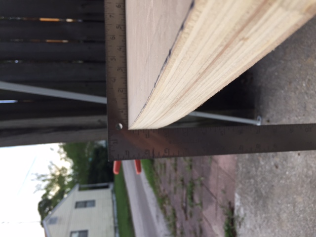

I attached the guide to the planer and kept it flush with the top of the panel. (Pic 1) I set it to take of 1/48th" each pass. I worked about a 1 foot section at a time. There was a slight dip in the roof section due to the jigsaw blade tilting in during the cutout, I was able to smooth this out and blend it in to the rear and front curve. All in all I only lost 1/16th" off the height. I thought it was going to be much worse.

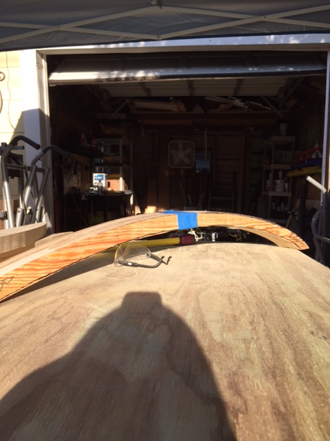

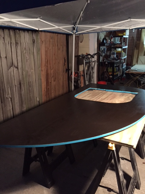

Best way to eat an elephant is one bite at a time. After multiple passes & constantly checking I was able to get it dead on! (Pic 2).
I took the quarter panel sander after this with 80 grit and smoothed the edges down. I will hit the edges with a finer grit before I stain and seal the sides. Really happy with the way they turned out, every man can appreciate a nice set of curves! haha (Pic 3).

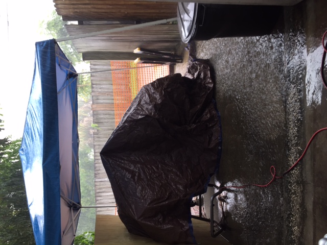

Made it out to the garage and set up shop, then it started to rain. I waited it out in the garage and decided to do a little prep electrical work. The wires for the DC power that come out of PD 4045 are quite short so I added a 12" extension to each one. My breakers came in so I fit those into the panel as well.

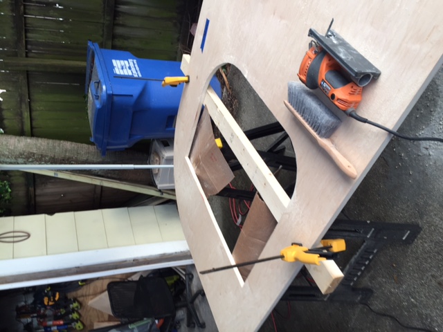

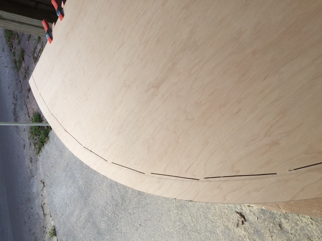

The rain finally stopped, I set up the first panel. I already had the door location marked from when I marked my profile. I made a plunge cut on the top, bottom and left side. It took me a few minutes to get my guide board set up properly. I was measuring the distance from the blade to the end of the guide. I could swear I was measuring correct. What I didn't realize until a bunch of back and forth ......was that the small square I bought is an architectural square with different measurements on each side, so I was measuring in 1/8th's on the saw and then 1/12th's on the board :oops: Pic 1 shows the guide board set in place for my plunge cut on the bottom of the door opening.
I had to do the plunge cuts as I am using the the cutout wood for the doors themselves. After the plunge cuts I used my jigsaw to cut the door out the rest of the way. Slow and steady.

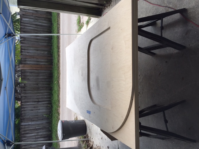

I clamped a board underneath the door so the door would not sag and fall to the ground once I completed the cut. (Pic 2)

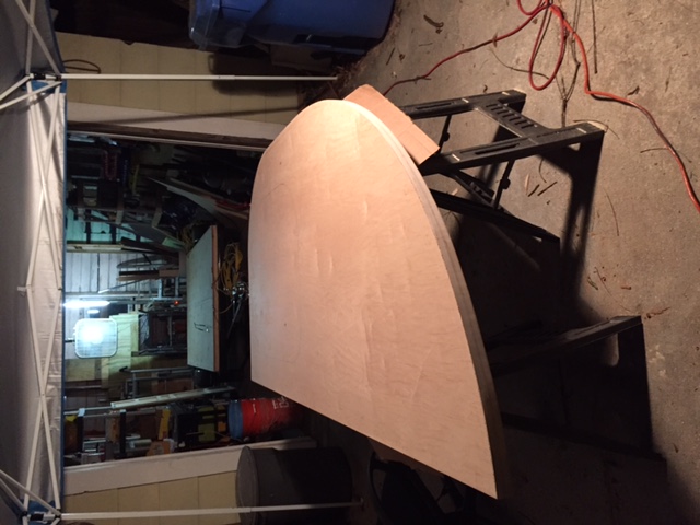

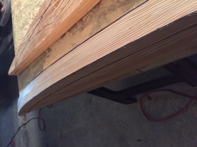

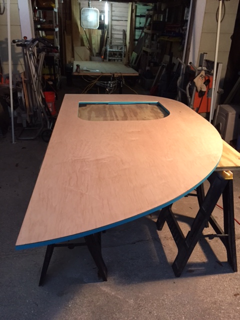

I then sanded the long vertical edge straight and made sure I had a 1/8th" in gap the whole length. (Pic 3)
I repeated the same steps for the second door opening. this one did not have the template drawn on so I traced the cutout door opening onto the second side. I would not recommend this method as it went from a fairly straight template outline, to a slightly wobbly trace job to an even more wobbly second cutout. It all turned out fine, just required a bit more sanding to get the long vertical left edge clean.

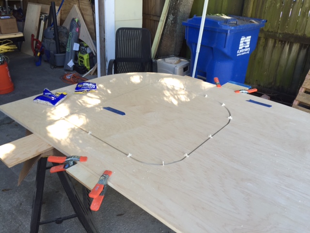

Back at it early in the morning! I was setting up around 8:30am. I gave my neighbors until 9:30 before the power tools started. I had the 1/8" gap on the left edge of both doors, still needed the 1/4" gap around each edge. I started by sanding the door opening to remove any peaks and valleys. My wife saves the day again. She pulls a scribe out of her art supplies. It works perfect as I am able to set it to 1/4" and follow the door opening and mark the door perfectly to see where sanding is needed. Saved a ton of time as it reduced the amount of re-measuring I needed to do. Still a very lengthy process (Pic 1)
Anytime I had to drop the door in to check I would set the top edge first. I used the belt sander and planer quite a bit. I have been using tile spacers to make sure my gaps are spot on (Pic 2)

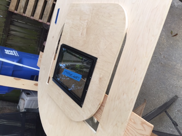

Once both door were fit I cut out a 12" x 18" opening in each door to house the window. As with each process the first one always takes a little longer and I learn something along the way. Even though the portion of the window that goes into the door is 12x18, they don't account for the pan head screws on the four corners. The first one I sanded down the four corners of my cutout to allow the for the screw heads to fit...lot of in and out. The second one I cut the opening just a little larger from the beginning and it dropped right in (Pic 3) Doors are now set aside.

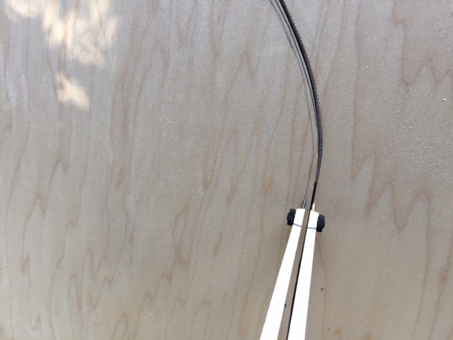

I then used the scribe to get a 2" mark along the whole curve. I was tired of jigsawing today and I had a new fine blade on my circular saw so I decided to make a bunch of plunge cuts then connect those with the jigsaw to speed the process up (Pic 2). I still need to sand these pieces, my level of excitement for that is at a zero, put them aside for later.

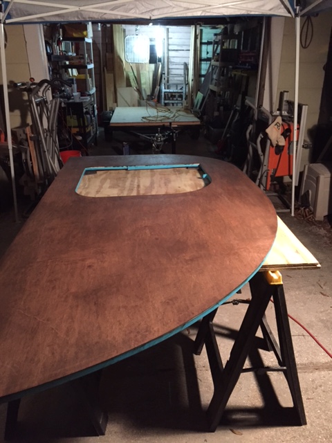

After I was done with the hatch components I brought out my right side. I sanded both side with 220 grit then 400. (Pic 1).
I put on one thick coat of the Kona Stain I am using. I let it sit for about an hour (Pic 2)
I used Mineral Spirits and a bunch of rags to clean the excess off. (Pic 3)
Moved it all back in the garage to let it dry out.

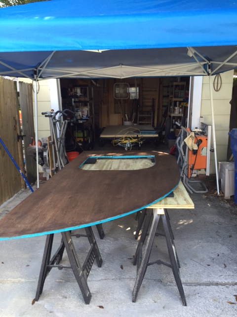

My wife thought I should put a second coat of the stain on so it will be a little darker.....so I put a second coat of stain on, let it sit for an hour and removed the excess and let it dry (I am doing the door for this side at the same time). I then applied the first coat of clear coat. I am using the water based Spar Polyurethane, dries really fast. Waited an hour, lightly sanded and repeated this process. I was able to get 4 coats on in total before I had to shut down shop and get ready for Date Night with my wife!
