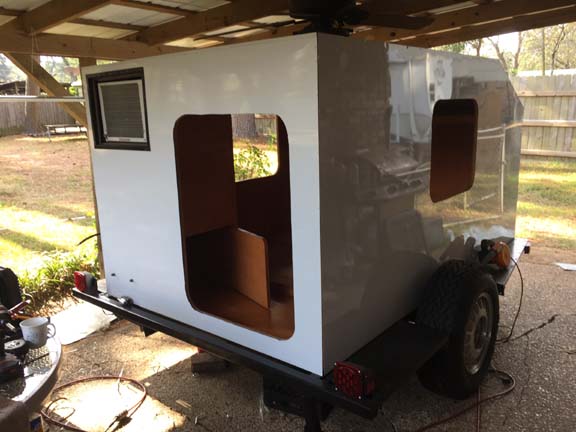

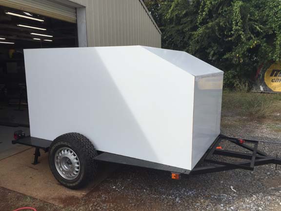

Postby bbrider » Fri Nov 04, 2016 7:59 pm
Got the skin done on Thursday at my buddies sign shop. He has a powered brake and a sheer. He ordered my 5x10 .040 aluminum for me. 4 sheets was $246.08. We cut and broke the roof in one piece and then cut all the sides and ends. I shot the edge with 1/2" staples on all the pieces. done in 3 hours.

Got it home and started trying to do the cutouts. Router bit kept getting clogged up with the aluminum. Went to Harbor Freight and bought the electric shear. Rough cut out all the holes with it. Then used the router to finish trimming the edges around the hole. Spraying the router bit with wd40 seem to help stop the sticking too.

Tomorrow I will finish the AC hatch door. If I can find some help to hold the windows and door in place I will get those done as well. Then I can start the corner trim. I am getting excited to see this starting to come together. I was very happy with how it towed behind the jeep. It didn't bounce or sway and on Louisiana roads that is amazing!

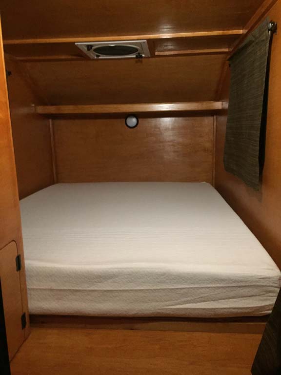

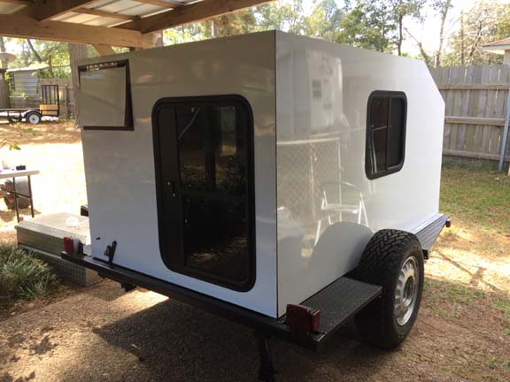

Postby bbrider » Sat Nov 05, 2016 9:36 pm
Long day! Started out installing my windows and door. That took almost three hours! I had problems getting the trim ring holes to line up with the window groove for the screws. I found it was much easier to install the trim ring on the work table first, then take it back off to install the window.
Then I installed the Fantastic Fan. Easiest thing I did today. Next I unpackaged the mattress. Then I went to work installing the sheeting and trim on the AC access door. Got that done and the door installed. Then I discovered my locking setup to lock the AC in place when stowed had pulled the angle on the AC loose on one side. Two steps forward one step back!
Removed the AC unit and carrier I built and fixed the aluminum angle back to the AC unit. Removed the latches and started over with a different arrangement. One trip to HD for 1" #8 bolts, washers, and lock nuts. Disassembled the carrier and added all the new parts. Then reinstall the AC. DONE!
Took a little break and decided to hang the curtains. Temporarily wired up the battery so I could test the fan. Noticed I had aluminum bits on the shelf so I started to vacuum that and when I bumped the wire block for the DC fuse block on the shelf my lights went out. Crap, now what. Got out the trusty phone and turned on the light so I could see and found I forgot to tighten the nut on the ground post. Tightened it and all is well. I opened the windows, turned on the fan, and layed down for a minute. 64* and the cool air coming in I could have went to sleep right there...LOL. I am getting close.
Now the boss {my wife} is after me to paint the aluminum angle I plan to cover the corners with black to match the diamond plate and trailer. She is also fighting me on putting the rain drip caps over the windows and door. I painted them black, but she thinks they look like chicken wings sticking out and wants me to leave them off. So they are off for now.
I am still considering using some black caulk around the windows and doors for extra protection. There is a slight gap 1/16" between the window lip and the skin. Not sure it is needed with the rubber gasket being mashed so tight, but it wouldn't hurt either I think. That is still up for debate too. Guess tomorrow I will start painting the aluminum angle. I just am not to sure how to cut it to length with mitered joints before the butal tape is installed. I am worried the tape will hold the angle up just enough to make the joints not close if I precut everything before installing the tape. If anyone can shed some light on that I would appreciate it. Anyway here are the pictures for the day.

All you need is a pillow in there. Maybe clear silicone around the window then wouldn't lose the clean black edge of the window.

Yup, if you do it, painter's masking tape about 1/16 inch away all the way around; apply clear sealer; wipe; and peel the tape for a nice clean install. No lumpy, ugly, smeared sealant allowed on such a clean build.
