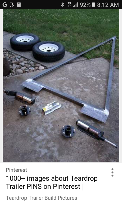

TRAILER ADVICE WANTED.
My caravan is very rigid with 2 bulkheads, laminated ply/foam/ply/glass construction and curves in just the right places. I'm planning that the trailer is a simple triangle of pregalvanised box section, reinforced at the joins and torsion axles off the back of the triangle.
I haven't drawn anything up. My engineering friend wants to make quite a heavy trailer but I don't think that one is necessary.
Any thoughts? Box section size and gauge?
Something like this?

Thanks for kind compliments on my build. You are right about glues, it is just the PU glue is cheaper here in North America than epoxy, but I like the strength of epoxy. As for trailer frame, I am also in favor of simple and light A-frame with torsion axle just like you are thinking about, although I have no experience with that. I am thinking of my next (lighter) build with frame like that...
Did you see this board design library for frame ideas:
http://tnttt.com/Design_Library/The%20Ultralight%20Chassis.htm
http://tnttt.com/Design_Library/tear84.htm
