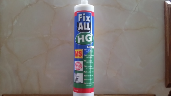

Postby Sheddie » Sun Oct 23, 2016 10:32 pm
2014-12-28 10.56.28 (560x315).jpg (71.88 KiB) Viewed 4252 times
http://www.holdfast.co.nz/pages/product ... psid=20303
This is the one that Ullrich Aluminium recommended for the job. I don't know if it is available in your part of the world, but I have put the websites here so you can check the details. You may be able to finde something the same by a different manufacturer.
Sheddie
Posts: 1499
Images: 1129
Re: Aluminum composite teardrop
Postby Breytie » Mon Oct 24, 2016 6:30 am
Sheddie wrote:
I can vouch for FixAll - I use the Hi-Tack (red tube) to fix and seal - that stuff is phenomenal and will even set under water. Fixall does not give off solvents or acid when curing so it can be used on most metals and plastics.
