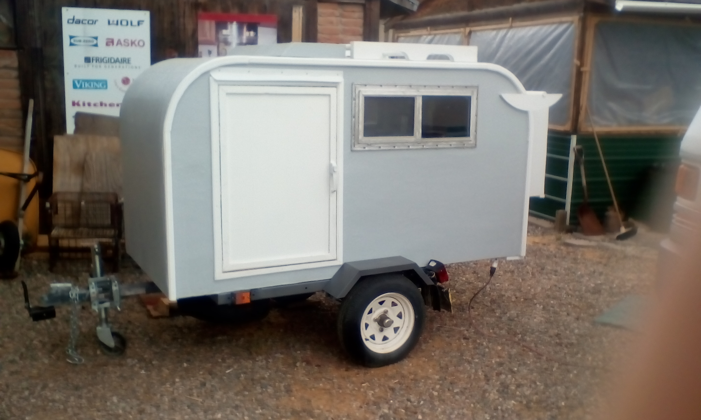

Postby Job » Fri Jun 30, 2017 3:13 pm
AtticDrop, sorry to hear about your dog. I know how you feel as I have lost a dog, that was a cherished member of our family. My current dog Dub is like my best friend. Good job on your mini tear. It will come together in it's own time. I built a very similar camper this spring and just sold it 2 weeks ago.
Good luck with your build. Jeff
