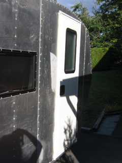

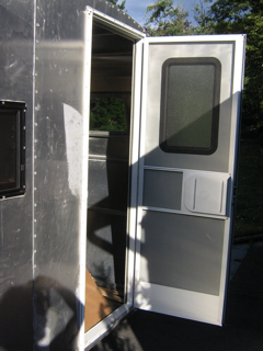

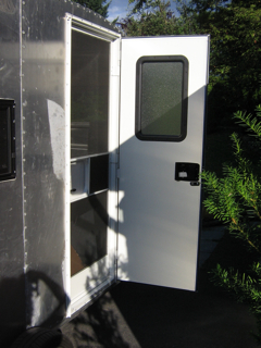

Did the Dexter door today - dunno if it was beginners luck or maybe that a $650 door installs itself (got it for 300 cash, minor shipping dmg, and that screen tear for those wish great vision). Anywho I did just the same as I did with the windows, but with the wider butyl tape that wasn't as smushy, and I put a lot more sealant - a whole canister - a fat double bead with more at the corners to really guarantee the seal, as I knew this was a one time chance on the install. And I knew if something went wrong, prob a whole day just to re-work.
My approach after test fitting the door, grinding, test fitting, etc. after about ten test fits I was ready to commit today (the rivets finally showed up). So I tacked in one rivet on the hinge side about 3/4 of the way up - I found that to be the best spot to 'hang the door', although it was fully resting on the the 1" square tube aluminum frame at the bottom (with butyl tape and a generous amount of sealant just beside it). Then I did the two rivets immediately beside the latch (on the left) to force them into place, and then from there I opened and slammed the door every few rivets (to make sure I didn't rivet it stuck shut) until all 45 or so were done. The hinge side of the door caught mostly rivets right into the 1" tube - this is very good news to me, as it will be locked in there damn good. The left side, non-hinge side of the door most of the rivets just went into the skin - 16 ga aluminum. The bottom rivets went right into the middle of the 1" tube, all of them, and the top rivets went just into the skin. [Edit: this requires explanation - I fit the frame to the door so close, that all the rivets were catching the 'outside'. Had I fit the frame looser, the door would have caught all the rivets. About 12 rivets will be re-done with .375 grip to re-work the mistake which is, really, not a big deal, structurally, even with the mistake]
So the afterthoughts are that it worked really well, I've never done a door before, but this one gave me few hassles. Its a dang full size RV door!! Hilarious. So glad I did it, I'm gonna get some laughs out there in the field. Here are the pics:
Dexter door fully open (umm... is that a full size RV door there?!?)
screen door closed
and fully closed RV door - its awesome so far i've slammed it about 30 times

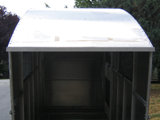

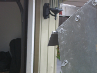

In the first picture the roof line got finalized during my first attempt at 'grinding a straight line' using the hinge as the ruler, and a 0.9mm red sharpie. Then I proceeded to grind off all the red doing it in three passes. It worked out really well! That's the straightest line I've ever done freehand with the grinder. In the first picture the left side is actually popping up a bit, so if you hold it down the line it looks like 1/2mm accurracy and shores up to the piano hinge very well. I am very happy with that, and glad that although this part of the build is going really slowly, my confidence in the install is increasing as I go along. Great news for such a weird door. Here are the pics:

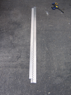

practice fit of 3" wide .061" aluminum cargo door piano hinge
hinge is upside down and wedged between the roof skin and 1" tube aluminum (to be riveted) [Edit: the hinge was too tightly fit, it was backed out 5/16"]
birds eye view of the hinge

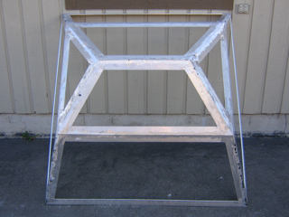

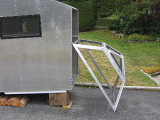

Other than that today I grinded the cargo door (hereon-in referred to as the 'clamshell') down until all grinding is done, with some rework required to fill some holes and one more grind session. You can see its a weird looking door, its a stepped square pyramid as I had to bring some sci-fi geek to the design, as thats kindof my signature style. The reason why I chose this design for the clamshell is its the only way I could figure out how to make the door aerodynamic without using complex curves as I am new to working with aluminum. So I chose to work with flatbar and do all the panels separately in 2D and then weld them all together. I sent the sketchup drawing to the supplier to cut all the skin panels, just like with the cabin, and as a result they are perfect. All this effort isn't really for the increased volume in the cabin (although thats where my head will be sleeping), its for the reduced drag ratio this door will cause to the entire trailer. This should help to stabilize the trailer when semis pass me, but also it should sway less and improve mileage significantly over a flat backed door. It better.. hehe, can't wait to take it out for a rip.. should happen soon hopefully next 2 weeks! [Edit: no, no, it does not happen in two weeks, of course predictions are as good as rolling dice sometimes] Happy friday, gentlemen & ladies! Here are the pics:

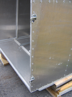

these are the 150lb tie down spots at the rear of the cabin (4 of them)
for those confused this is how the clamshell mounts (and how when raised 90 degrees its an umbrella)

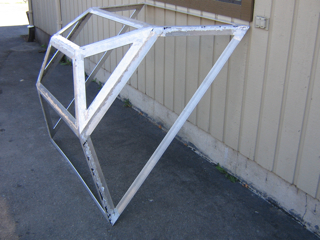

Did a grind session on the clamshell today, then a final inspection where JB Weld Quickset (6min) was used to fill in all the remaining little holes that a MIG welder is overkill for - thats what the dark brown/black is that you see in the pics. Tomorrow a final grind session will be done, and the clamshell will be tacked in with rivets. Still don't know what the best process is.. I'll have to make it up as I go thats why I want a good monday morning start to ensure it gets completed. Both the JB weld and the sikka seal grind off well I've found. So here's 2 pics of the 'close to final' clamshell frame:
this shape should help minimize airflow separation and magnitude of the reverse pressure gradient at the rear of trailer improving drag ratio significantly
clamshell oriented properly leaning against the wall

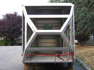

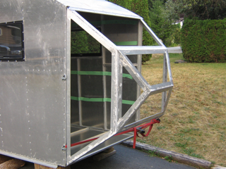

Well its all downhill from here on - the clamshell install went very well. I am very glad to not rush a first bespoke door such as this.. :wine:
It took the whole day, a bit of rework, and I was off by half a millimeter here or there, but it doesn't matter. The point is the door fits, its skewed by the tiniest bit thats why the ratchet strap is on it. Gonna leave it to gravity settle and heat and cool in the sun for a week or so and keep ratcheting it square as the hours go by. I'm sure with a bit of over-tension and riveting the panels on, I'll get her square on.
To tack in the clamshell, 6 rivets were used on the roof/cabin side and 8 were used on the hanging clamshell side. Notable points are that the door is short by a quarter of an inch. And I'm glad. Offloading and onloading the cabin I don't want that door anywhere close to catching. A notable second point is that the upside down hinge fit in there so well, I think the second seal (as I was calling it) will be so good it will be water resistant to a great degree even without the primary seal, which will get all that other water that happens to make it through.
I was reading another build yesterday and one thing that touched me how the guy said that the build was emotionally and physically painful. I can so agree with that statement. But its moments like this, where my gut tells me its all downhill from here on... this is good news to me :) Here are the pics:
the clamshell (no its not the front its the rear)
this will show you how the clamshell attempts to direct the airflow
this side shows it shoring up to within 1/4" which is all around, for upcoming gasket/weatherseal
