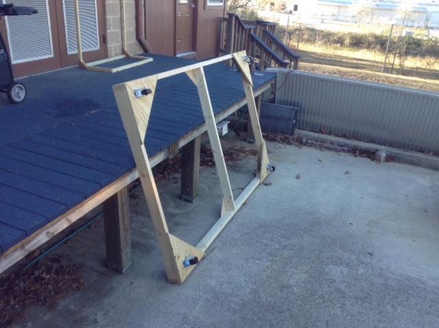

I finished building a dolly to built the TD on until the trailer frame is finished.
TD build dolly

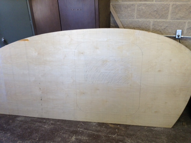

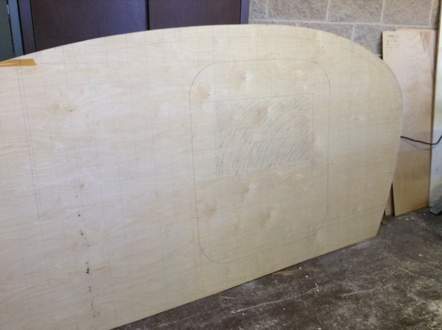

Also trying to figure out the door shape and location. I think 32" is about the right width. The Windows that I purchased are almost "24 wide so I have 4" of door on either side.
I have drawn the door on the profile. The bottom of the door is 5" above the top of the frame, and the top of the door is 6" down from the top of the TD. Also tried to position the door near the hip location when lying down in the cabin to make pivoting in and out easier.

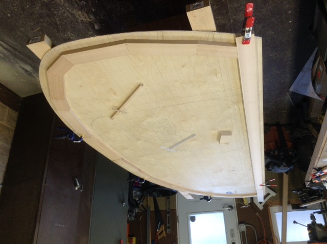

Making progress on the frame for the sandwiched walls.

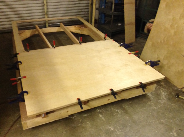

Started assembling the floor today. 1x4 pine & 1x3 spruce boards will make up the skeleton frame. I used a 5x sheet of birch plywood as a guide to keep everything square, and provide something flat to clamp the boards to.
1st glue-up

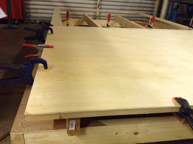

I dropped off the 2x3 steel tubing, axle, and suspension at the local fabricating shop. They hope to finish the trailer frame by the end of the week.
In the meantime, I've been chipping away at the floor. After building the skeleton perimeter of the floor, I glued the first sheet of 3/16" birch plywood to the skeleton. I only had enough clamps to do one sheet. Must buy more clamps... I nailed a brad into each corner to prevent the sheet from sliding around on the PL Premium adhesive while it dries.

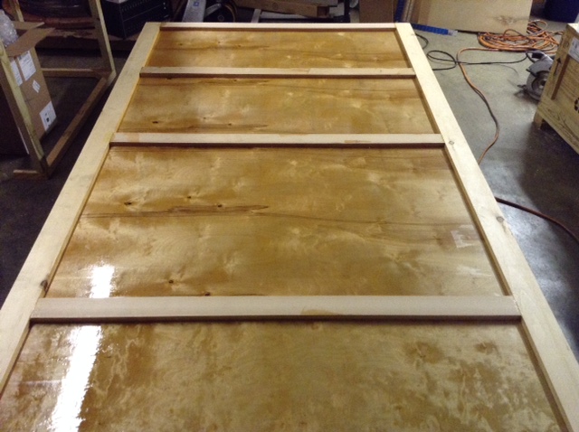

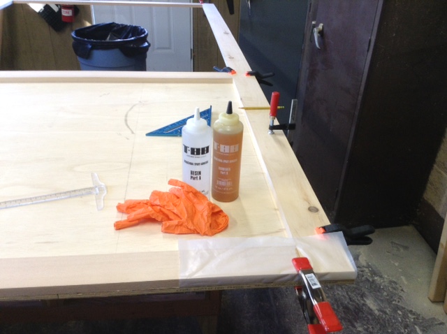

Made some progress on the floor. Coated the inside surfaces with RAKA epoxy to head off any condensation rot. Next step will be to cut the styrofoam insulation to fit, and lay the top 3/16" plywood on to complete the sandwich. After that, router trim the edges flush, and coat the whole assembly in epoxy.
The frame is being welded up at the fabricator shop.

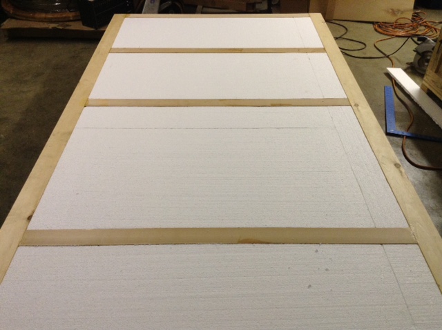

I installed the insulation after applying PL Premium to the plywood with a fine groove trowel.

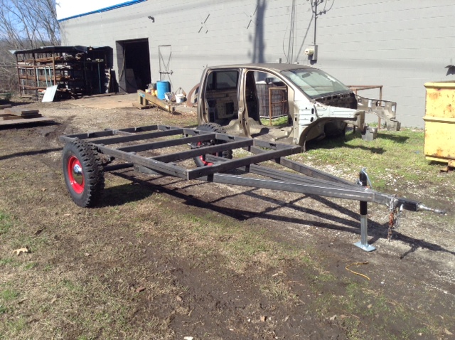

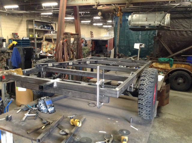

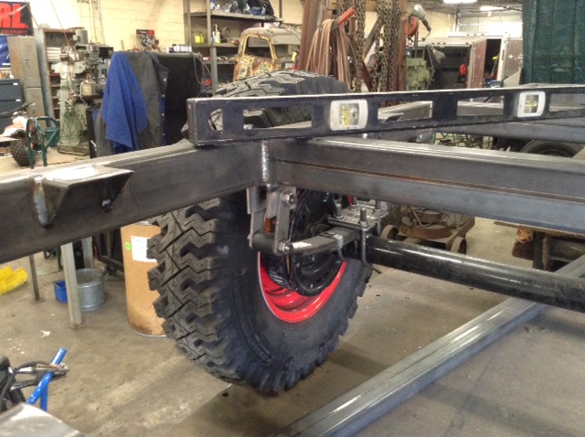

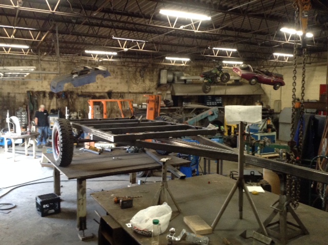

Here are some pics of the trailer frame....in progress and nearly completed :)
Take 1
Take 2
Take 3

Postby kokomoto » Tue Feb 07, 2017 11:52 am
Take 4

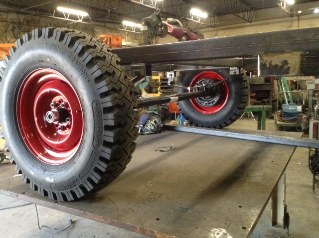

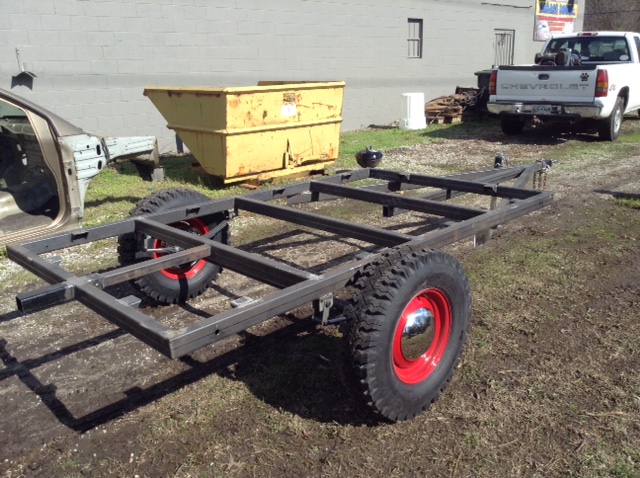

I picked up the trailer frame from the fab shop. The guys at Garage Bound llc did a fantastic job. :applause:
It measures exactly 80" outside tread to outside tread.
I'll be sanding, prepping, and primering over the next few days. The wiring project will follow.

Postby Louisd75 » Thu Feb 09, 2017 2:48 pm
Those wheels look sharp :thumbsup:
Louisd75
Posts: 106
Images: 209
Joined: Wed Jul 17, 2013 4:27 am
Location: Bellingham WA
Re: Off-road Teardrop Design/Build
Postby kokomoto » Thu Feb 09, 2017 8:09 pm
Louisd75 wrote:Those wheels look sharp :thumbsup:
Thanks! I found them at Coker Tire. They have an enormous selection of wheels and tires. They also have a nice automobile museum.
