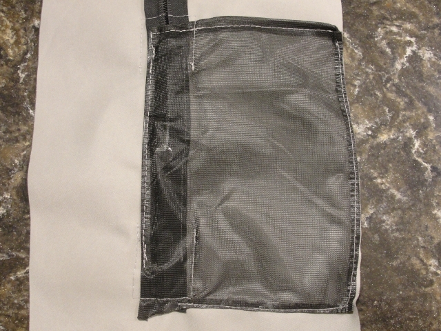

Today I began to experiment with how to sew the six large windows with no-see-um netting protecting the openings.
I should have sewn down the no-see-um netting in the corner before I sewed the protective top cover. That would eliminate the extra stitching on the cover. I'm using #10 coil zippers for the windows. The coil zippers are somewhat flexible and will take a gentle curve without too much fuss.
Here's a summary of the process to sew the windows. First, the inside seam of the zipper is sewn from the back. Second, the no-see-um netting is sewn in place along the outside seam of the zipper from the back side. Third, flip the panel face up and cut between the seams with a hot knife. This exposes the zipper and gives access to sew the binding on the unfinished edges of the flaps that cover the zipper. Fourth, sew the binding on each edge of the zipper flaps. Fifth, sew a cover to hide the zipper and shield from rain.
Here the zipper is opened and you can see the no-see-um netting underneath. The stitching on the binding is sloppy as I'm practicing working in such a tight spot with my binding attachment. I will use black binding in the final product, but I only had green available for experimenting.
This view from the inside shows the netting. This is just a small practice piece. The windows will be 42" wide and 48" tall. I plan to sew each window as a separate panel and join it to the adjacent panel with a half-felled seam. This keeps the panels more manageable to fit under the sewing machine arm.

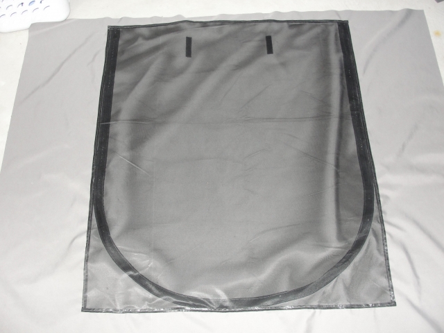

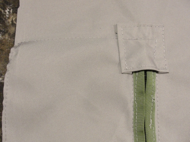

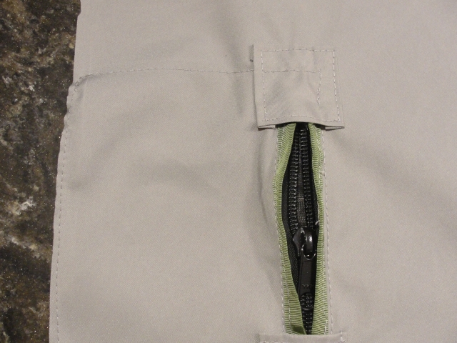

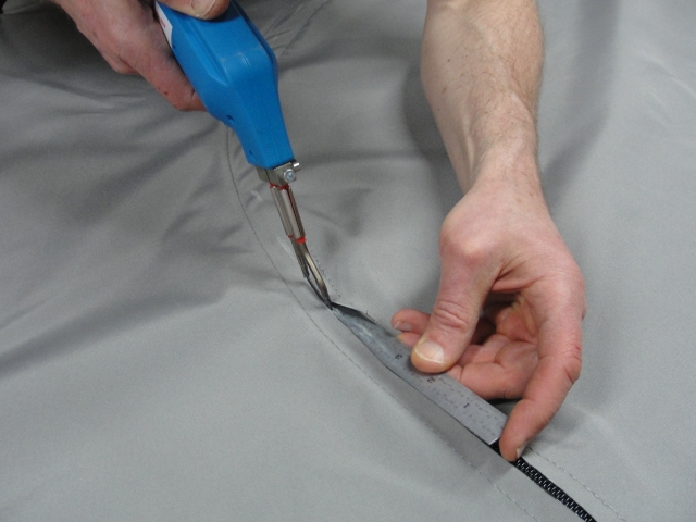

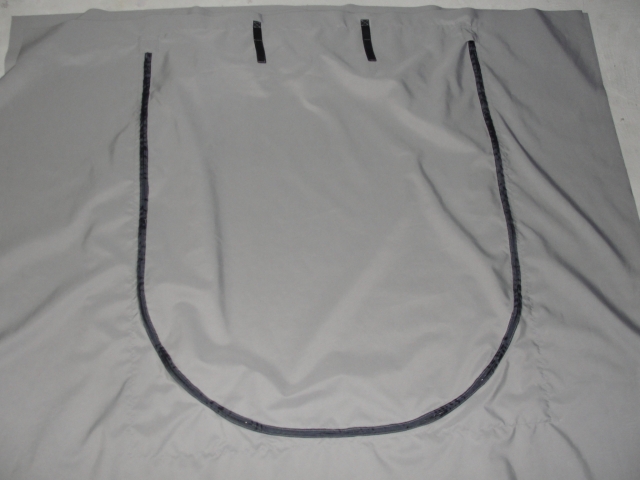

I sewed the zippers to the back side of the panel and then I cut over the zipper with a hot knife to make zipper flaps. This approach allowed me to make the window panel from a single piece of material. I then sewed binding over the raw edges of the zipper flaps. That was a huge pain since I used my 1" binder and should have purchased a 3/4" binder for the minimal clearance the zipper allowed. The binding job isn't real pretty, but it's done.

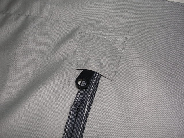

Here's a closeup of the binding and the zipper cover sewn at the top of each zipper.
A view from the outside. Notice the velcro tabs that hold the rolled window at the top.
Here the window is rolled open. Notice the no-see-um netting. I've got some doubts about its durability, but I'm going to roll with it since it's the most durable I could find.
A more distant view of the window rolled open.
View of window from the inside. I rolled the edges of the netting over twice and held the folds with basting tape to avoid puckering from the aggressive presser foot of my industrial sewing machine. The tape also improves the water resistance of the stitches.
I'll complete the other five windows and then sew the mating adjacent panels together to make full length panels. I'll then sew a long piece across the bottom of the joined panels to make them the required height. I'll sew the panels to the roof and then to the panel on adjacent sides. Things will speed up once I complete the screens!

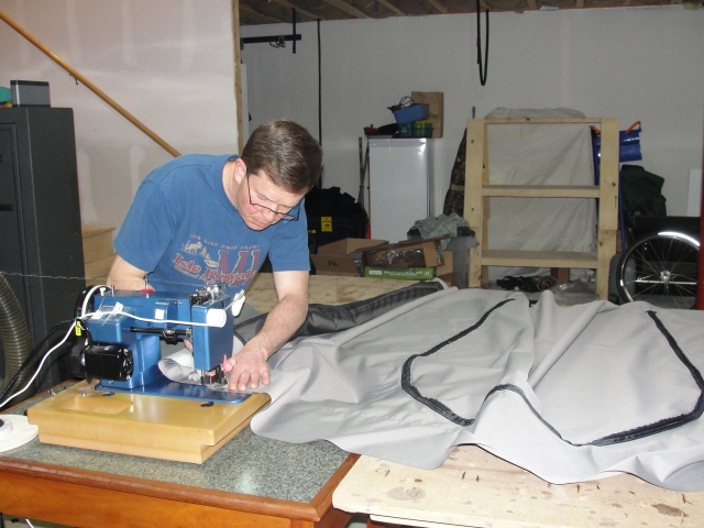

Postby Dusty Mark » Sat May 13, 2017 11:20 pm
I finished sewing the six windows today and began sewing the panels together.
This is the second part of the half felled stitch that joins two 5 1/2' panels together. I've rolled up one panel in order for it to pass through the sewing machine arm. The tables keep this operation manageable.

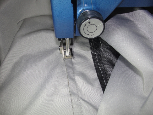

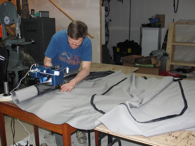

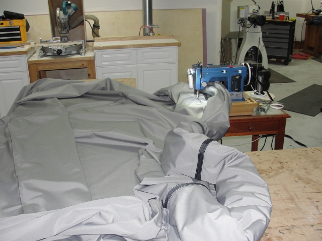

My substitute teaching job was cancelled so it's a nice rainy day to surge forward on the tent. Today I'm sewing the side and end panels to the roof.
The tent gets bigger with every panel I sew to it. Thankfully it rolls down tight and fits through the arm of the machine. I've been doing this work solo and the tables provide good support.
Closeup of the second stitch that holds down the semi-felled seam along the panel/roof. This is a strong and waterproof seam.

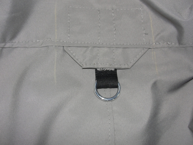

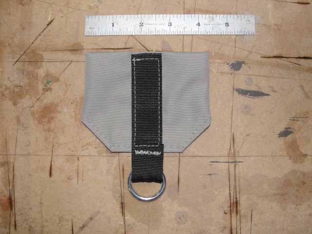

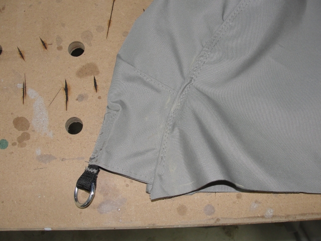

This is the guy line anchor point that is located midway down the panel/roof seam on the 11' sides. I decided to provide some reinforcement to this to hopefully make it survive strong winds.
Guy line anchor sewn into the seam. UPDATE: Sew a similar anchor point now into the wall below this about halfway down. These big walls sag a bit and would benefit from a little pull outward. You can tie the roof anchor and the wall anchor to the same stake in the ground.

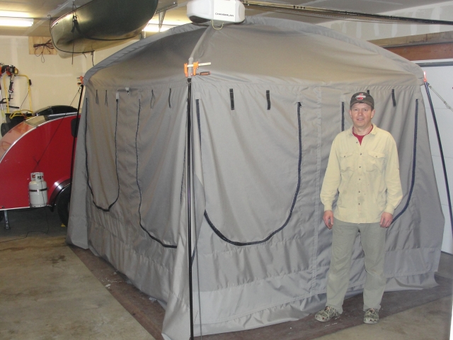

Tonight was a milestone as we put up the tent with the sides attached to the roofline for the first time.
This was a tricky process as there is a lot of material and very little support that it would normally have from a finished structure. After carefully erecting the tent, I tied the guy lines from each corner to some heavy dumbbells. We moved the corners around until we found a position that eliminated leans in the tent. Once we achieved that position, we marked the corner pole positions on the garage floor with a permanent marker. If the assembly slips while we’re working on it, we can quickly find the “true” position again.
Our next step is to pin the sides to each other and pin the 8 pole clips/straps that tension the tent body to the legs. We’ll take the tent down to sew the side seams and then erect it again to fit the floor. It’s finally looking like a tent!

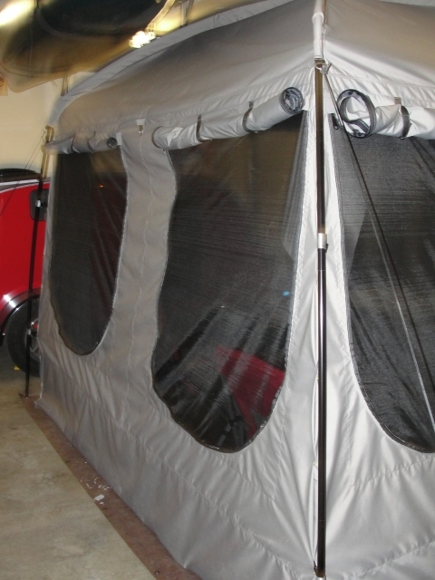

Photos After Initial Pinning of the Side Panels

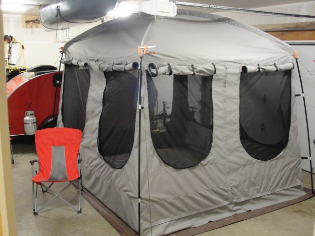

Postby Dusty Mark » Thu May 18, 2017 12:14 am

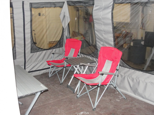

Here are some photos after initial pinning of the side panels.
One of the entrance windows is 4" short...oops!
Plenty of room inside.
Closer view of the sides.
I'm debating whether to sew the seams from the inside or the outside. I kind of like the idea of sewing them from the outside. Not sure of the strength difference between the approaches.
