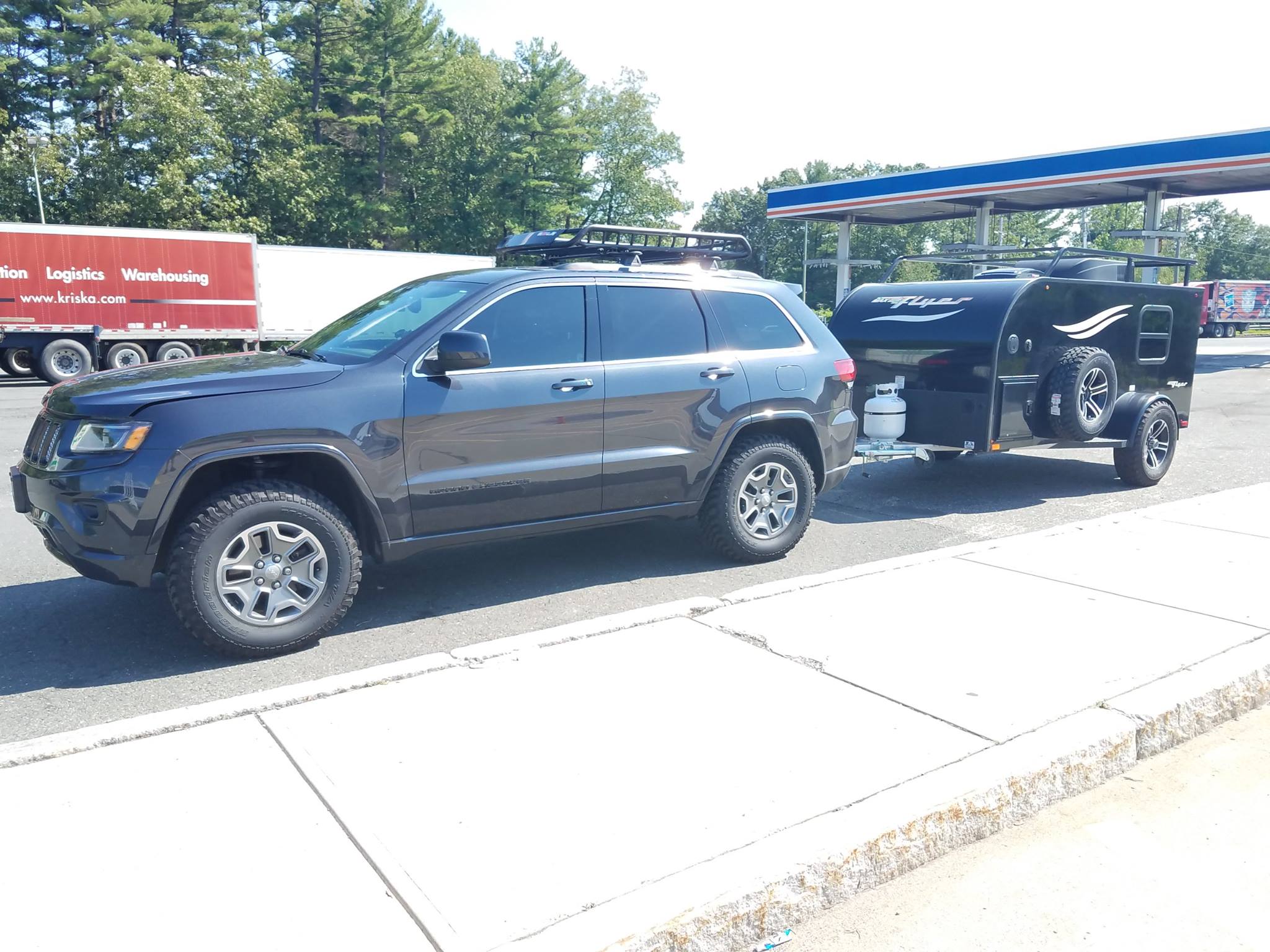

Postby jjarret83 » Fri Jul 28, 2017 7:36 am
Hello! hopefully your still active on this forum, just picked up same exact model and starting the mods!
would you be able to share few pics of the rear tie down setup ?
looking to mount a tv on the wall and curious what you have been using to mount the lights etc with the all aluminum TT both interior and exterior
going on our maiden voyage this weekend with pretty much stock except for the foxwing awning, but bad part is I guess a batch of foxwings that were delivered to IntechRV have the wrong orientation( box says RHS but really a LHS awning is in the box) so waiting for a replacement at this time but still plan on using it till they ship me a new one since its already mounted!
was downsizing the propane tank worth the expense? I agree with you that the tongue weight for this is guy is little more than expected but the grand Cherokee pulled it with ease and I just have a leveling kit with rear TJ spacer, might have to look at getting new rear springs with a 2inch lift to compensate when trailering this guy around.
since you've had yours for a while, if you have any recommendations/ mods that I should do please let me know!
ordered a 20watt zamp solar kit to keep the battery juiced while not in use but looking for suggestions on any worthwhile mods!
thanks in advance

Postby G-Mac » Fri Jul 28, 2017 9:37 am
Hey Jarret,
I'd be happy to share a few photos. I will get some as soon as I can. In addition, my photo sharing site seems to be down at the moment.
My setup is pretty simple. I bought some D-rings and drilled through the floor with large washers on the back to reinforce it. I originally tried screws, but there just isn't enough thickness in the wood. I used normal tie-down straps and bungee cords for the items I tied down.
As for wall mounting options, the stuff I put on the walls was all done with wood screws. The wood is thick enough for most things and there is a 1" gap between the wood and the outer wall, so no worries about the screw slightly extending beyond the wood. If you are mounting a TV, I would make a bracket and mount it through the wood and into the metal tubing. Use a good metal screw, pre-drill and span at least 2 "studs". Be sure to watch for overall length and not go through the exterior.
Downsizing the propane was a bit expensive, but it saved about 30 pounds. I know it isn't much, but it helps on my Wrangler. I also don't see a need to pull around that much propane, as the stove just doesn't take that much. A 25 lb tank could last a couple years.
As for solar, I haven't gone down that road yet. I plan to put a couple panels on the top, but haven't gotten to it yet. For now, I have upgraded the battery to a 120ah AGM and just keep it charged with the 110.
I'll get some photos up as soon as I can and let you know!

Postby jjarret83 » Sat Jul 29, 2017 12:18 pm
That is perfect setup, sorry to the guy whos having issues with the post i can remove the picture, looks perfectly fine on my end though.
When i get home tomorrow ill be starting the dring setup as i have them waiting and attaching the shovel/axe to the roof rack of the flyer.
This weekend was first time using it...cery happy we purchased this over the larger campers...gets alot of attention but noticing for the price they arent to impressed... to each their own! Image
