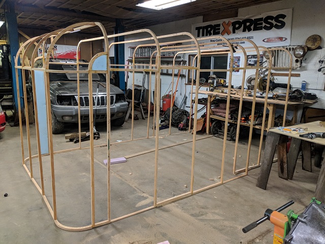

I made it around the corner now. These front corners are the complicated part. I can now see the compound radius that I will need to fill with foam and skin inside and out with plywood. I have done all the math for the pieces and feel pretty confident that it will work out as I have envisioned it.

I found a piece of 1" foam that was the exact width I needed to fill this small gap so I had to test fit it. Not sure yet what adhesive I am going to use between the wood and the foam. Any suggestions???

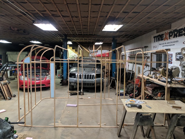

I finished framing the main cabin. :thumbsup:
155804
I need to address some mounting points for cabinets and maybe even up some of the horizontal supports to line up with the plywood edges. I am trying to plan my plywood seams so they do not end up at the edge of a radius so the seams blend together better.

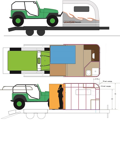

I suppose it is not illustrated real well,but you can see how the slide out overlaps the Jeep. In the overhead view the darker brown floor color is the slide out section and in the side view the James Bond looking guy is in the slide out. The bed (blue) will be built on a cantilevered base secured to the slide out. When closed up the bed will come right up against the kitchen counter and still leave the bathroom accessible. I wanted to be sure the camper was mostly functional while in the closed position so I could sleep while towing the Jeep on long trips. You can also see in the side view that the slide out stops a little before the rear of the side walls. I want to maintain a 6" overlap there to protect the seam from the weather.

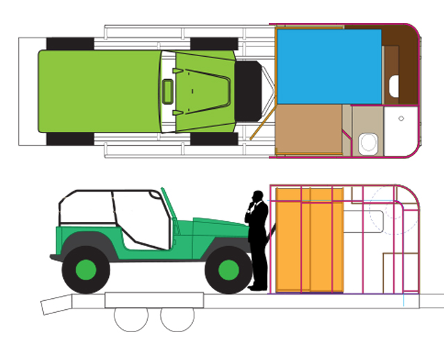

Closed position

I got it now, this is a cool idea. I wonder what a good weather seal design of such slideout should be.. :thinking:

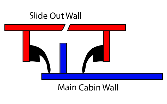

There is going to be a lip on both ends of the slide out and one mounted to the main camper body. This type of seal will be on both sides. I have ideas for a cam locking system to compress the seals in either orientation.

Here is a quick illustration of how that seal would work. The blue wall being the fixed wall of the main structure and the red being the inner and outer lips of the slide out. The cam lock would push the red lip up against the blue lip compressing the seal. Clear as mud, right?

Yes, the seal design makes sense. It will be continuous with a little arch on the top to shed water and radii in corners, correct?
