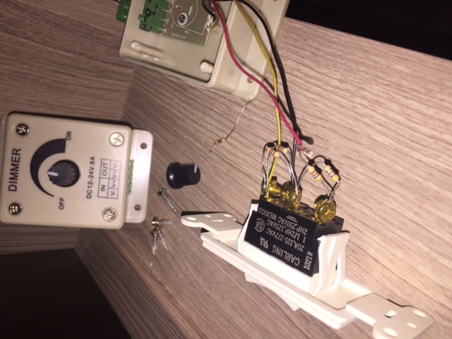

ok, so I add this because it solves a problem that many may have... how to effectively turn leds into familiar wall switch type of lighting.
From china you can get PWM 12v dimmers that are incredibly efficient way to dim LED's. (I got these for less than $2 each, and will dim 8 amps)
I also have some single pole double throw switch's in decora plate style (made for projector screen up/down low voltage control)
80ohms, 500 ohms and 500 ohms are the key values (that took some trial and error)
when switch is in position 1, it shorts out the center leg and the leg with the 80 ohm resistor, effectively making it zero ohms from the center wire to the low wire.
that shuts off the light.
when switch is in position 2 (center all off) you effectively have 80 ohms and 1k on either side of the center wire, which is about 10% bright or so.
When switch is in position 3, it shorts out one of the 500 ohm resistors making it 80 ohm and 500 ohm on either side of center wire, which is about 30-40% range.
My offgrid dimmable 12v edison style bulbs don't dim linearly like a led string does with these dimmers. By the time you hit 30%, they look full bright, but are pulling less than rated power. (EDIT: I just rechecked, my edison bulbs say non-dimmable.... which is why they don't dim linearly like my led strings do.....)
SO, I have dim that is pulling 0.2 amps, (that appears 50% of rated brightness) and full bright that is pulling 0.6amps... Considering I am putting in 80ah of lifepo4 battery (that I could pull 80%, or 64ah) That means I have over 300hours of continuous lighting avail on a charge. Now obviously I will be pulling other stuff off of battery, but it's kinda a cool stat on how much lighting I could get from my little battery pack.

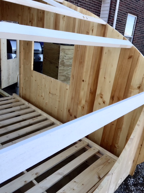

Finally, some warm weather.... I've been impatiently waiting to get it outside and start the thinned poly treatment.
Had to dismantle it almost completely, so I can treat all of the spruce... man it looks good.....

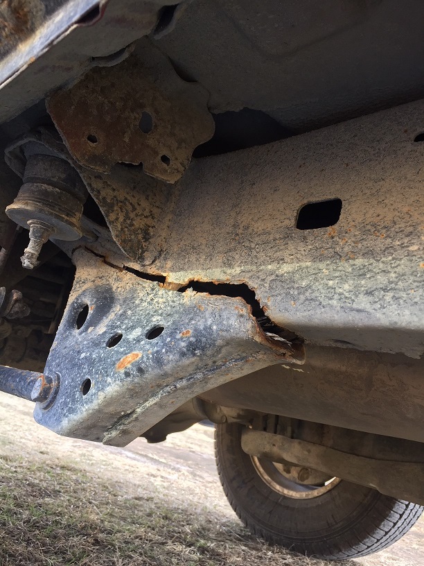

I don't think this is gonna tow trailer very well....
I think the trailer deserves an upgrade !

jbell.louisburg wrote:I don't think this is gonna tow trailer very well....
Toyota? I've had to repair that on a 4Runner for a friend of mine.
Sent from my Moto G (5) Plus using Tapatalk
Yep, '98 4runner, perfect in every way except this one.... anyone in the mid west looking for a super cheap hunting / offroad 4runner -- it'll be on ebay in a week or two....
Found me an '02 third gen 4runner that is just as nice, AND doesn't have this issue. Thinking an exhaust heat shield for the frame in this area will help the '02 live longer.

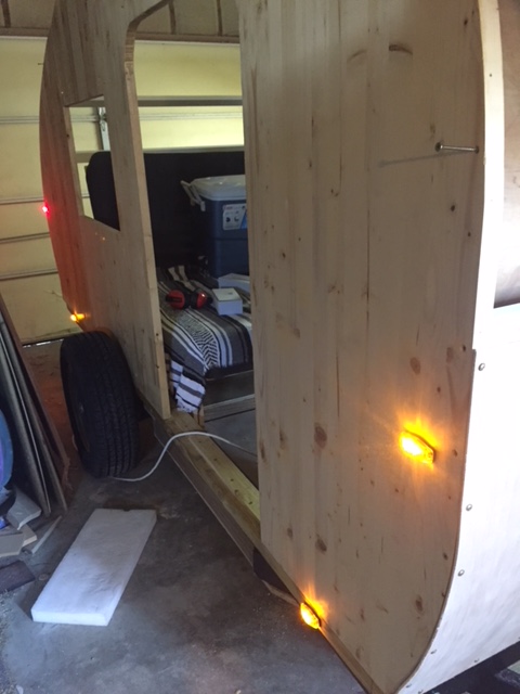

Go home kansas, you're drunk. Snow flakes on easter? 20 degree morning of prom weekend? seriously....
How's a guy supposed to go outside and do the smelly stuff, like waterproofing and putting on the roof?
Well, I made the most of the morning running wires...

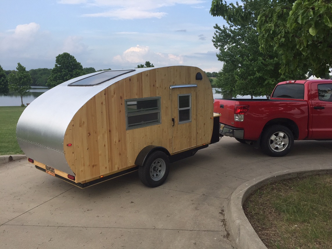

Re: Hidden AC
Postby jbell.louisburg » Sat Apr 14, 2018 3:46 pm

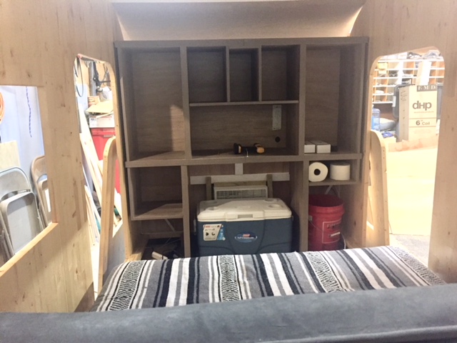

OK, so I finally found a "hidden" place for the AC that I like.
I built a "notch" in the tongue box that goes around the outside part.
The vents peek just above the cooler.
Just open the center doors (they open 180 degree to fold up tight against the cabinet)
Don't judge my tongue box/kitchen just yet, it's a work in progress...

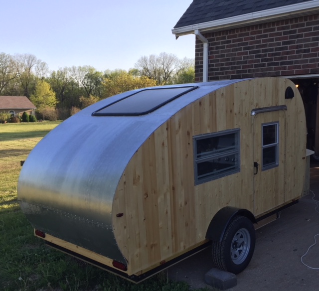

Postby jbell.louisburg » Mon May 07, 2018 7:26 pm
ohhh, curved glass skylight....

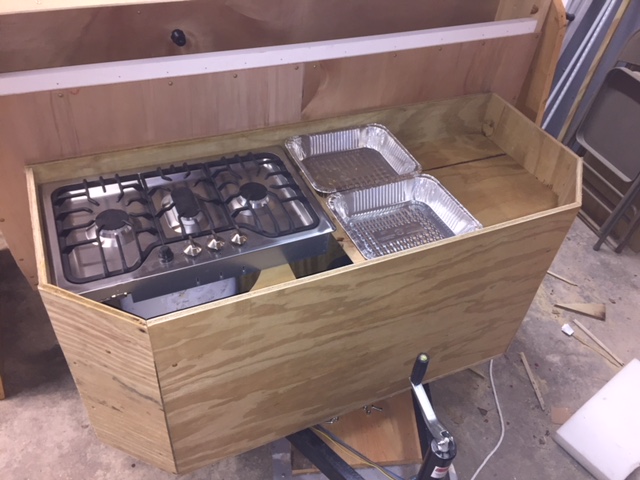

Postby jbell.louisburg » Wed May 09, 2018 6:37 pm

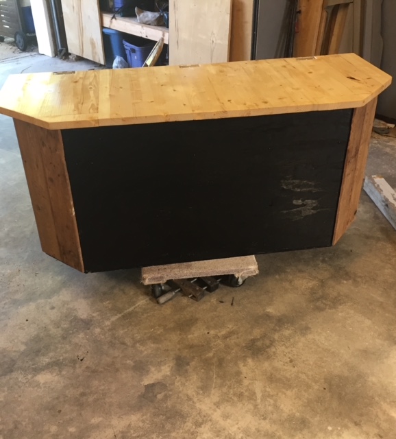

ok, so the tongue box / galley is looking better.
My son just had to have something from his grandpa's farm on the trailer.
The corner boards are real shiplap that look a bit red -- are from an old turn of the century grainery.
The red is from years of grain wear.

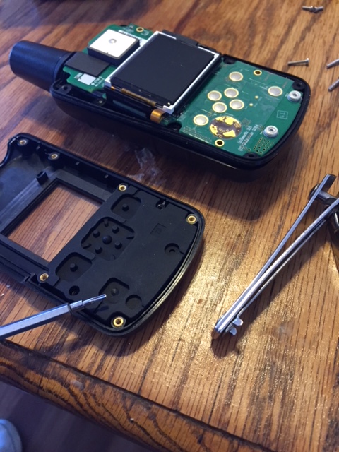

its time for all the safety stuff....
Combo CO/gas/smoke detector.
O2 sensor, yea, I'm excited about that... alarms at 18% O2.
and a delorme Inreach explorer.
My son was worried that in his pack, that the SOS might accidentally go off, and he'd get a search/rescue bill.
So, we fixed that. All that's needed is a T6 to open it up, and a pair of clippers to remove the nub that activates the SOS switch.
You can always use the menu to send an SOS, so this is just a safety thing.
