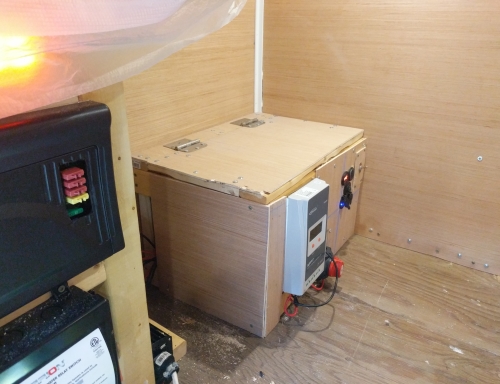

I managed to install my 27" monitor on the center stack and wired up my switches and ceiling lights. It is nice and bright. I'm getting 40v during full sunlight to my MPPT charge controller and 19v during overcast, so charging isn't an issue. I can run all my lights and fan + monitor off of solar and still charge during full sunlight. For overcast, or at night, I've wired up the six ceiling lights in such a way that I can turn on the front left, right, or the back left or right to minimize battery usage.
I have DC outlets on my battery box which are not connected to the main 'battery disconnect' so they can be used indipendantly, they have their own switches (because those have annoying LED indicators I didn't notice when I bought them, which are always on)

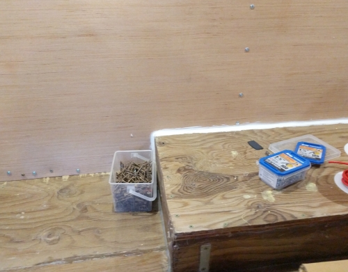

Caulk
I filled the section between the walls and the wheel-wells with flexible exterior grade acrylic caulk. supposedly it is shrink proof.. but, we'll see. I need to hit the underside again with rubberized rocker guard next time i'm up, the caulk should have had plenty of time to shrink if it will. I have another tube if that happens.

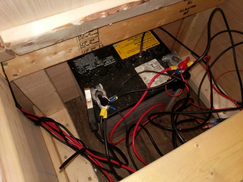

Battery Box
wiring
I got the proper sized battery terminal connectors and cleaned up my battery box, enclosing the final side. I still have stray wires to clean up outside. I also tested and mounted my internal antenna and ATSC tuner box - of course, in a place you barely get signal with a 40ft tower I didn't get any channels as expected. i'm sure once I get to camping somewhere with better line-of-sight to a tower things will change. Don't expect to be spending anything but rainy days watching TV anyhow, except for maybe checking on the news if I'm going to be doing a bit of running around or maybe some news photography/videography.

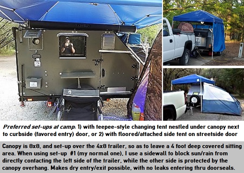

* instead of using a tarp and poles to create an "outside area that should remain mostly dry", why not use a canopy, sitting partially or fully (like mine) over your trailer, on the side where your primary door is. My TTT is 4x8, so a 8x8 Ezy-Up canopy, anchored against the "street" side (with my secondary door there), fully covers the cabin and my primary "curb" side door. It leaves me about a 4x8 covered area, where I often sit during rain events. It also shields the entry to my pop-up potty/changing area tent, which I usually use, attached near my door, for dry access to it (primarily at night, when it seems that we always have T-storm when I camp). Sometimes I use a larger side tent, with a floor, on the other side, where it also attaches to the canopy, and allows dry access straight out of the secondary door.
