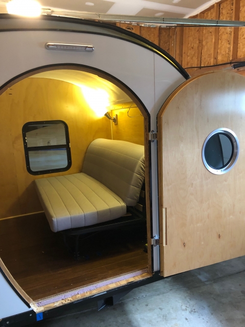

Here's a shot in the door. The interior walls are pre-finished maple plywood.
One weekend was enough to crave a small shelf for glasses, wallet and keys.
We'll probably add a small cabinet or two, maybe a couple coat hooks, some nice under bed storage boxes for linens.

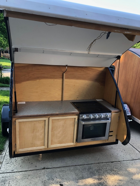

Here's the galley. Same approach, we're waiting to decide what we want for upper cabinets.
At the very start of the build we made upper cabinets, but we don't like them now so we didn't install them.
The lower cabinet face frames and door frames are scraps of 1/2 inch baltic birch plywood with polyurethane, the door panels are 1/8 inch baltic birch.
The odd slots in the small door are functional. We have very little space left under the counter, with the air conditioner under the left end and the oven taking most of the rest. A full 20 lb propane bottle would take up the only remaining cabinet space so we decided to use little 1 pound propane bottles instead. They fit nicely in that little cabinet on the right, and when we're using the stove we put the little bottle on the ground outside and pass the propane hose through one slot. There's a 120VAC outlet inside that cabinet and the other slot is for an extension cord to exit. The tail end of the galley hatch was not finished in that picture, you can see some wires dangling and some raw framing from an open panel. We do now have pulls on the cabinet doors.
The wife gave formal approval for the galley as it stands, says the counter space and range are good.

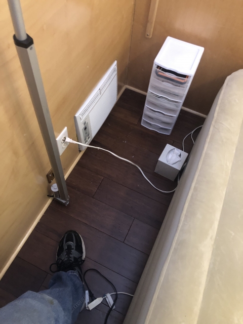

So here's a few more shots of the interior. First is looking in the door. The sofa bed is made into a sofa, and the side windows stow at that spot like that when traveling.
There is a good amount of empty floor space this way, we use it to pile up tote boxes and gear when traveling. If you just want to go straight to bed without lifting the roof, those windows can stay against the wall when you pull out the bed and you can sleep with the roof closed down.

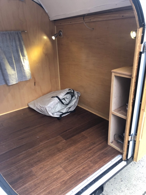

So we made a radical change. We took out the Ikea sofa bed.
It turns out that sitting on a couch is not worth the trouble of folding up the bed.
Instead we have a nice tall air bed. Built in blower to inflate. Automatic pressure keeping, if it gets soft it runs for 10 seconds to regain firmness
That's the air bed in it's bag where the sofa bed used to be.

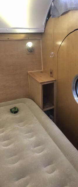

Here's the bed inflated.
Notice I built a little cabinet by the door. It helps keep the airbed against the wall. Still need to build the cabinet doors.
The top makes a nice shelf.

The sofa bed had a few shortcomings. It looked good on paper but not so much in real life.
It wasn't very comfortable. The shape of the thing had a problem too. When it was a sofa, and the back was tight against the wall, that's where we fastened it to the floor. But when it folded out, the bed ended up about 8 inches from the wall. That movement reduced the standing room at the foot of the bed.
The air bed is tight against the front wall so it gives us back about 8 inches of standing room at the foot of the bed.
