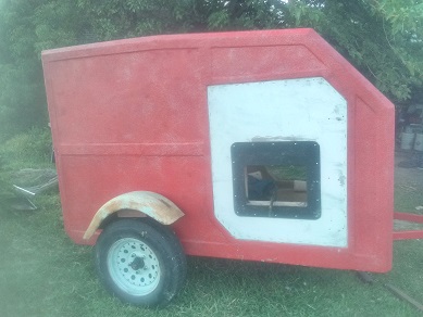

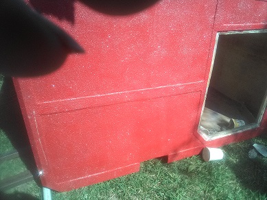

Finished my your a cheap as# bed liner used play sand .A bit of glitter in the clear coat. When we order a bit of axles all but one was 58 wide. it was 57'' and the last one .The pod is 58'' Wide .So will use a poc-light frame .Had to do some cutting out on the sides.1 by 2'' I/8 wall

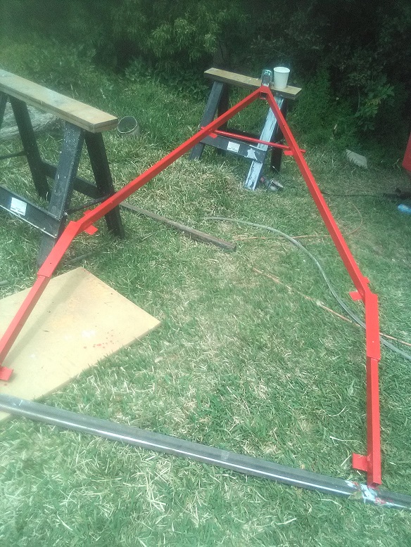

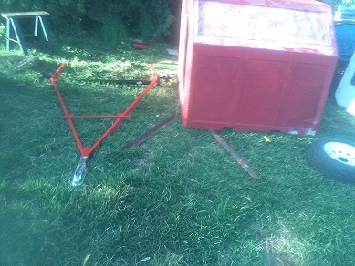

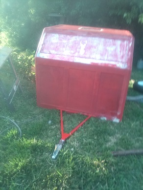

Rise I say .It can stand on it own. used premade 41% 3 per side and one corner 90 % as they can be placed anywhere with this one wanted higher front inter . But had to have two plains in front not as steep as the first one .even the little kick up in back is a 41% Trailtop components glue and go

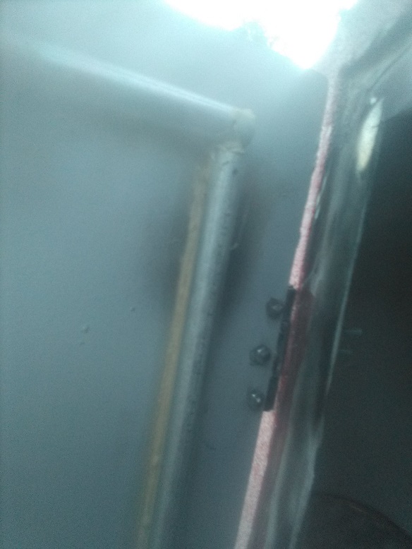

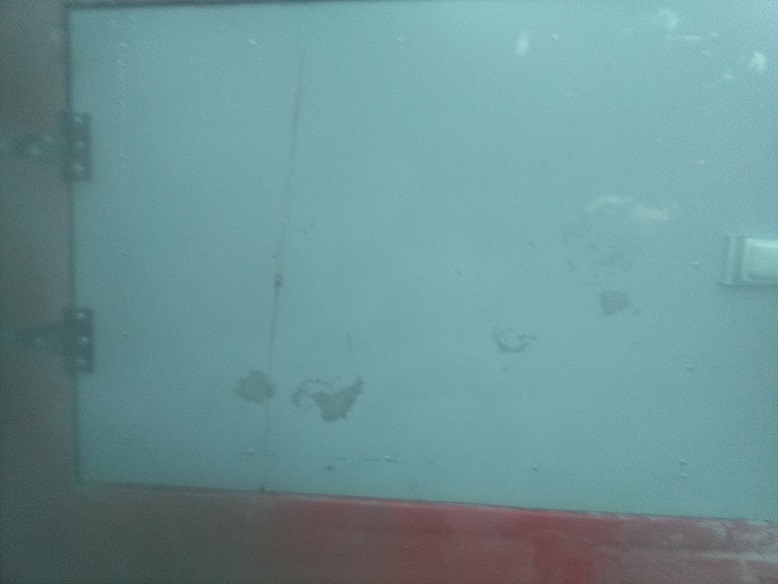

Quick easy fire resistant door/hatch .Had one of our trailers burn .Fool put burning camp stove is storage compartment then closed fiberglass/over foam door. So to build a FR door on the cheap and fast. If you did something like this .You would miter the ends of the 1/2'' emt Received some sheet metal cut to sides of opening .Hung . then used 1/2 EDM to make frame then pop- riveted to in side . one stick at a time. May fill in gap with body filler. :NC
