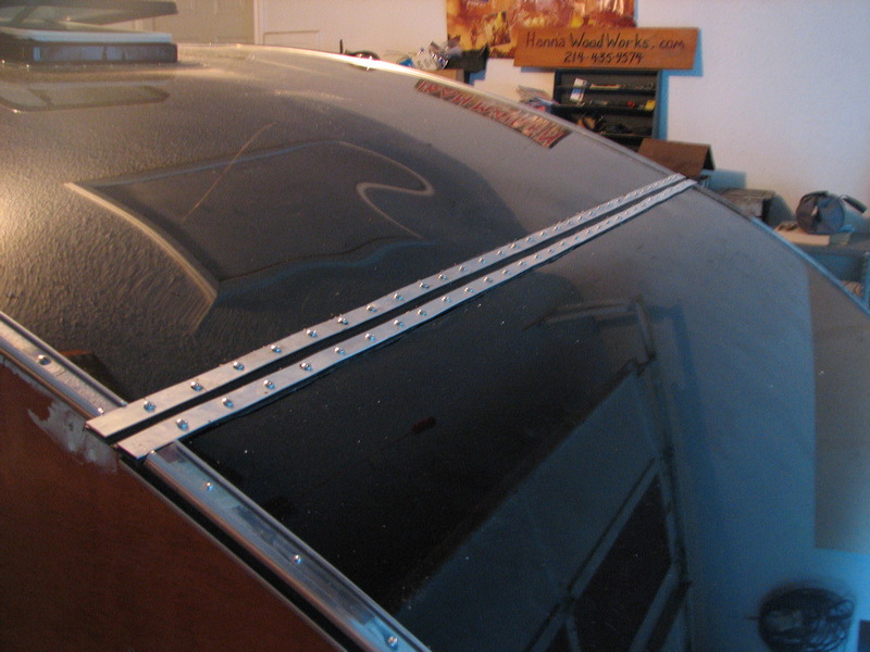

Postby 2bits » Tue Sep 11, 2018 10:15 am
Yeah I had to drag my vintage campers down to Hutchins for my VIN check too, that is good to know for the future.
For your door, I would check out what vintage campers are doing, newer campers are harder because everything is prefabbed and built into the door, which you could do I guess (get a new RV door and frame altogether, I see them on craigslist all the time for a 100-300) but using your own door, you can try a piano hinge style hinge and then cover it from top to bottom with some of that rubber that you get at hD that you attach to the bottom of your garage door (It's in the door sweeper section). For an even cleaner look although a little harder to install, instead of screwing into the face of the side, you could screw the rubber stuff under the hinge itself so when you close the door you don't see the hinge at all and only see the loop of the rubber as it goes over the hinge. You could get an aluminum drip rail over the door and just make sure it covers the top of the hinge too and you would be set.
I used a harsh environment plastic hinge on my rear galley hatch, I don't think it would handle the vertical weight but I'm posting the pic because if you decided to just install it over your existing hinge or a piano hinge with some aluminum strips to hold it down it would look similar to the pic, just imagine it vertical. I hope that helps!!
