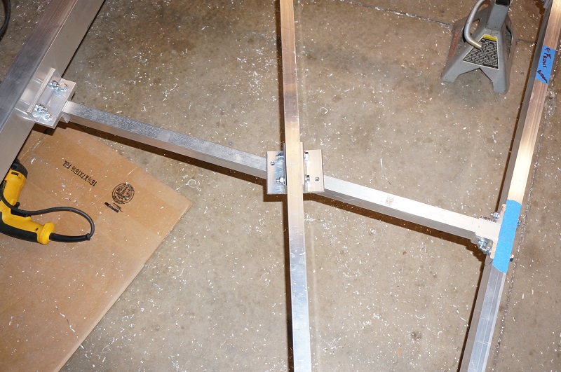

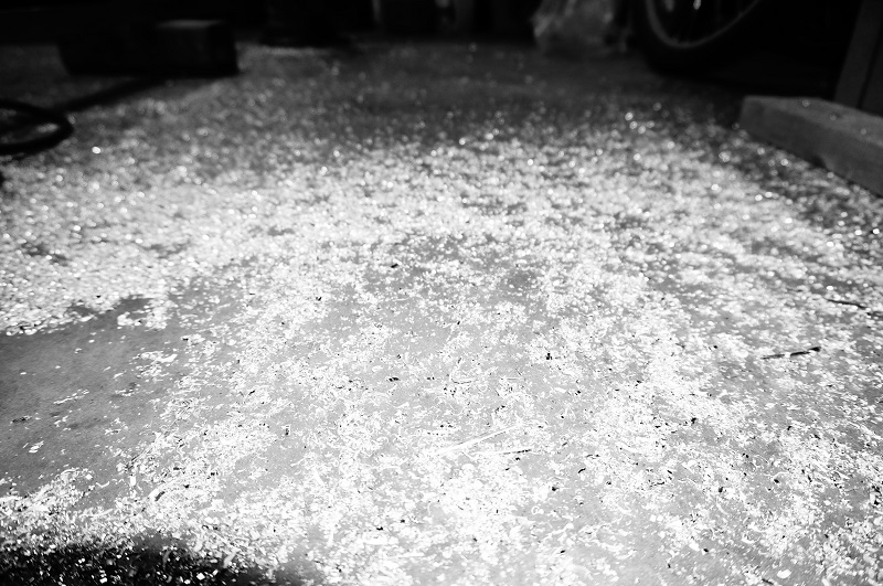

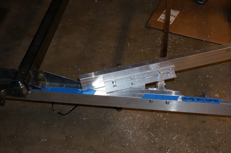

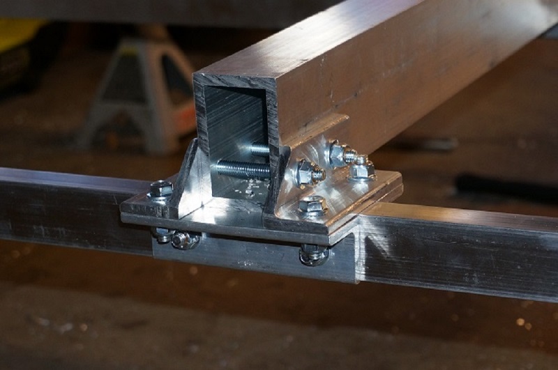

Postby StrongFeather » Sat Dec 22, 2018 8:10 pm
Another good day on the build. The A-frame/tongue angle thingys whatever you call them are pretty much installed.
And as an added bonus, it snowed inside the shop nearly all day long! It was totally awesome!
Okay, it may not be as glamorous as saw dust, but hey, aluminum shavings are pretty cool, too.
Here are a couple of pictures of the furthest aft tongue & cross member mount.
Only 3 attachments per post, so... To Be Continued...

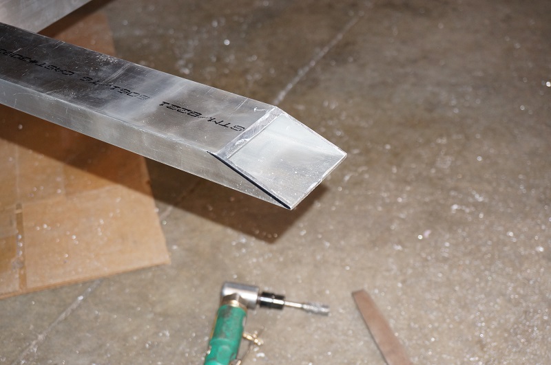

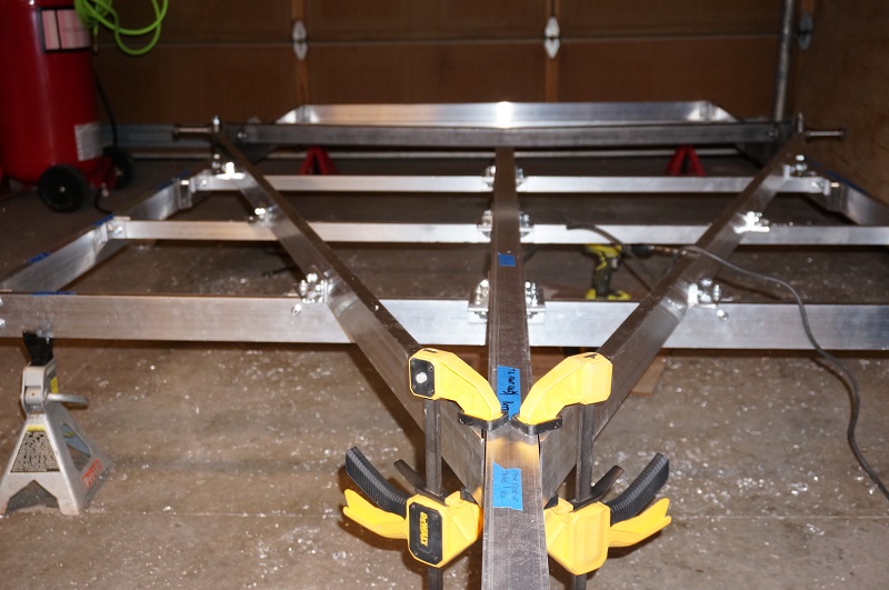

Postby StrongFeather » Sat Dec 22, 2018 8:15 pm
Mocking-up the A-frame tongue beams, the coupler (upside down, I know) and the tongue jack.
And the front cut on the A-frame tongue beams.
Nothing too exciting, but I've heard people like pictures...
MTF...

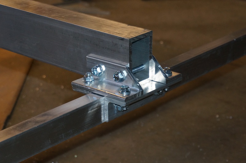

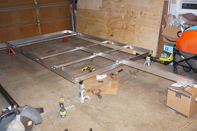

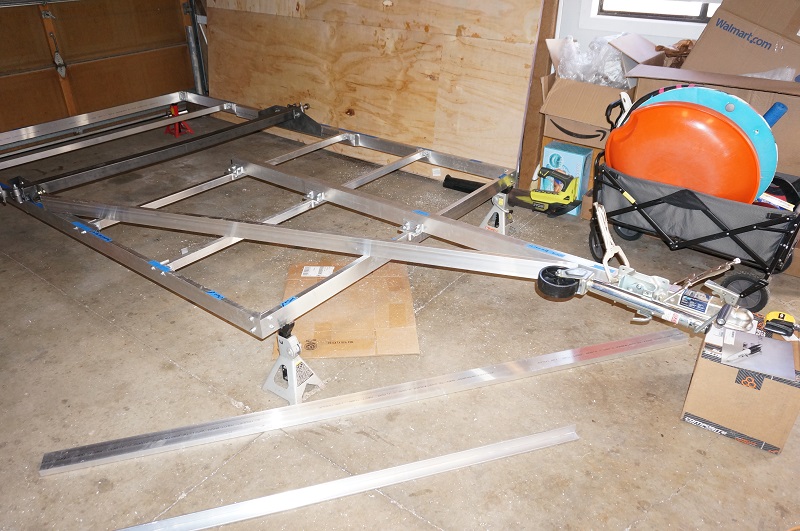

Postby StrongFeather » Sat Dec 22, 2018 8:24 pm
Here are a few of the fruits of today's labor.
This shot shows the A-frame tongue beam connection to the 1st floor cross member. The tongue is on the left and the main side rail is on the side. Once the floor is in place, a bolt will go through the brackets into the T-nuts in the floor.
And the rear attachment to the sister and main side rails, as well as the 2nd floor cross member.
And finally, a shot of everything almost done.
