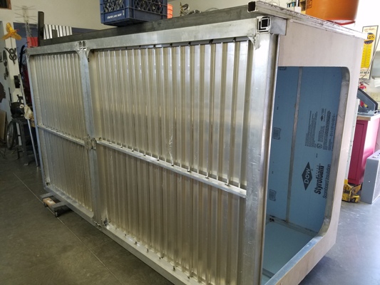

Not to much damage today when I rolled it :lol:
It's taller then I am. Not sure I will roll it for the other side :?

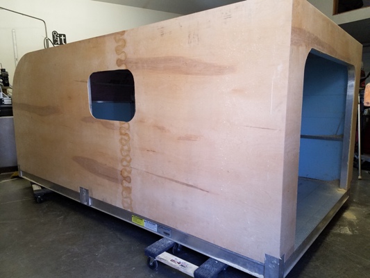

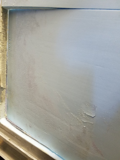

Postby twisted lines » Mon Jun 10, 2019 2:37 pm
Little Gorilla Glue Back in bidness!
Pretty tough but wouldn't support the weight
broken Foam.jpg (71.59 KiB) Viewed 6024 times
Yea I am flipping for the other side.
first side.jpg (75.6 KiB) Viewed 6024 times

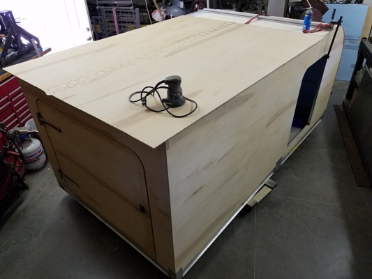

Postby twisted lines » Sat Jun 15, 2019 8:56 pm

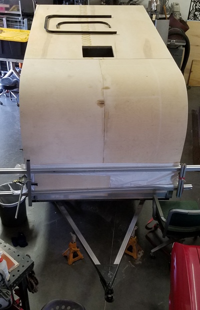

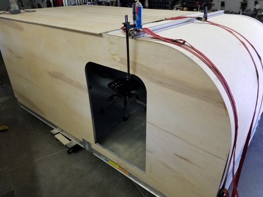

Still plugging away second side is glued on, the 65-1/2" top glued together and have found this is not something to do at my home :lol:
I am going to use it but need something to fill some voids prior to the monstaliner? (Tight bond 3 it is)
Started on the Axle today, and read, asked inside tire to frame clearance, and got 3/8" to 1.5" recommendations, I am at 83.5 wide in my head so want to squeeze it but not 3/8" what's too tight.
My bad I searched on this site and aggie 79 had just the number I wanted to find; Makes it 83.5 wide ;)

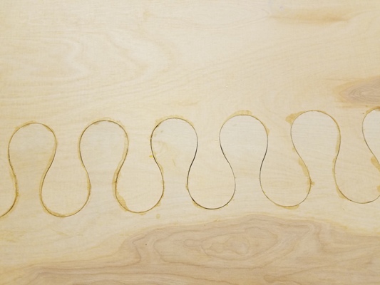

Front Radius 5x5 1/8" B Burch Doubled up still undecided :? any thought what to use to bond them together would be appreciated.
Second side.jpg (79.34 KiB) Viewed 5981 times
bulb joint.jpg (62.47 KiB) Viewed 5981 times

Postby twisted lines » Fri Jun 28, 2019 4:03 pm

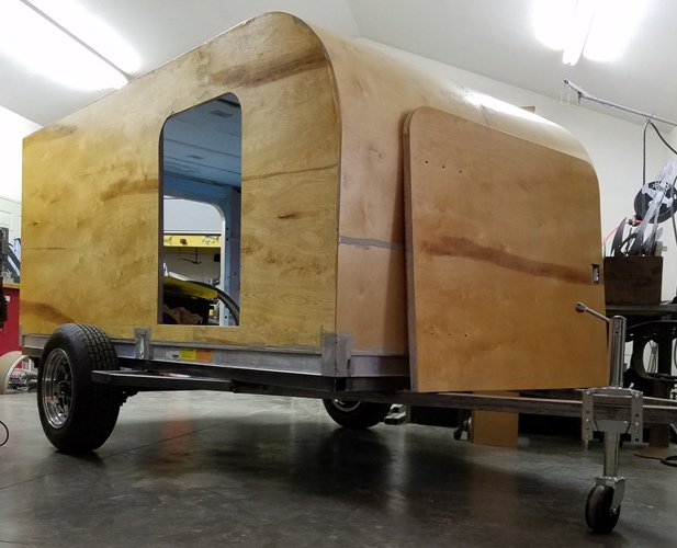

Last of the outside skins is on, as well as tires on the ground.
Now I have a day or two to shop for a tongue jack it's driving me more nut's not having one then I thought it would.
Last outside skin.jpg (94.25 KiB) Viewed 5939 times

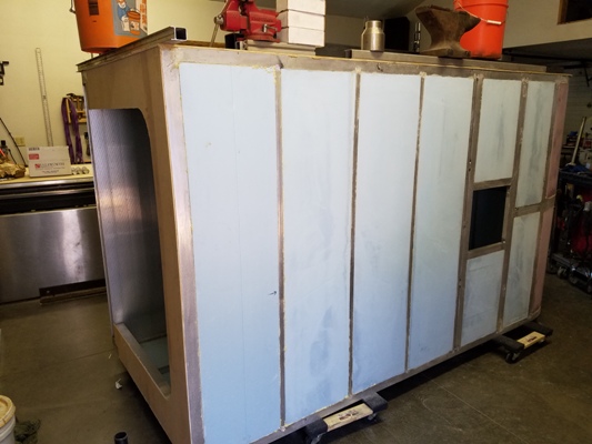

Postby twisted lines » Fri Jul 19, 2019 4:16 pm
Still plugging away; two steps back and one forward :lol:
In poly.jpg (111.15 KiB) Viewed 5798 times
