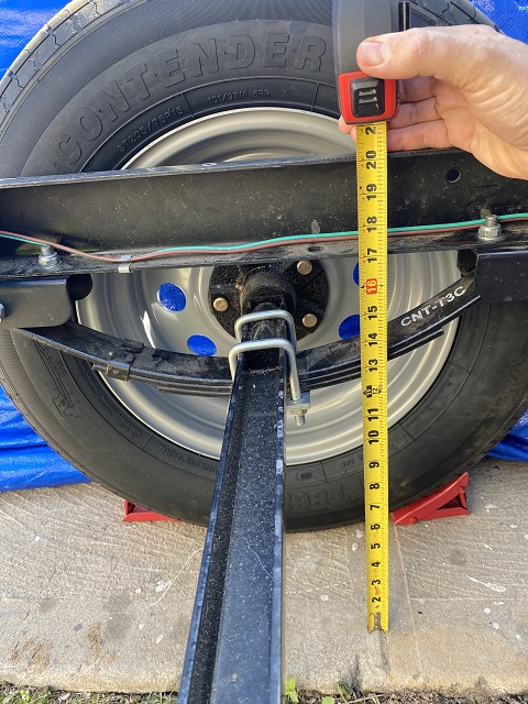

Went ahead slid the springs back 6", flipped the axle and checked the fit for the new 15" wheels. Interesting to note that the bed height ends up about the same as stock.
What is the consensus for keeping the stock M10 U-bolts for the underslung axle? I noticed that some people are beefing them up.

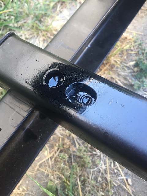

Since the frame width had been reduced by 2", I figured I would simply drill new center-bolt holes 1" inboard on each side. Turns out that the stock locations were off-center by almost 1/2 inch! So I had to grind one of the holes a little wider.

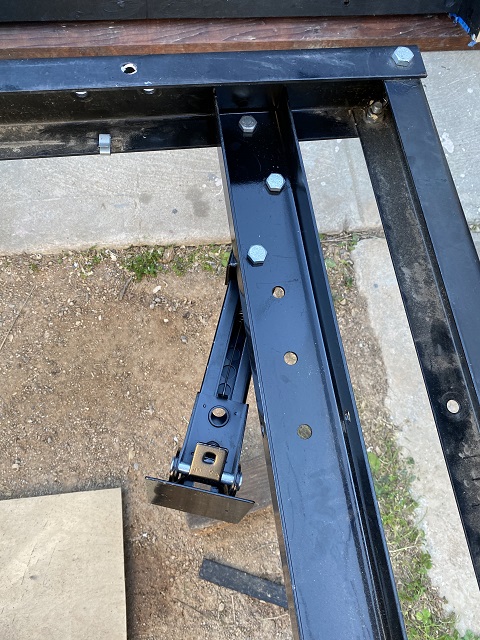

I repurposed the last cross-rail from the kit to support the stabilizer jacks. I don't know if they will be useful once I'm actually camping, but they should keep things sturdy while I'm building.

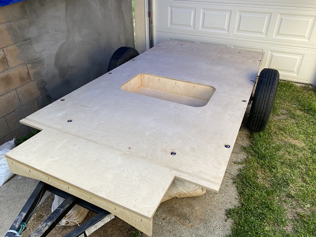

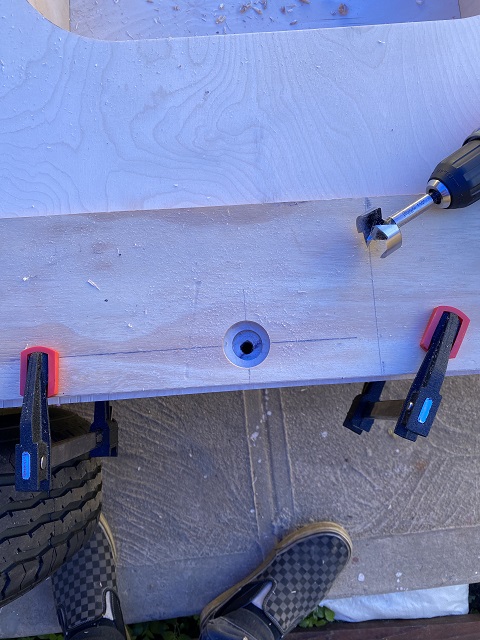

I didn't believe that carriage bolts would strip out of their holes... I was wrong. The first one I tried started spinning before I even got close to tightening it! Had to widen each counter-sunk hole to accommodate a torque washer, and this simple jig helped me do it quickly.
Now it's finally all bolted down!

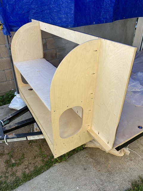

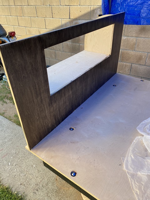

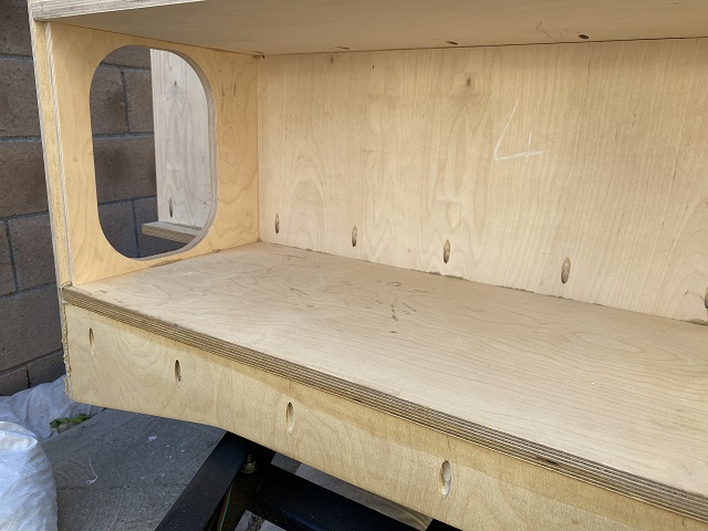

Headboard and tongue storage box installed!
The headboard is the only thing that will get stain. It came out darker than I had imagined, but not bad. Everything else will be clear poly.

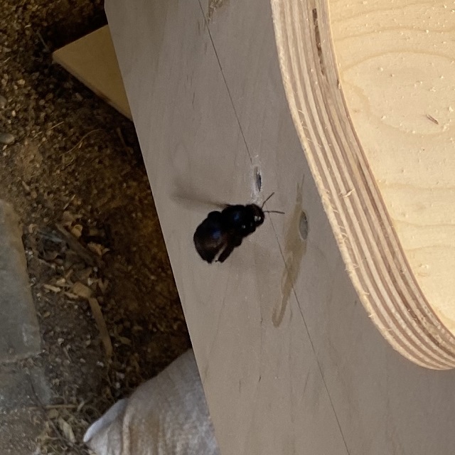

This bumble bee seemed attracted to the PL Premium. He did not go away for a long time, and would not respect social distancing!

I found out it's actually a California Carpenter Bee. That may be why it was interested in the fresh holes in the plywood.

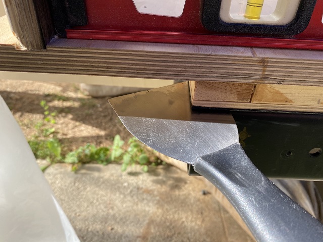

I was having a hard time squaring up the headboard when I discovered a slight warp at one corner of the platform. Found a gap between the frame and platform where a bolt head did not fully fit within the countersunk hole.
It seems like such a small problem, but if I ignore it I suspect I will run into more problems later on. I hate the thought of unbolting everything, and jacking up the platform just to re-drill that one hole! :NC

Postby eLink » Thu May 07, 2020 6:59 pm
:lol: That's what I'm afraid of! Better to do it now I guess, while it's still light enough.
