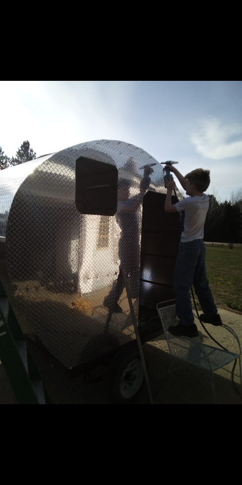

Postby Danomite » Wed May 01, 2019 7:51 pm
Since OSHA didn't show up, I guess I'll post this pic of my 12yo son running the pneumatic rivet gun while standing on the armrests of an old steel lawn chair. He's a pretty handy kid, apparently much more so than I thought. His shop teacher last fall kept questioning how he was so comfortable working with power tools. He told him he was always the cutter when we were hanging t&g knotty pine when we built our cabin. My oldest son (24) & I would be up on scaffold ladders and would tell him measurements, so he measured and cut them with the miter saw and handled them up to us.

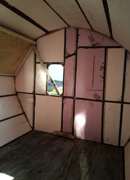

Postby Danomite » Mon May 06, 2019 11:49 pm
Over the weekend I got the insulation cut and stuffed into place. I also worked for several hours drilling & riveting all of the fill-in places. I had mainly just riveted the edges of the sheets when I put it on, but had not riveted every 6 to 8 inches on all of the crossmembers. I still have another couple hours to go on that, and then it's on to installing the 5/16" cedar tongue & groove.
BTW, the floor is 3/4 treated plywood. The reason I went with 3/4" is because I already had it. It was the sideboards on an old flatbed dump truck I bought to haul dirt, hay, and logs around the farm. The previous owner used it for hauling/holding grain, but sides are not of use to me on that truck. I coated the crossmembers with tar where they would contact the treated wood. After the interior is installed and polyurethane is applied, then I will install the vinyl flooring.

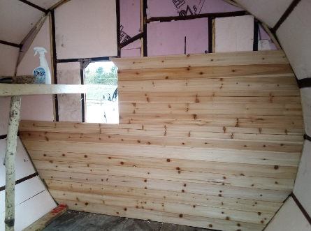

Postby Danomite » Fri May 10, 2019 12:00 am
Dodged the rain for a couple hours this evening and got a start at hanging the 5/16" thick t&g knotty cedar. It smelled soooo good when I was cutting the various angles with the miter saw. :)

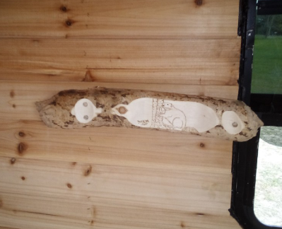

Postby Danomite » Thu May 23, 2019 10:39 pm
Ok, so I decided to decorate the inside with real beaver-chewed sticks and a talked my 77y/o mom into doing woodburning of a beaver chewing down a tree on a piece of a tree that a beaver chewed down. (Yes, let that sink in for a minute).
Yes, my mom rocks, and it took her about an hour to create this work of art.

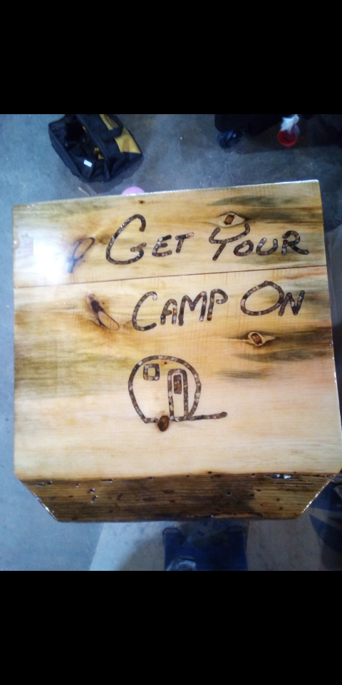

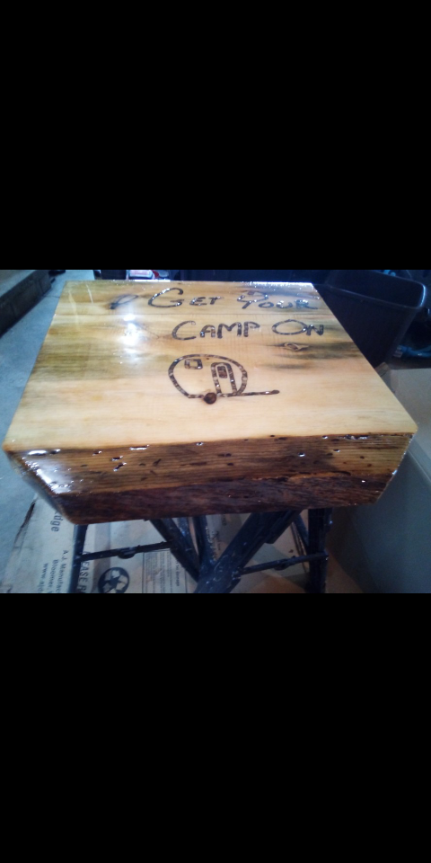

Postby Danomite » Wed May 29, 2019 8:01 am
Well, after I got Mom to contribute some artwork, I thought I'd create some myself. I had the 4-foot long butt-end of a 40 inch diameter White Pine log laying up off the ground for approx 8 years, I decided to get it cut up to make a dinette. The sapwood was rotted on one side, but the other side was still solid, but full of ant holes. I liked the look, rustic is kinda my thing. I sketched out my design in pencil and routered it out. I bought a 50 pound bag of small pebbles intended for landscaping for $2.50. and filled the routered channels with some of them. I then covered the entire top with an epoxy called Glaze Coat

Postby Danomite » Wed May 29, 2019 8:07 am
And a different angle showing the 2-inch thick tabletop with live edge exposed.

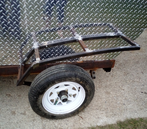

Well, I got the framework for some fenders mounted today. I will add a drop down bracket at the back, just in case they get sat on or stood on. I used 1/4-20 stainless bolts for attaching them, but they were priced as if they were gold plated!

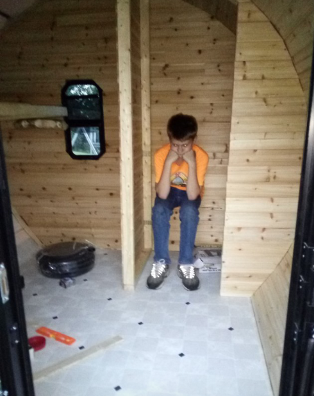

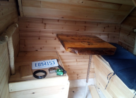

Postby Danomite » Sat Jun 01, 2019 11:47 am
And, I got the vinyl flooring down and the restroom framed in. The kid wasn't happy about me making him pose. I'm not planning on using the porta-potty all the time, just when the alternative is a pit-privy, vault toilet, porta-jon, or something else I find more disgusting!

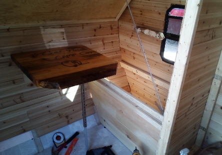

Postby Danomite » Mon Jun 03, 2019 12:58 am
I installed the table and built the driver's side of the dinette today. I made the bench go from the restroom to the back, even though the bed itself won't be that wide. The space under it will make for a good-sized storage area for camping gear and/or canned food.
With the tabletop being the only part that has a finish, it sure makes the rest look pale in comparison. Once I get the reminder of the woodwork completed I'll go after it with the high gloss polyurethane and that should remedy it.

I got the additional framing completed on the fenders and then stood on them to be sure they could handle some weight.

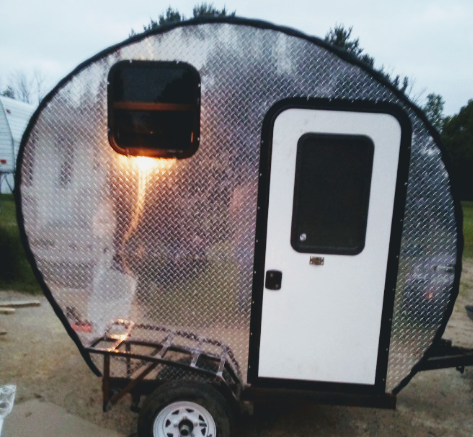

Postby Danomite » Sun Jun 09, 2019 5:19 pm
I'm not sure how well you can make it out, but I went my own way with the trim. I work at a rubber hose manufacturing factory in northern Michigan, so felt it would be appropriate if I used rubber hose for my edge trim. And just to avoid office politics, I went to Tractor Supply & bought a 50 ft roll instead of jumping through hoops to try to get some from the shop for free. I used 3/4" diameter "pump hose" (which was epdm). I split it lengthwise and used butyl tape over the joint itself and stuck the hose over it. I then staggered my rivets every 2 inches or so from top to side. I bought the black rivets on eBay for a little over $20 for 350. They worked especially good for this as the heads are 5/8" diameter.

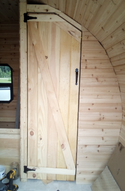

Postby Danomite » Mon Jun 10, 2019 10:31 pm
I got the door for the potty room built & hung today as well as working on getting a good start on the other side seat being framed in.
