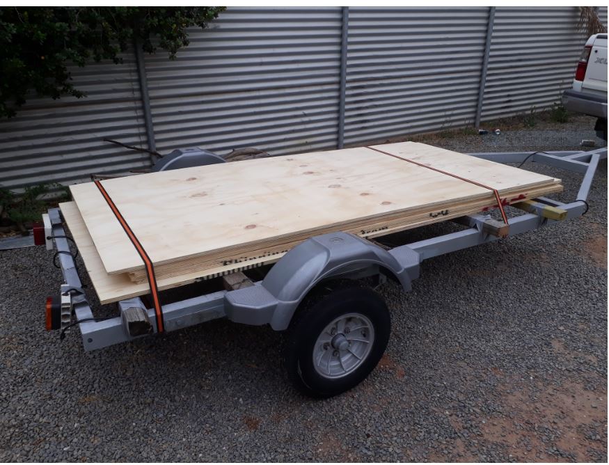

Postby MickinOz » Sat Oct 05, 2019 12:47 am

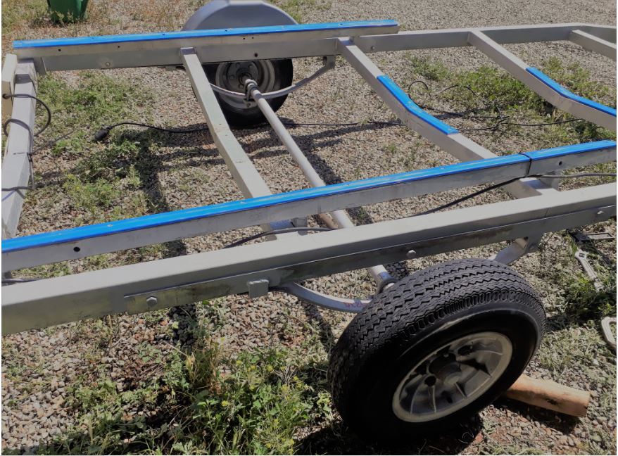

So, progress so far:
Fabricated new spring mount rails.
Took off the 2mm thick old ones, which were held on by 3 :shock: 7/16 machines crews each side. Some of these were loose. :shock: :o
Fitted new 5mm rails with mounts welded on. Drilled holes out and fitted 12mm metric bolts. Galvanised 4.8 grade torqued to 28 ft-lbs per recommendations from bolt suppliers.
Cut off the bilge boards that used to support the boat that lived on this trailer.
Removing the old spring mounts/rails removed the mudguards and mounts.
So I hacked together some temporary mounts that doubled as stringers to support the plywood on the way home from the shop.

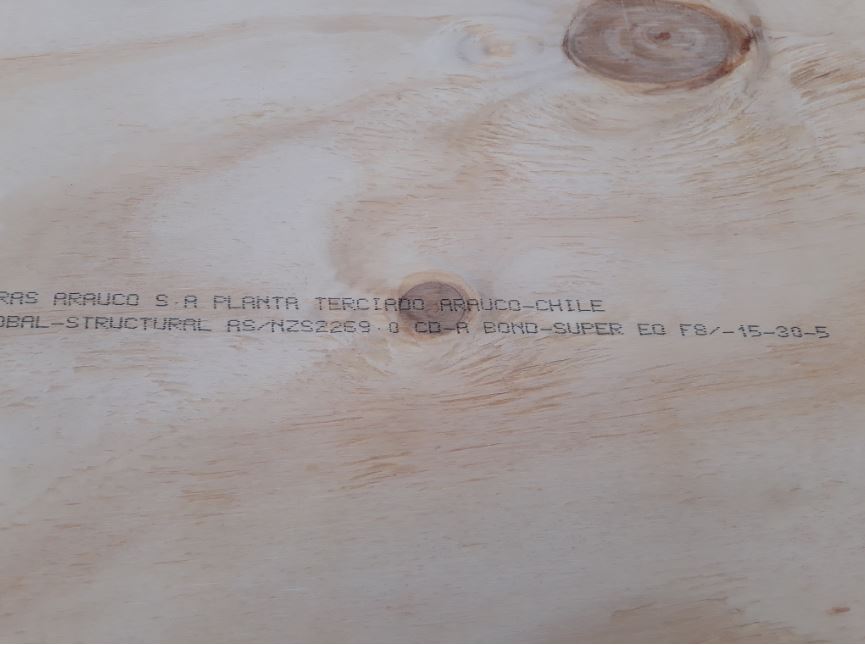

Bought the ply.
Total outlay so far for trailer, registration and transfer fee, new spring mounts, new wheels, 6 sheets of plywood, fuel, etc is $1200
Ply is labelled as "MIN 450 kg/m3"
Lets say it's 500kg/m3 on average.
Then those 6 sheets weigh something like 140 kg.
Plus the 150 kg or so that the chassis will weigh with the new wheels, I'm up around 290 kg. before I add the roof sheets and if I use all the ply I just bought. Might end up at 400-450kg with the mattress (40kg?), water (30kg)and battery (30 kg) the time i'm finished. I'd be happy with that I think.
