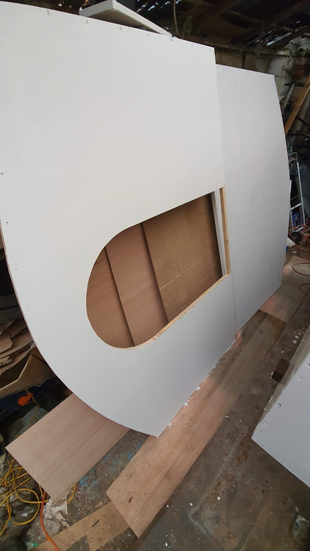

Postby MattLV » Tue Mar 22, 2022 7:00 am
I haven't abandoned this build, I'm just very very sloooooooow :oops:
Here's some updates,
Putting together the upper door, complete with porthole 'window'
Here's the top half put together with the roof beams..
And taken apart again so I can fit the draught excluder strip
MattLV

Postby TimC » Tue Mar 22, 2022 9:30 am
MattLV wrote:And now I have the mechanism built, it's time to try for a proper lift... :frightened:
Now you have my attention! Build on. I hope we can see details of the lift mech.

Postby OP827 » Thu Mar 24, 2022 6:32 pm
It is a big milestone, looking great! I like the lifting device simplicity. Finding the correct lifting point location would be important :thumbsup:
