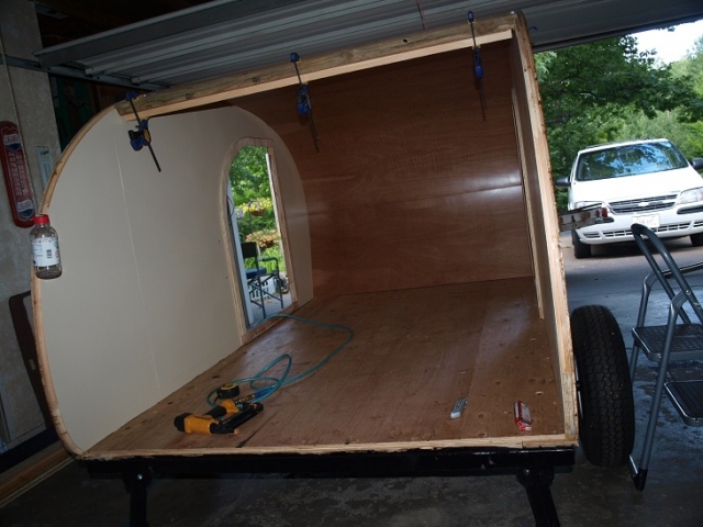

Our ceiling is poly varnished lauan and it is cut, assembled into one piece and pre-finished on the garage floor before installing. Same Fredrick "inside-out" method of ceiling/roof construction that I used on my previous TDs. So, interior walls may still be PMF'd before that ceiling is installed.
Similar to this, but from ceiling out will be lauan, 1 1/2" foam, PMF vs lauan, spars and foam insulation, two layers of lauan and PMF

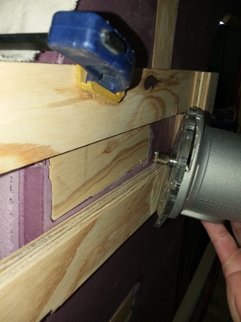

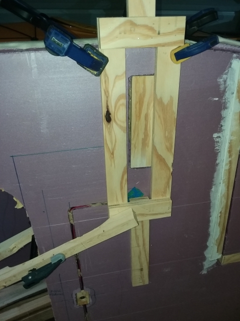

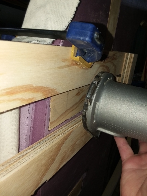

Despite clamping the cleat faces to keep them flush many of them sit proud of the wall. Made a router jig to shave off the uneven bits.

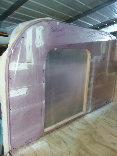

Doing a little work to finish up prepping interior walls for PMF. I think PMF is the way to go. We'll put a good overlap on the floor/wall corner that will help secure the wall. Over that we'll put a trim peice in that corner that will be able to be screwed into the floor as well as the cleat face along the bottom of the wall.

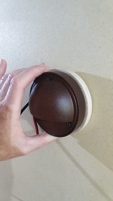

The porch lights will go here, just to the side of the door. I need to bury some cleats in the foam for anchor points. Then finish spackling the walls.

I like the look of that porch light.
Where did it come from?

MickinOz wrote:I like the look of that porch light.
Andy ordered them from here... https://bestprolighting.com/product/step-deck-light-bpl400-rst-8
They come with a " 12V JC Bi Pin 20W bulb". Not sure what that is. An LED bulb option is $14 extra. Andy found a pack of five LED bulbs on Amazon for around ten bucks. They are built well. Better than most RV lights I've seen.

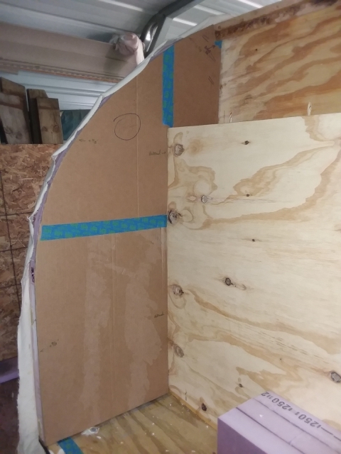

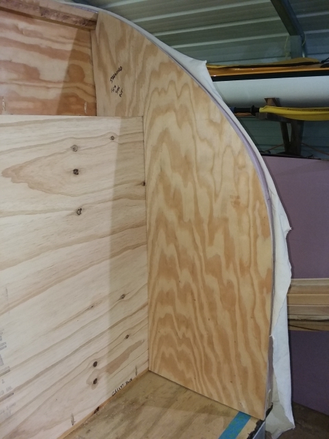

Due to the heat and humidity this weekend I'm tackling some jobs that take me to the cool basement workshop. I've made treated lumber spacers to mount the fenders to the frame. I also laminated and machined the mating pair of 1 1/2 inch maple to mount on top of the bulkhead that will eventually hold the hatch hinge. One half is mounted securely to the bulkhead and the other half is the hatch top frame member that will anchor the hinge.
I put another layer of spackle on the interior walls. That is going slowly. Several coats have taken days to harden up with the intense humidity we are having. Very humid days were rare up here until the last year or two. Something is going on for sure. We usually "enjoy" a stretch of several weeks of dry spell in late July and early August. This and last summer there is no sign of drought. And the mosquitos! They are usually gone by August except in the deep woods.

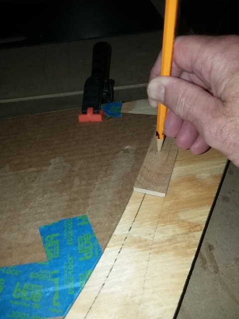

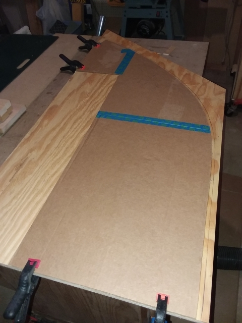

Another task I could handle easily without Andy is plywood facing for the galley. I just happen to have a decent piece of 1/2" ply (thanks Menards for always packaging my lauan shipment with useful materials!). First I made a cardboard template for the port and starboard sides.
Transfer that to my ply.
Add a 3/8" "gutter" to keep water out.
Fits! Now adding some stretigic pocket holes to anchor it to the floor and bulkhead. I'll also glue the ply to the foam.

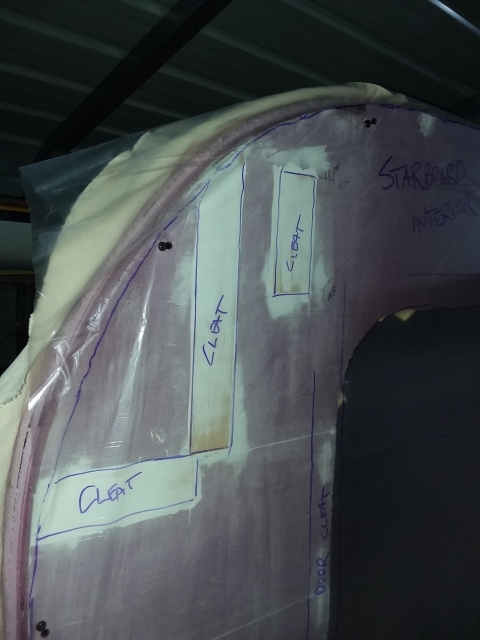

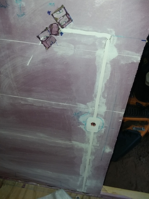

Next up is finish spackling and scratch the foam to prep for PMF. I must remember to make a legend for the locations of cleats and wires before we cover everything up with PMF! More on that in a later post.

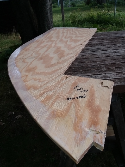

Thought I would waterproof the edges of the galley wall faces where water may reach. After doing some research I passed on epoxy resin and I'm going with Titebond III. Other posts have reported good results waterproofing with this and seeing as I expect little water to reach this wood and TBIII being readily available it was a good choice.
I'll sand them smooth and add another coat before installing these.

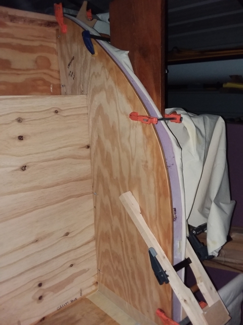

Anchored the galley wall faces with pocket hole screws and PL Premium. Had a spare 4" roll of fiberglass so I thought I would use it to help glue the wall to floor.
A clear poly drop cloth helps record cleat and wire locations. It will come in handy to locate anchor points for hooks and cabinet frames after covering the interior with PMF and paint. when the camper is finished its easy to fold up and stash below the mattress for future reference.

Postby pchast » Tue Aug 11, 2020 8:46 pm
:thumbsup: Great idea.....
Why didn't I think of that?
Maybe mark the wire runs too..

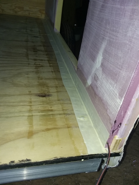

Postby TimC » Sat Aug 15, 2020 6:47 am
Getting a few items out of the way before the weekend. Work session with Andy this weekend and I want to be prepared...

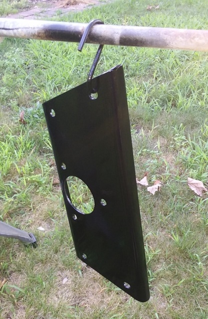

The a-frame tongue jack plate was finished by the local welding shop and I drilled mounting holes and painted it.

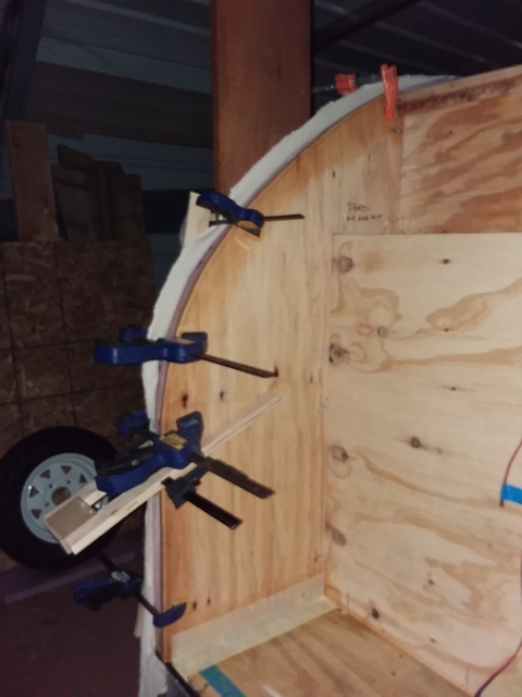

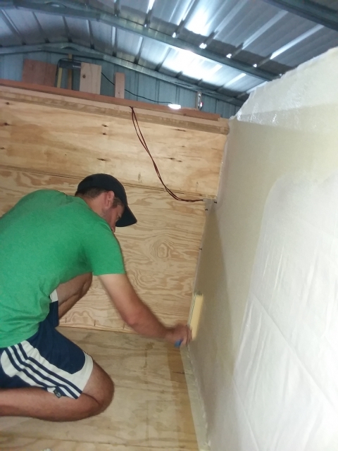

Added some fiberglass to the floor/wall seam after realizing the 4' wide canvas I bought was only 4'wide. Doh! Wanted a little extra help holding that joint.
Andy arrived! On to PMFing the interior walls.
