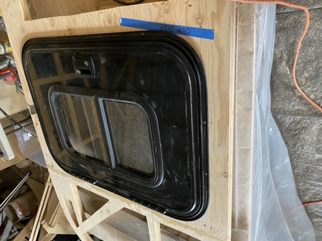

I spent most of the day on our generator while they worked to restore power to our community and upon reading the Tightbond 3 directions of 45 degrees up there was a change of plans. I fitted the doors, marked out the wall insulation and cut the hinge strut slot with a template. I also started on cutting inside panels in preparation of warmer temperatures, but not happening today either.
