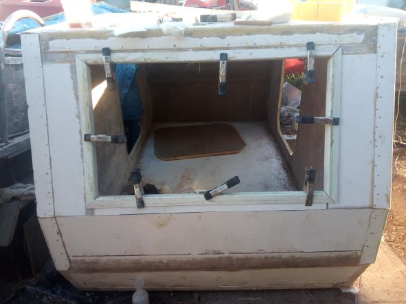

Re: fast, cheap, fiberglass/ foam stressed skin panels
Postby saywhatthat » Sat Jan 29, 2022 11:06 pm
Door if you buy premade one they can at least get you a nice motel room and a box of chocolates and dinner.
The most important part is the door jamb and seal.
By the way those drop down horse trailer windows the most sell as doors they're $175 each on a skid of 60
The pod I'm building will probably last well over two hundred years and most door companies we'll be long gone
The door jam that I'm doing you just need two pieces of angle and some type of seal.
Made fiberglass angle that will expand with the pod.
install the outside angle then trim to the inside
on the inside angle trim down one side for your bulb seal to set on and door to reset on.
I like a big deeper channel that way I can put in dust brush & bulb seal
