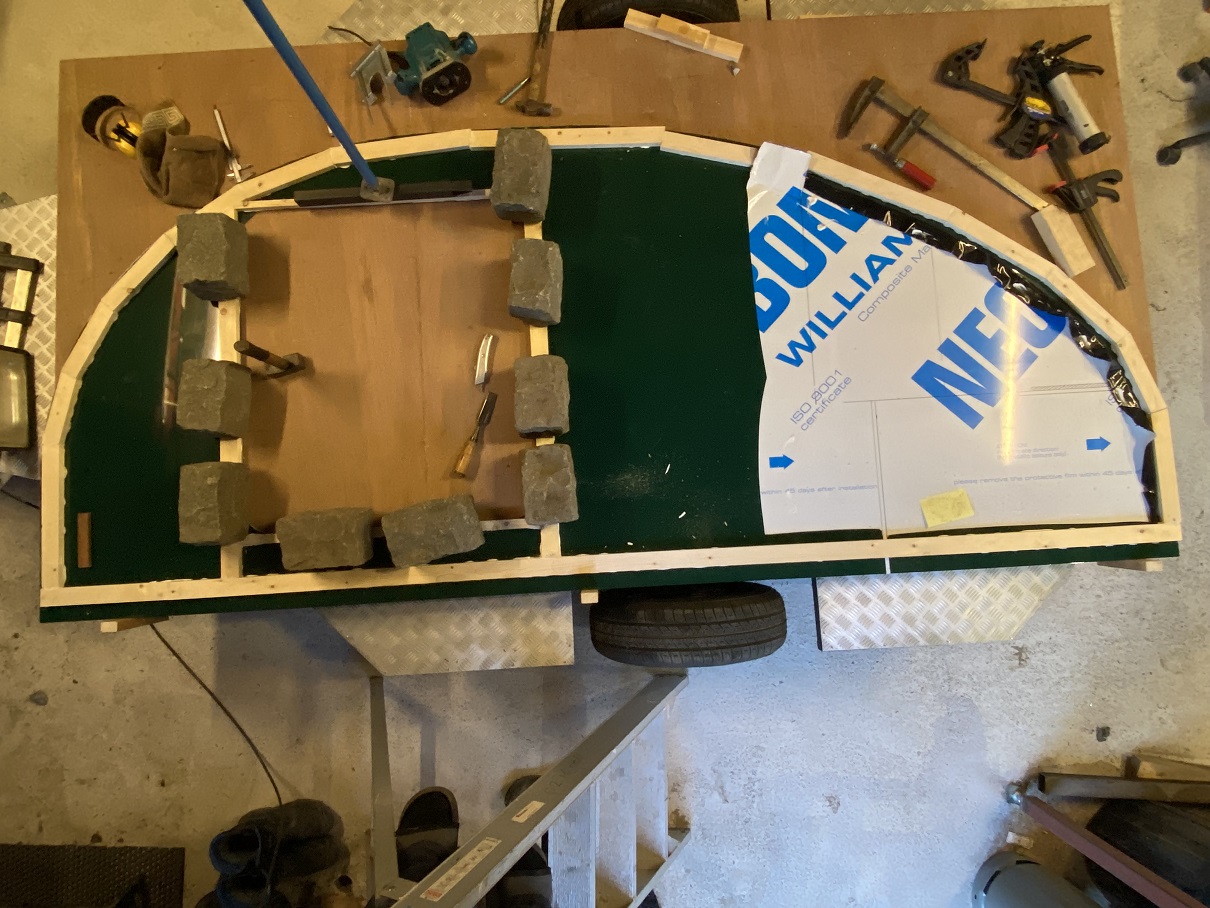

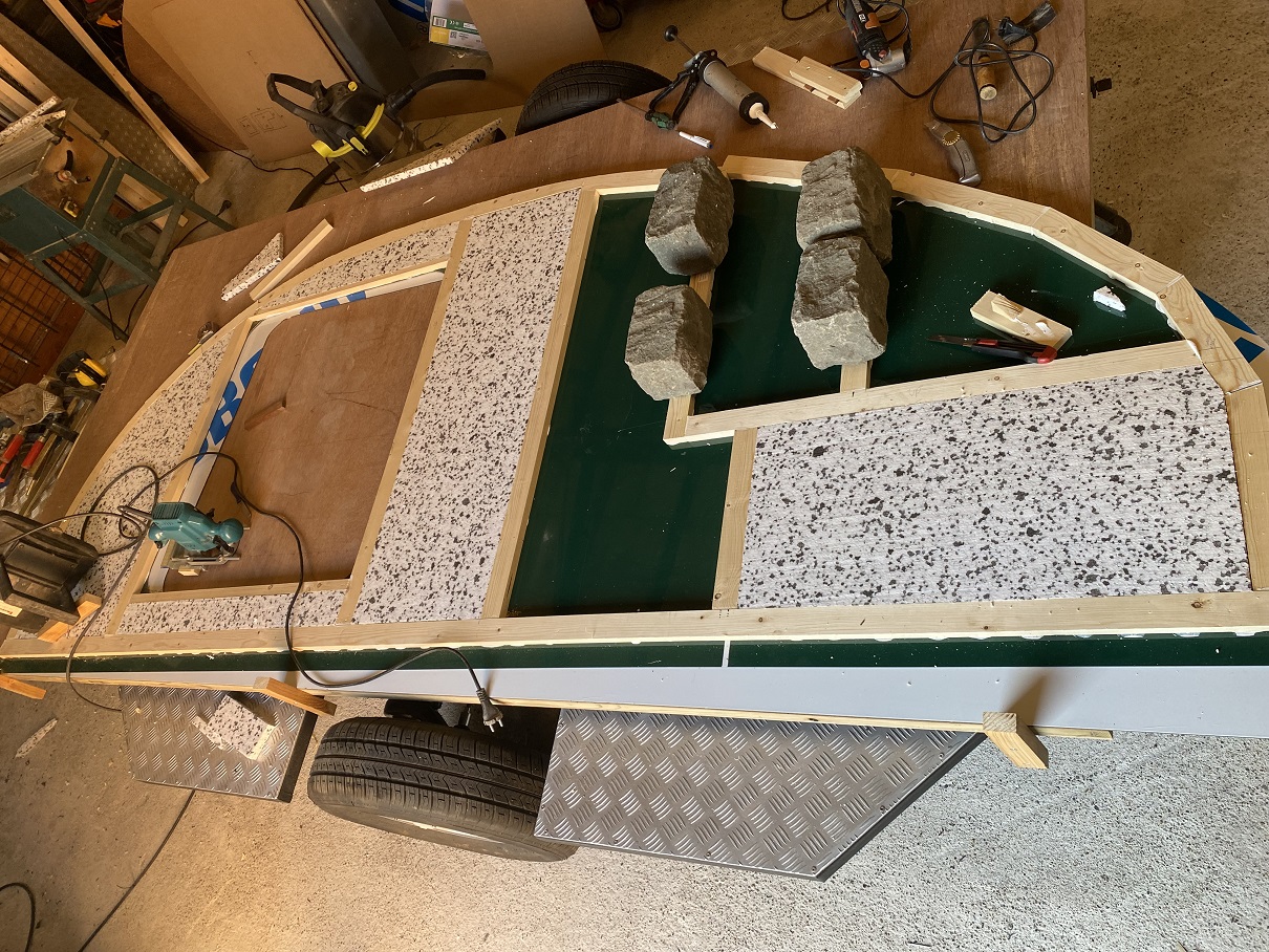

Postby Marcogs » Mon May 16, 2022 3:25 am

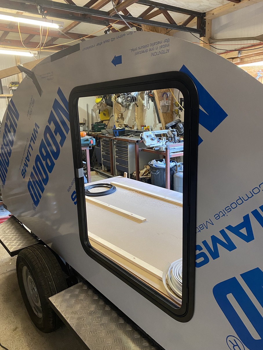

Progress :)
This weekend almost finished the first wall.
Tomorrow the cable for the outdoor lighting and the inner sheet of plywood.
Marcogs

Postby TallGuy7 » Mon May 16, 2022 2:09 pm
Wow, that looks good! Progress indeed.
What kind of glue did you use to glue the polystyrene to the aluminium?
I am asking because I am also considering to glue the Dibond directly to the skeleton and polystyrene. Looking at other builds it looks to be common practice to add an extra layer of thin plywood, so the wall is made up out of 4 layers: aluminium, thin plywood, insulation (incl. skeleton), thin plywood. I simply do not see the benefit of this method. Imho it just adds weight. What are your considerations to this aspect of the build?

Postby Marcogs » Tue May 17, 2022 3:38 am
TallGuy7 wrote:Wow, that looks good! Progress indeed.
What kind of glue did you use to glue the polystyrene to the aluminum?
I am asking because I am also considering to glue the Dibond directly to the skeleton and polystyrene. Looking at other builds it looks to be common practice to add an extra layer of thin plywood, so the wall is made up out of 4 layers: aluminum, thin plywood, insulation (incl. skeleton), thin plywood. I simply do not see the benefit of this method. Imho it just adds weight. What are your considerations to this aspect of the build?
Hi,
The glue/kit i initially wanted to use was not strong enough. I came in contact with kitcentrum.nl and i finally ended up by Zwaluw Hybrifix 302 kit. Its an solvent free glue, so if you want you can you can use it also for the Styrofoam.
I personally wil not glue the foam. It just clamps between the dibond and the inner wall/plywood sheet.
I'll go with your theory that the extra layer plywood is not necessary, but we will use dibond and that is more stif than a single layer of aluminum. Think that is the reason.
Marco

Postby TallGuy7 » Tue May 17, 2022 10:10 am
Thanks for the tip! I used Zwaluw PU construction fix to glue the polystyrene to the inside wall (ply).
To glue the dibond to the wall I am considering Dekapur 2k polyurethane glue. This glue is used in repairs of caravan walls and it glues the wood and polystyrene and requires little clamping and looks perfect for the job.
Downside is that is is very, very expensive.
I will look into the 302…

Postby Marcogs » Wed May 18, 2022 2:02 am
TallGuy7 wrote:Thanks for the tip! I used Zwaluw PU construction fix to glue the polystyrene to the inside wall (ply).
I can tell you this, the 302 is brutal. I almost teared off the topcoat of the dibond.
Marco

Postby Marcogs » Thu May 19, 2022 5:12 am
Yesterday evening.
Hot as hell, but what you gonna do :roll: :roll:
Gluing the innerwall.
I don't have a big press, so needed to be creative :thumbsup:

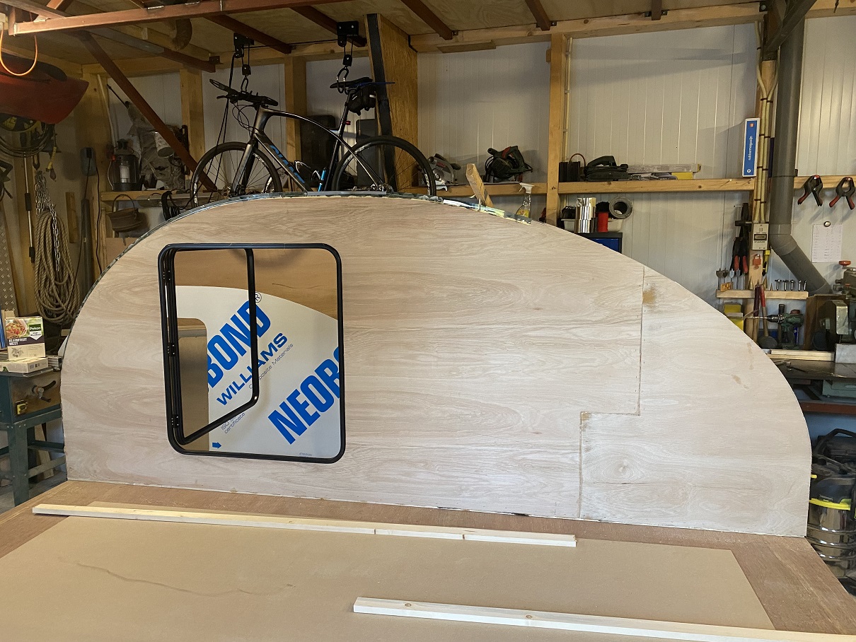

Postby Marcogs » Fri May 20, 2022 1:44 am
Succes :applause:
It turned-out to be great (well in my opinion)
The door frame fitted very wel.
it looks the part. This weekend I'll start with the left side.

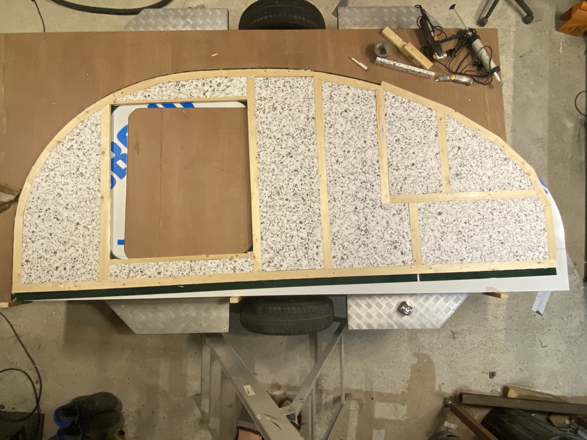

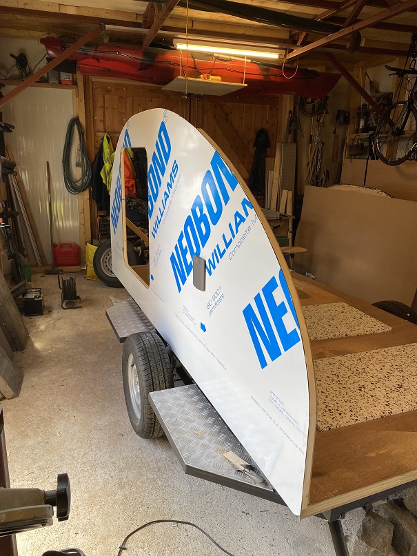

Postby Marcogs » Wed Jun 01, 2022 1:04 am
Second wall finished :applause:
This weekend I'll place the first (right side) wall, and the inside sheets of plywood for kitchen.

Postby Marcogs » Sun Jun 05, 2022 6:35 am
The weather is bad, but progress is made
