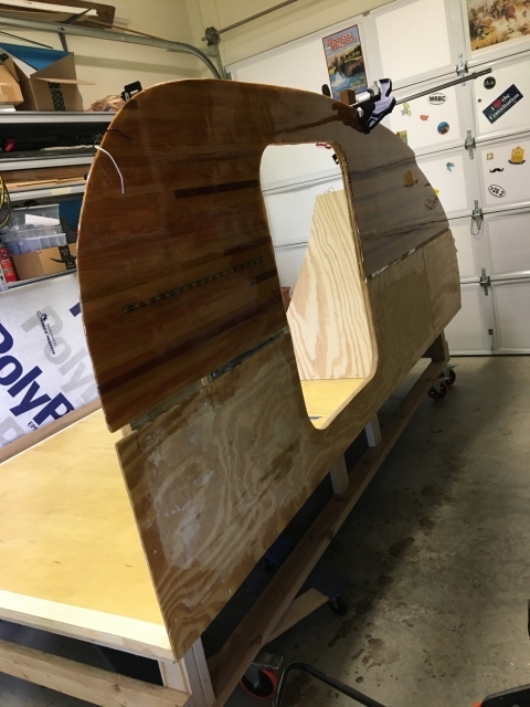

Ok, I got the epoxy cleaned up. Thanks to all for the suggestions, particularly swoody126 and TCJ. I used the card scraper, which is really cool...much better than sanding. It did take a while for me to get the hang of it…not so much the actual use, but the sharpening. But eventually I got the burr right. And I did have to resharpen pretty frequently…the epoxy is hard on the edge. (I had to wait for the scraper and burnisher to come in, and the epoxy kept curing….)
In spite of swoody126’s admonition, though, I still managed to catch the corner of the card a couple of times and made gouges. So we have decided to cover with wallpaper after all. Actually, my wife got excited about picking out a pattern.
A couple of notes….if you remember, I am wood-stripping roughly half-way down the exterior wall, and aluminum sheathing the bottom. Knowing what I know now, I should have left a little more meat on the skeleton at the transition. I have a couple slight bows that apparently developed in on one wall during wet sanding. They are just lifted 1/8” or so right at the edge for a length of maybe 6”, in areas where there was a span with no glue support. I am surprised that it bowed a little after the epoxy cured, but there it is. It isn’t too bad and I will be building up the epoxy a little at the (thicker) transition board anyway, but on my next build….
Also, I see the skeletons (3/4” treated ply) don’t lay perfectly flat on the bench. I am hoping it won’t take too much coaxing to plumb when I put the walls up.

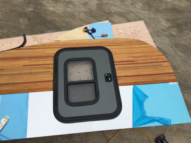

An update: I feel I made a lot of progress in the last 2 days. I got the aluminum exterior cut and routed, and got the hatch side walls cut off. Also I bought a stick of 2"x1/8" plate steel to practice welding on, and my first attempts aren't devastatingly bad...I figure I'll practice 2-4 weeks or so before I have the confidence that my welds are good. YouTube is invaluable, and doing some forensics and testing on the welds (cutting them open or beating the tar out of them) gives some confidence. While at the metal shop, I checked prices....a 20' stick of 2" x 1/8" tubing is >$120 with tax. Plus I finally picked up my 3/4" and 1/2" Baltic Birch boards...the 4x8 sheet of 3/4" was also right at $120 with tax! So I took up this project when I finally had time, but the economics aren't cooperating!
I dry fitted things together just to see....the aluminum has a blue film on it, which I peeled back a little. I won't actually fit the aluminum until the wall is up to avoid scratches...which I know will happen one day!

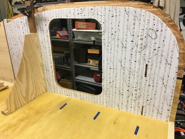

Postby orourkmw » Mon Apr 25, 2022 2:10 pm
Just an update. Got my first wall up and wallpapered to cover the epoxy mishap I had on the thin-veneer poplar ply interior wall...the birch tree design my wife picked out is nice, and I think will lighten up the cabin. Have decided on my stove and cooler. Thanks to Garth for his offline help; I will orient mine "sideways" like he did since I won't have Tony's heater. Ordered the aluminum trim and hurricane hinge today from Vintage Technologies. Have cut bulkheads and headboards. Decided to use southern yellow pine (SYP) for roof spars. Garth had been surprised when the (5) 1"x8"x10' boards cost $200 last fall; now the big box has them at $64 ea, or >$350 incl tax! I thought pine was not as strong as poplar, and that is certainly true of white pine, but SYP is stronger. The boards are #2 - uglier - but they are hidden in the roof, and the cost totaled $120. For the hatch spar, though, I decided to go with oak. A 1"x12"x6' board is >$90 with tax! Aargh! But I will cut it down, laminate, and mill to a 2" square for the hatch spar, and also use for the headboard slider rails. Everytime I spend that much money on one of these boards I remind myself "better not screw up this cut!" Should have the second wall up maybe by the end of next week, when I can line up some help.

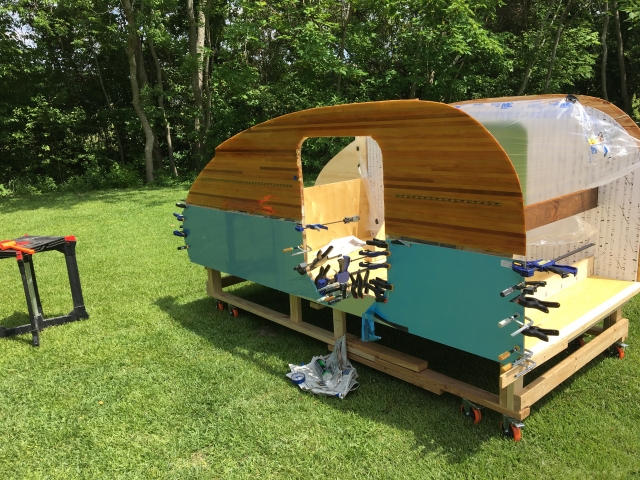

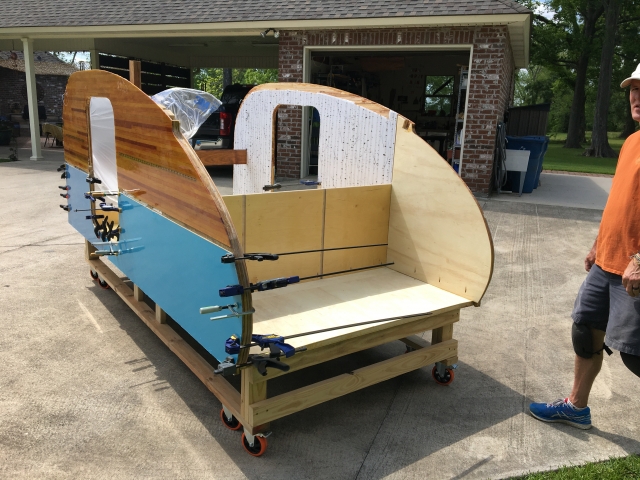

Postby orourkmw » Fri Apr 29, 2022 4:05 pm
Well, I finally got to the point where Tony's #4 was on 7/2/19, JoeGrz was on 5/28/20, GarthB was on 5/29/21, and most recently VanIsleDave on April 16....I have the walls up! It feels so good, and only partly because I don't have to always work around and move those walls!
The assembly went well; in fact, so well that I decided to contact cement the aluminum sheathing on while I had extra hands. Yay!
