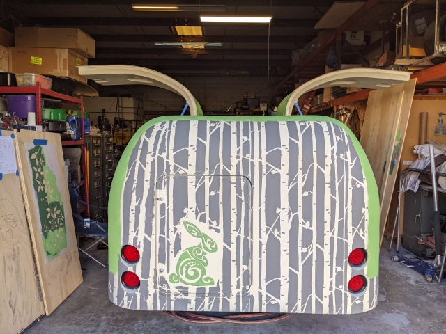

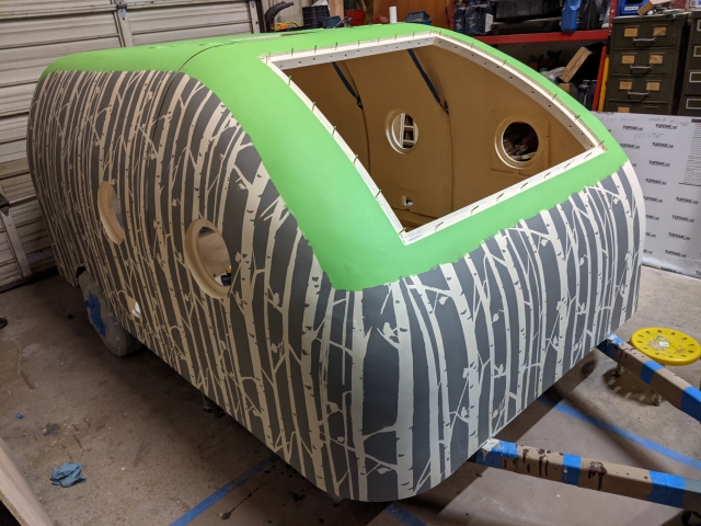

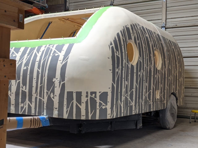

Now despite it looking egg-smooth after primer, I could still feel some of the surface imperfections, as well as the glass overlap. So I wanted a paint scheme with vertical elements to sort of break up the continuous surface and better hide all the things I didn't want to look at. I also liked the idea of a nature-inspired look as opposed to the big RV schemes that are either super-generic or stick out like a sore thumb in a campground (who doesn't love a bright-red 35-footer named "Destroyer" or "Conqueror?" :frightened: )

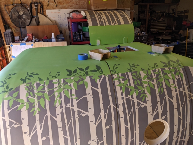

So I went a bit deep with Etsy stencils, choosing birch trunks for the main scheme (appropriate since most of the wood is birch-based), with a green top canopy and leaves overhanging. Paints are all acrylic. UV protection to be imparted by clearcoating. I'm not 100% crazy about the final look, but it's been growing on me quite a bit and am very content with the look. The green looks way too neon-ish under fluorescent lighting but is the nice flat I envisioned when in the sun or in natural light. Should have probably darkened it a bit, but that may sort itself out with clearcoat aging and patina over time. All else failing, I can always repaint later.
This was the stencil size for the birch - set in place, paint, remove, clean up, repeat. Used foam rollers and the paint laid down reasonably well. In places it's thicker, but this imparts it a texture that I kind of really like now.
I left the curves for last, as I knew those would require some extra work. Stencils are great for single-plane curves, but add another plane curve and there's a whole bunch of lifting and cleanup needed.
Some places I had to fill in by hand, which was tough because I am very artistically challenged.

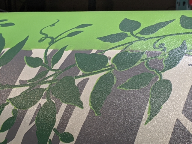

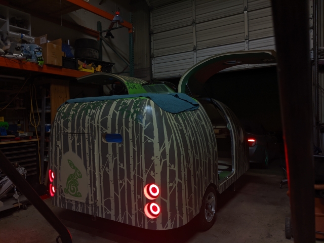

And first layer of leaves. The second layer was with the dark, leaving the light edge for more depth appearance.
The bun, my spirit animal, making an appearance - I kind of winged this part, and I'm ok with it

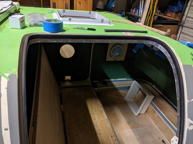

The door seals installed. Prior to that, I seam sealed both vertical edges of the water channel, including epoxy coating before and after the seam seals. We'll see how it holds up.

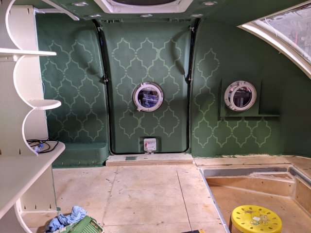

Postby Dan [Sac] » Wed Nov 30, 2022 2:59 am

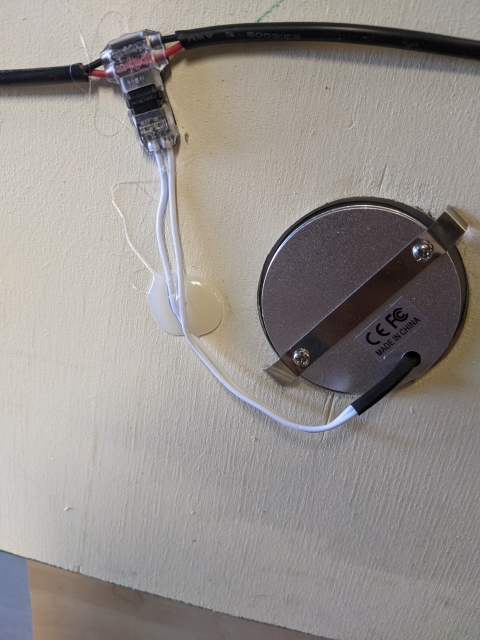

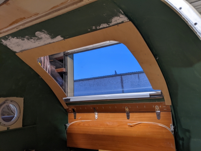

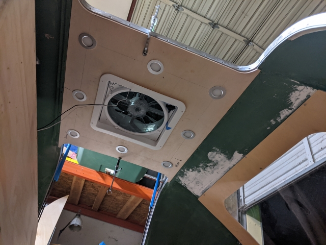

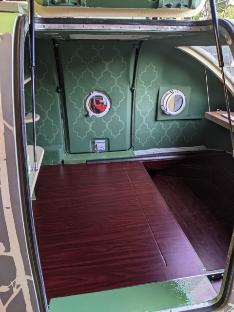

Interior work came next - I used the pretty popular slim LED interior lights (Amazon item# B07PGV11HK), eight in all, daisy-chained. They fit perfectly in the small overhead space, and as a bonus they're dimmable.
To make the install simpler, I used these inline connectors (Amazon item# B07114RK67). Still a little bit of a pain, but it worked. Trusty hot glue gun gobs keeps the wiring from flopping about.

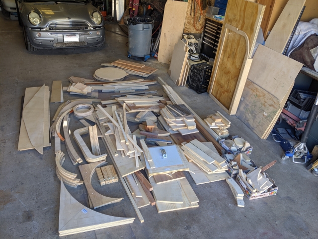

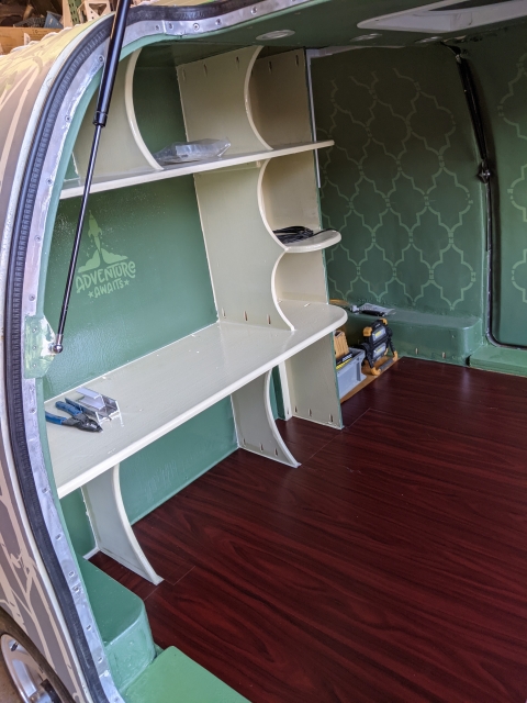

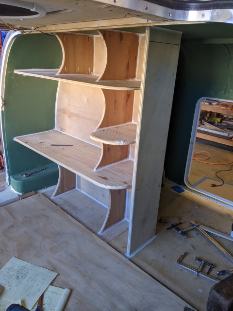

The storage cabinet takes shape. I sized it to fit most of our travel bags and such. A lot of routing and sealing, but it's solid. Most of it is repurposed Ikea furniture.

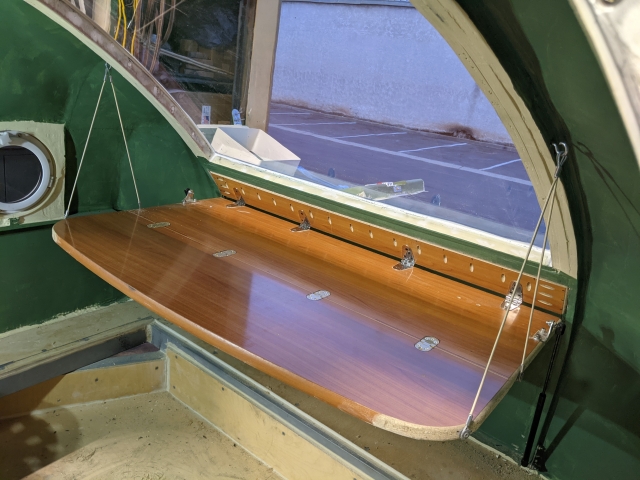

For a front-side flat surface, I repurposed a trusty old office desk top into a folding table. It can be used either at half-size or fully extended. Here it is fully folded away.
And fully extended. I wouldn't sit on it, but it's sturdy enough for anything we carry in there. I left it unpainted for now, it'll become a project for later, as I've been enthralled by acrylic pour projects.
The recessed butler folding hinges are Amazon item# B07PLSLWT4.

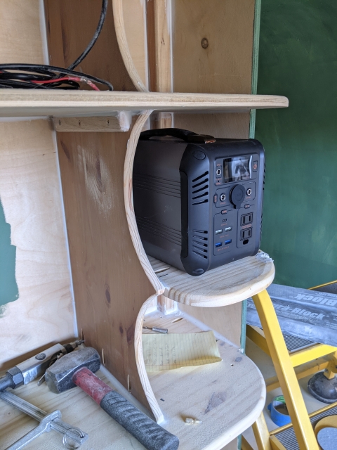

And the power supply - a Lithium-iron (Bibene 500W Portable Power Station CN505) unit that'll suit my power needs for 3-5 days off grid with a couple of sunny days when coupled to the 100W solar panel. I didn't want the weight of a full deep cycle AGM unit, nor the fire potential of a lithium-ion unit. Price/watt it was the right fit...for now.

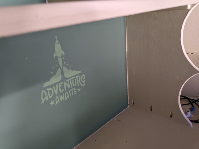

Did I mention I went a bit overboard with the Etsy stencils...
No, I mean it...

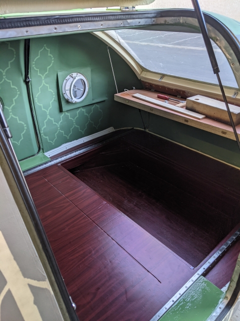

And the floor - I sanded the birch smooth (180-220), then cleaned it, epoxied the full surface, sanded that smooth, then covered it in mahogany vinyl...too bad almost none is visible under the bedding.
Vinyl is Amazon item# B08233XYMJ
More interior paint
And the front. Table is half-size folded.
One of the long-term goals is to have a composting toilet in the back area, sealed. To combat claustrophobia, I put in a spy window in the back wall.

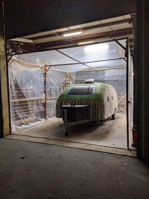

Almost there...clearcoat time.
For once when spraying, I got the orange-peel just right.
Very happy with the dull shine. We'll see how it lasts.
